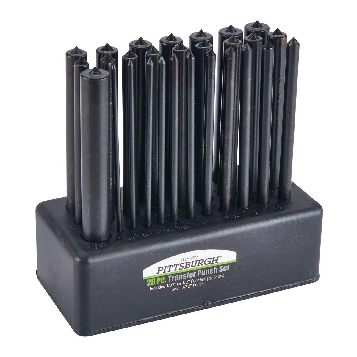

I use a punch set to drive out the pieces. Holding the blank in my hand so as not to damage it and hitting the punch with a hammer. It takes 5 or 10 minutes to drive out the piece but it is still usable and can be re-assembled. I have never tried it but perhaps a drill bit or metal rod close to the inside diameter of the tube??

Now first you did not tell us what kit it is. Next is did the coupler have a black plastic end on it? A photo would help. But many times the answer is always a transfer punch set will get out most components. Takes some care. Work over a soft landing spot such as a carpeted area or a table where the pieces will not roll off and also land with out scratching. Do a few of these repairs and you learn how much to hit hammer and when to just about stop and be able to pull the piece out before it falls. Do not ask how I know this. (embarrassing) Make sure the punch you use fits almost exactly in the tube. Less play the better. There usually one in the set that is perfect for all tubes we use.
When you do get it out, now that side of the tube has been stretched somewhat so when you go to install the correct part you may have to use a little red locktite to hold the piece in for it maybe a loose fit. Please do not use CA. It will cause havoc on the coating of the parts and could get very messy if you get on the blank. Red locktite will wipe clean. While picking up a transfer punch set if you do not have one get some red locktite. Good luck and let us know how it went.

I have a PSI Assembly/Disassembly Pen Press that I have used on occasion for disassembly, but more often than not, I go the route of using a Pen Disassembly Punch Set like many have already commented about before me. They are usually paired with a Locking Soft-Grip Pliers for Pen Disassembly, however I prefer the Soft Jaw Barrel Gripper over the pliers. I like that the gripper provides more surface area for gripping the blank than the pliers so I am less likely to damage my blank by crushing down too hard on it. Although, I occasionally clamp the gripper in a vise rather than holding it in my hand. I have also switched to a hard plastic non-marring mallet rather than a hammer for hitting the punch as the mallet is less likely to mushroom out the end of the punch.
SAME!
John; Yep! One note; Put the locktite on the inside of the tube, NOT on the fitting. This reduces the amount of squeeze out and the result is permanent. Push together with a twisting motion to spread the locktite.
I also picked up the PSI pen press. I have needed punches from my transfer punch set for a good fit. I have not tried red Loctite, I used a tiny drop of medium CA applied with a toothpick and was very careful.
