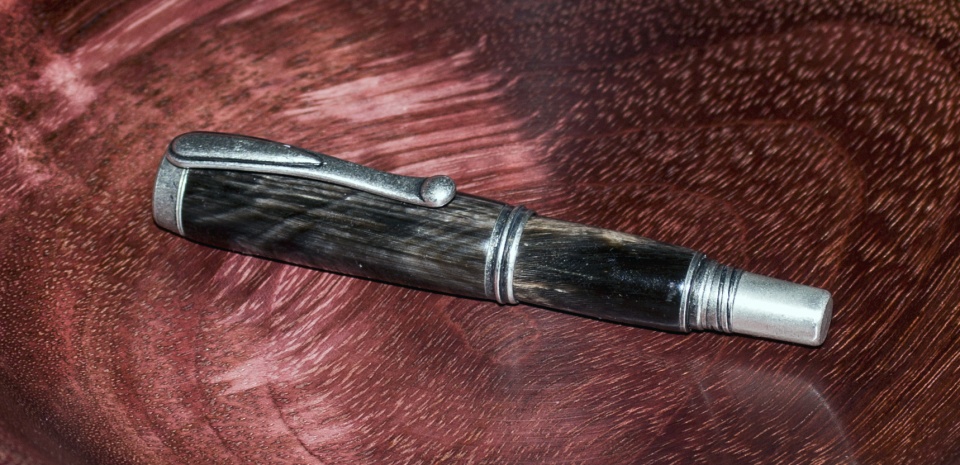

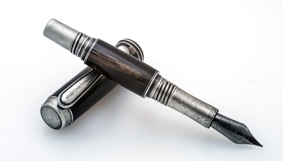

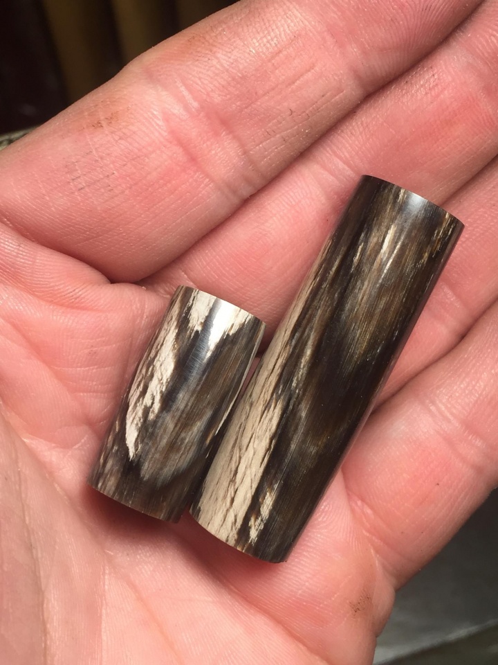

This is still an ongoing work in progress.
continued from www.penturners.org/forum/f56/buffalo-horn-117516/

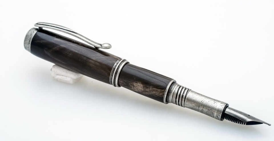

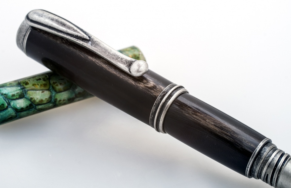

In this thread I will be showing off THREE pens.
Pen 'A' and 'B' was sent as a gift to professionals for their work and dedication in making the panda pen kit possible as well as other kits, i.e. george.
Pen 'C' is kept by myself. I not only like the look but it will be used as a control piece for a long term experiment. As many of you are well aware many here claim negative things when it comes to buffalo horn. Many here also refuse to use it for what I feel is bad exposure and bad experience and failure to adapt skill methodology to suit the material at hand. Enough about that however.

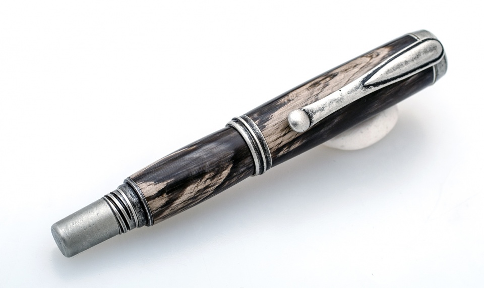

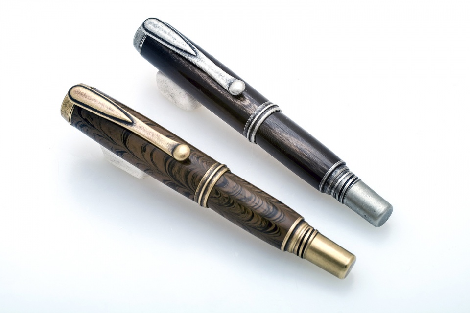

Pen 'A' was sent to Roy at Classic Nib
attachment.php
attachment.php
attachment.php

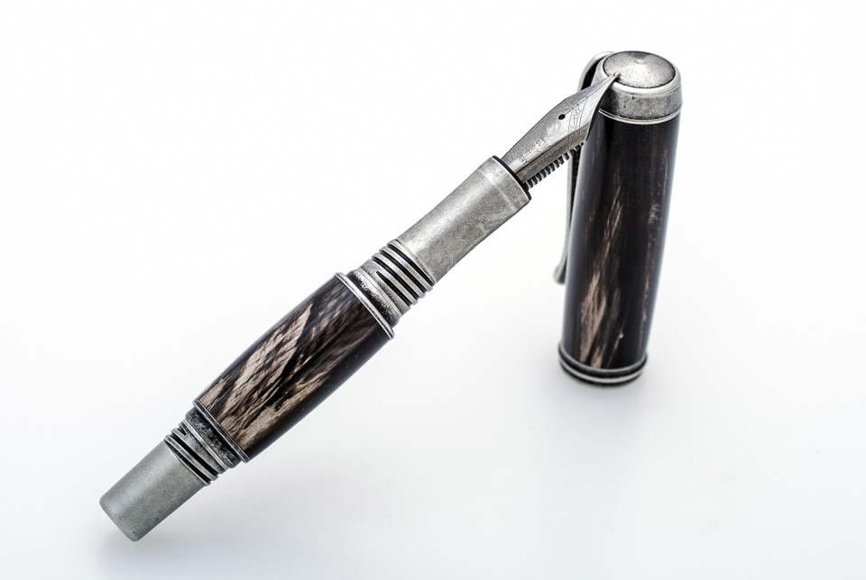

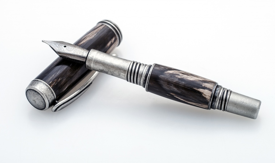

Pen 'B' was sent to Jon David Jones at Signature Pen Supply
attachment.php
attachment.php
attachment.php
attachment.php

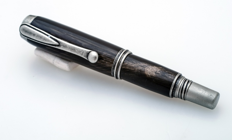

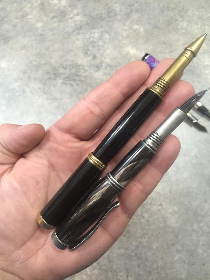

Note here to the length. This is a short george. It *IS* a Gent Jr. Here it is next to my delicious beloved, a vintage Parker Duofold lucky curve, circa 1934.
attachment.php

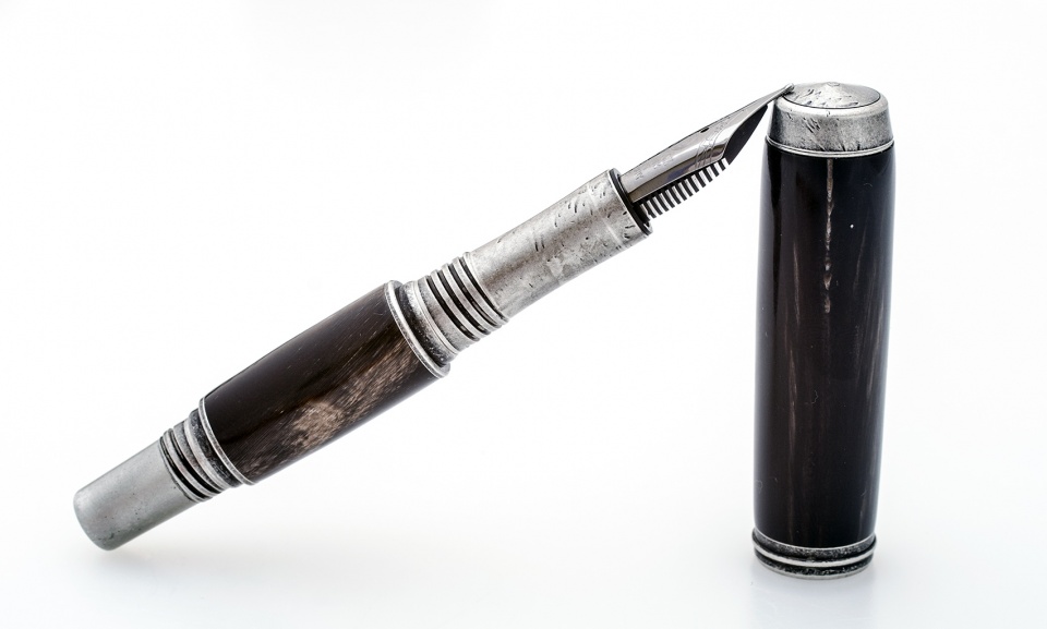

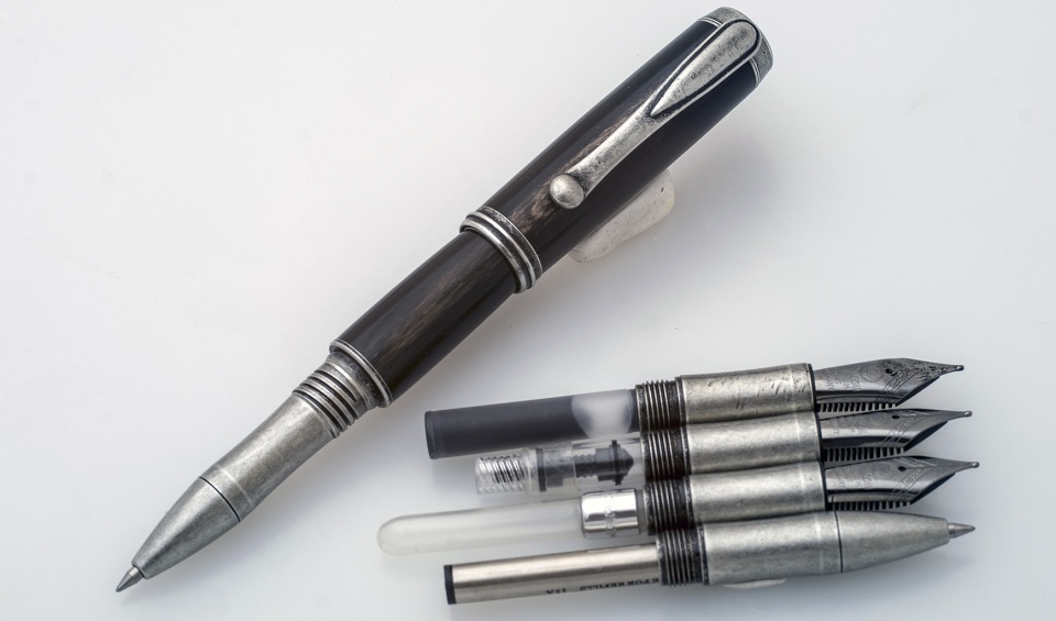

Pen 'C' is my control test unit.
attachment.php
attachment.php
attachment.php
Many have ask why so short. The answer is very simple, because I can.
The next question is often what does it use? The answer to this is this one is setup to use a rollerball and a fountain pen.
attachment.php

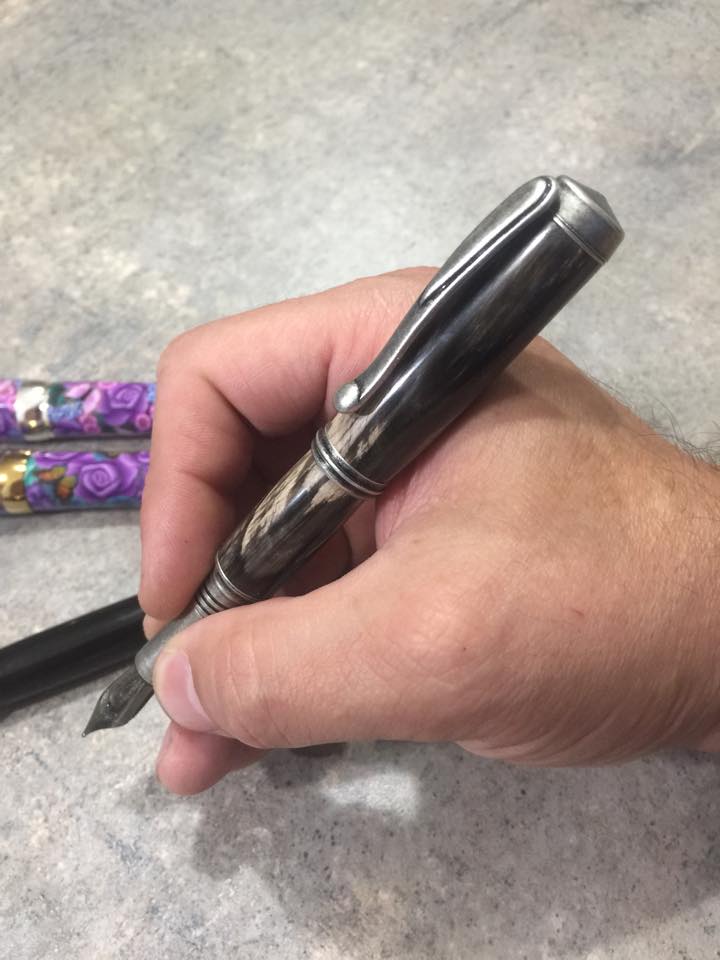

Weight balance ratio is pretty spot on, 20.5g in the cap and lower.
standard length vs shorty length.
attachment.php

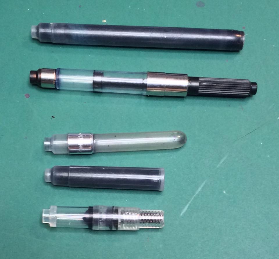

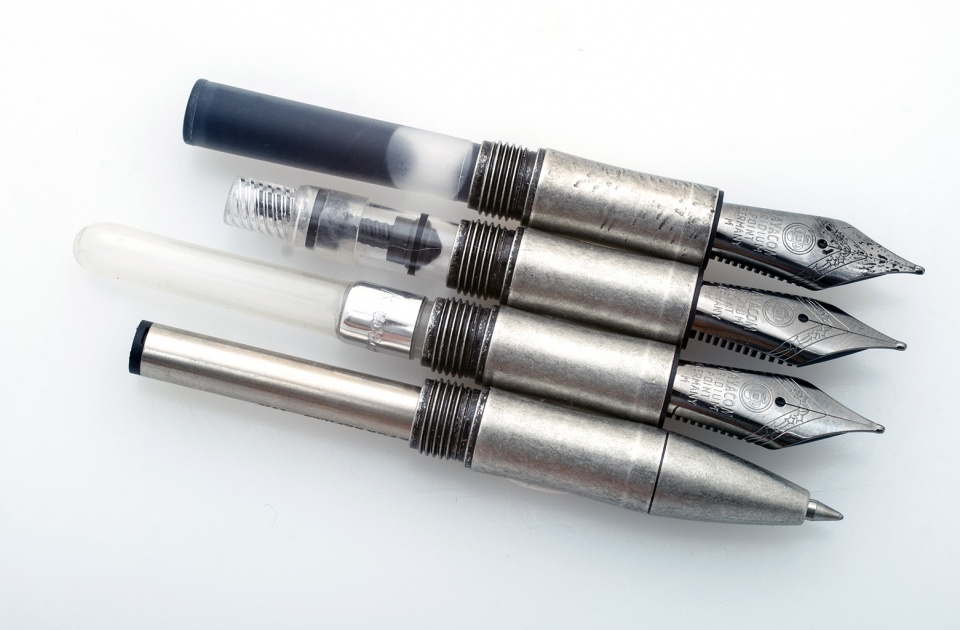

Refill cartridges for the fountain pen side. Photo courtesy Mike and Linda Kennedy from Indy Pen Dance.
attachment.php
Here we see the standard long international cartridge size on the top, below that is the short cartridges and converters available.
attachment.php

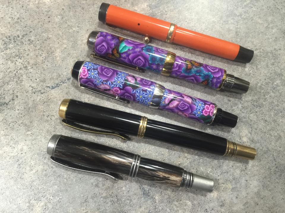

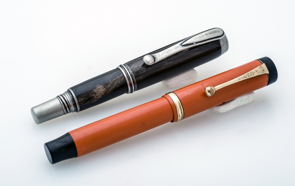

Here we see the following:
My Parker Duofold lucky curve on top (in reddish / orange ebonite),
Dayacom little Havana dressed in a Toni Ransfield set,
Berea El Toro (knock off clone of the Havana) also dressed up in a Toni Ransfield set,
Standard length gent Jr (george in black NIKKO japanese ebonite),
The short George in buffalo horn in antique silver with a #6 nib.
Also worth mention ;)

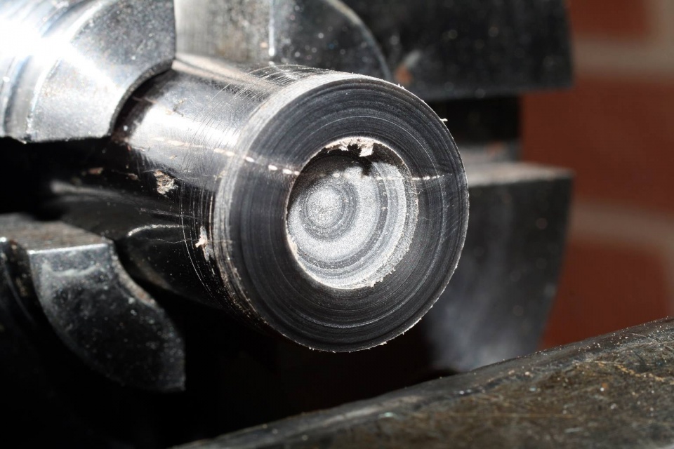

Ed, good luck. Cracking on hair horn, as Buffalo horn is keratin, the same substance as hair and nails will cause them to crack, as with things like snakewood, gator bone and others not all will but they are prone to crack.
Crack!!!!!!!!!!!!!!!!!!!!!

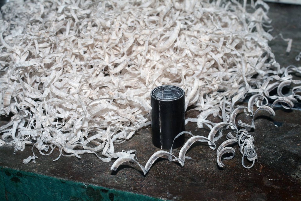

As previously stated I used adaptive techniques to ensure there was *NO* heat generated during production, this includes drilling. In fact while drilling I would put the drill bit end to my bare hand to ensure no heat was produced. Never once was I burned.

I used my shop vac attachment to the lathe and my p100 respirator. There's nothing in the area from the horn however .... there is loads of purpleheart shavings all over the shop. Looks like I murdered someone in there.
Mmmm ... that reminds me ... I have cow horn shavings all over my living room now ... I need to get my vacuum cleaner out.
Oh yeah .. it surprised the heck outta me ... I didn't know cow horns were black underneath! :)

These are short cartridge setups that are usable. Note the bottom one is indeed a rollerball.

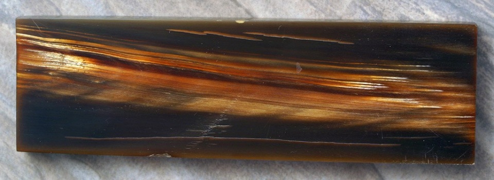

I find the horn material very attractive, especially the pieces with the most color variation. I would be interested to know the techniques you have developed to keep it cool (although I would imagine that the drills must be sharp, and copious amounts of water or lubrication must have been used along with a patient, unrushed operator). I keep being drawn to horn but haven't tried it yet due to all the stories I've heard about cracking.
Can you recommend a good vendor for the high quality material you use?
I have to admit that I don't really get the stubby form factor, there are bottoms for every seat I guess, but it does make an interesting conversation piece. Even if some of that conversation is impassioned one way or the other!
Just to set the record straight, I think the "shorty" fountain pen has a place and I was the one that had encouraged Ed to go with the idea. With today's front pockets on men's shirts being somewhat shorter these would fit without pulling on the pocket also fit in a woman's pocketbook and checkbook holder, we also have found a roller ball refill that would work in these. I do think the pump has applications for those that want colors that are not available in cartridges and it will have it's limitations as far as amount of ink it holds, but the squeeze pump will hold as much ink as a normal universal converter that most vendors sell and I do believe that universal converters write more then ten words and universal converters do fit these.
The one Ed sent me has already been claimed, as has been said by others, well done sir..
The OP is sharing high quality pictures of his pens/components/tools; I don't understand this hostile banter beyond using the forum for as one's personal school yard to settle old grudges. Isn't that what PMs and hate mail are for (half-kidding)?
Imagine being new to the IAP forum (and not knowing the big hearts and expertise of its members and founders), I would be freighted to post anything and I consider myself relatively thick-skinned.
Ed S...thanks for the detailed pics.
This is my one and only post on this matter.
Horn can be VERY attractive.

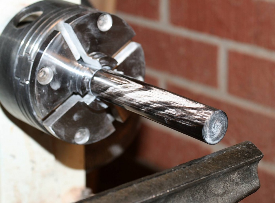

The biggest technique I employ is patients. Work with the material and not against it. That means longer than 10 minutes is required. I know many may have problems spending more than that amount of time on a pen due to ADD/ADHD/OCD or whatever other medical/mental problems they have and that's fine.
When drilling I suggest using fluid of some form to eliminate/reduce/transfer heat. Even WD-40 makes a good candidate. Start small and work up to the final size. For example drill both top and bottom with 6mm or 7mm ish, then drill both with a 31/64" then drill the top with the 1/2" or whatever size bit you need. Progressing in small stages and cleaning the bit in between works wonders. I keep a towel lubed up and wipe it down after each pass. When you move up in drill bit size you are cutting LESS material but you are in fact reaming the hole larger. The tip of the drill bit is very critical in this procedure.
Glue you want something flexible so if the material does move it can shift with it and not crack.
As for sources. All I can say is keep looking, shop around and you will find some you like and size right eventually. Many of the knife outlet shops stock exotic items like this to and that is a very good source to use.
As for the short/stubby, some have said they dont like it, others said they do. That is personal preference.

It has became my belief that blanks should be flexible. All to often we use brittle substances and they are easy fractured, cracked and damaged by simple drops and the like. The CA finish that I use I can put in my nova chuck after it's done, clamp it down and it will not fracture but mold to the jaws under pressure.
If you have reactive materials or flexible then your glue joint should also employ flexible as well.

The big distinction on these short pens is that they are designed to be written with while posted. A nice compact pen when closed and then a full size pen when posted actually has a strong desirability in the market. Think Kaweco Sport and Liliput, Pilot Petite, and several others.
I personally find the full length version of these Jr. style pens to be much too top heavy if you try to write with them posted like that and always end up just placing the cap to the side during writing.
My only real criticism is that the clip looks too large in this particular set of pens but otherwise I like 'em.

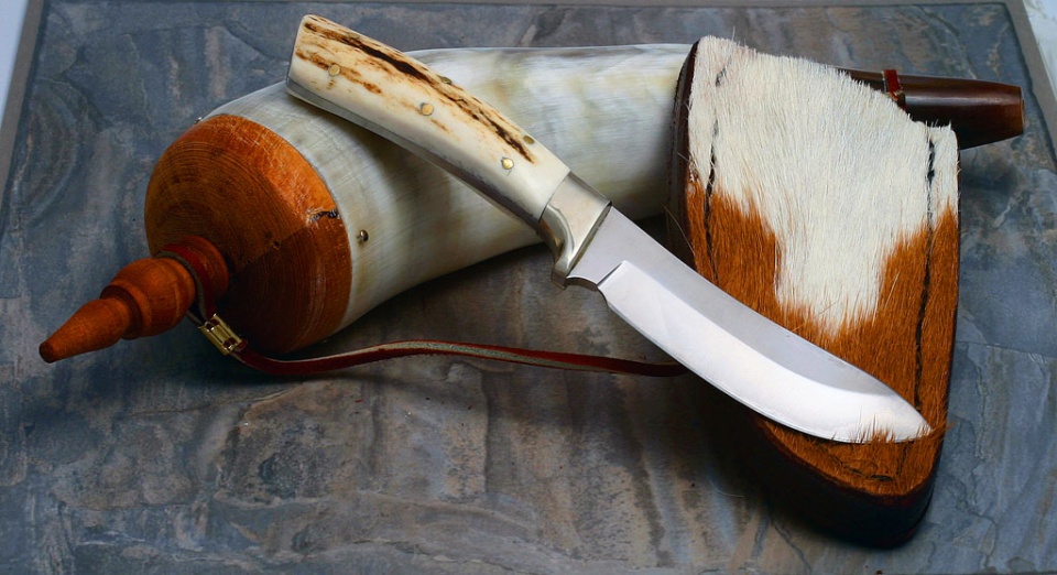

Buffalo horn vs deer antler. I read about drilling BH, understood. What are the main differences/properties if any turning and finishing each?
I haven't had the opportunity to get a hold of buffalo or water buffalo horn yet...
I just got my grubby mitts on some cow horn, and I understand that they are somewhat similar, being modified hairs growing together as one...
Antler is bone ... it's fairly dense stuff, can have a "pith" or a hollow inside where the marrow was, depending on the species. It comes off as little chips and nearly ribbons, when you have it rounded. When working it, you can sometimes smell the marrow and burning bone. Some people find the smell unpleasant. It polishes extremely well, up to a mirror shine. You want to seal the bone, as it will absorb moisture and oils and stain ... it will also yellow over time unless properly sealed.
Horn is, as I mentioned already, modified hairs. It turns like .... well, like fingernails. It is condensed keratin. When rounded, it will come off in stringy ribbons. The color is variegated, like the coloration of the animal's fur, but mostly black and browns, with possibly some tan streaks. When working it, you can smell burning hair or fingernails. Pretty much everybody finds this smell horrible. It finishes very nicely, with a fine glossy surface, but it will eat your sandpaper like nothing you've ever seen. It will also dull your tools much more than antler will. You will want to seal the horn, just like the antler, to keep moisture and oils out, as this material can stain, swell, and crack or just fall apart with age.

Also please take note of the health hazard when working either material.
When turning buffalo horn it honestly seems to be a cross between ebonite and palm. Palm wood you have strands like in buffalo (buffalo is finer) ebonite you have small grain but ebonite has a very close feel.
buffalo also resembles ebonite in it's unfinished state.
attachment.php
Shavings on an earlier test I did some time back.
attachment.php
Note the reamed shavings from going in increments.
Here is a knife block that I have.
attachment.php

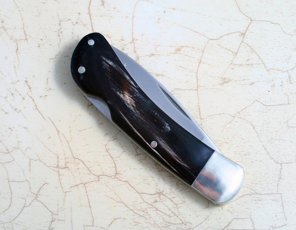

Note the union of teh silver and honey strands and the seemingly crack but some of those are not cracks but in fact silver strands under the surface that is rather translucent.
this is an EDC that I made a good number of years back. To date it has yet to crack.
attachment.php

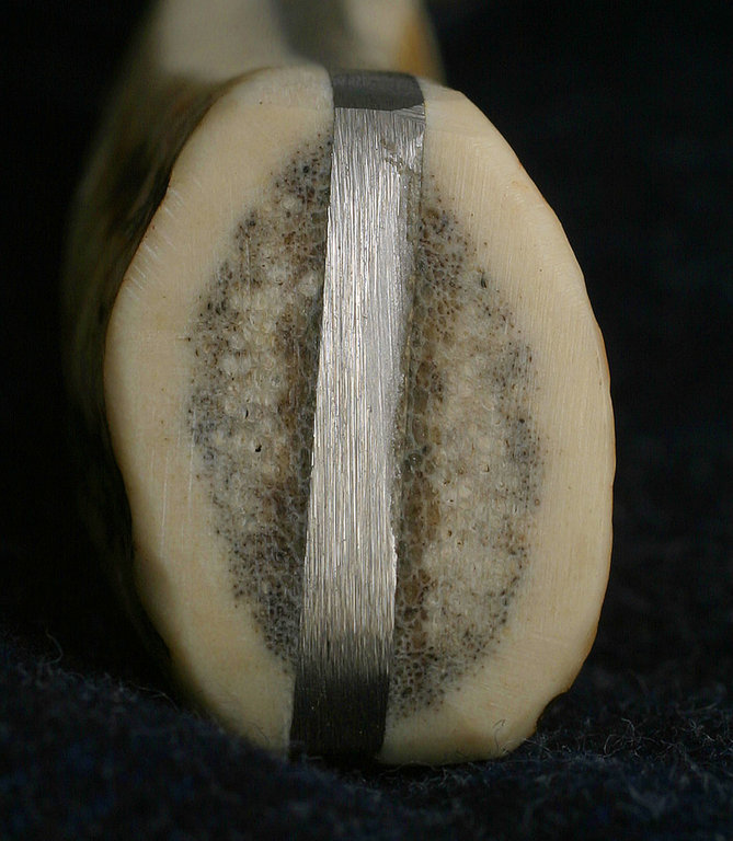

This is end grain on elk antler, called PITH.
attachment.php
Elk antler handle, Elk skin sheath, cow horn powder horn.
attachment.php
