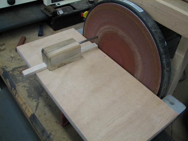

I agree with Rudy, almost. The end of the blank needs to be perfectly square with the TUBE. A sloppy fit on your pen mill OR a pen mill head that's a bit off will screw you up.
I use a pen mill to take off the majority of the wood but I leave the last 1/32" for my blank squaring jig..........
I swear by this little dude. Jay Pickens has a tutorial in the library on how to make something similar.

I use a pen mill, I do not have a bench sander(don't know the real name) anymore so I cannot make a jig like the one above. The largest shaft I have with my mill is 10mm, which is obviously too small for the 10.5 and 12.5mm tubes. How do you guys mill with the shaft being too small?

I make a sleeve out of various tubes. The larges shafft I have is a 7mm. I take 7mm tubes and glue them to a scrap blank. Then I turn it down until it just fits into the larger tube. Then when I need to square the bigger blank, I just put the sleeve on the 7mm shaft and I have a nice square blank. Be sure to cut you sleeve so they are the same length, or just bit shorter than the blank you are squaring.
