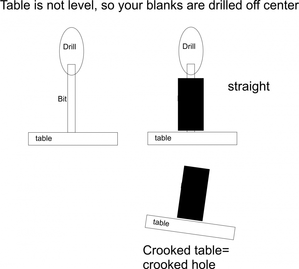

Your problem comes up once in a while, so I have made a couple drawings.

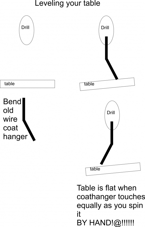

The problem is, nearly always, that your drill press table is NOT perpendicular to your drill bit. In other words, the table is crooked. See drawing one.
attachment.php
To test, make a half a Y as shown, from an old wire coat hanger. Insert the wire into your drill head and turn it BY HAND!! Set it so the wire just touches one point on your table. As you turn the drill head, the wire should touch all the table exactly the same. If it does, your table is FLAT and perpendicular to the drill head. Most likely, your holes will now be straight.
attachment.php
Hope this clears it up!!

I read the OP question and I was going to reply and I what thinking that I needed to first go into my "Paint" program and draw up something, it wasn't going to the the bent wire trick, that I never heard of it before and I reckon is one of the simplest ways to test the drilling system, that I've heard of so, who ever come up with that idea, he/she is a smart "creature"...!:wink::biggrin:
So, reading through and seeing your post and your simple and clear drawings/diagrams, I was happy to give up of any drawings of other ways to do it, and applaud/support, what you gave us, its good enough for me, and should be easy enough to follow, by everyone else...!:biggrin:
Thanks for that...!

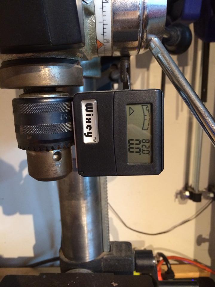

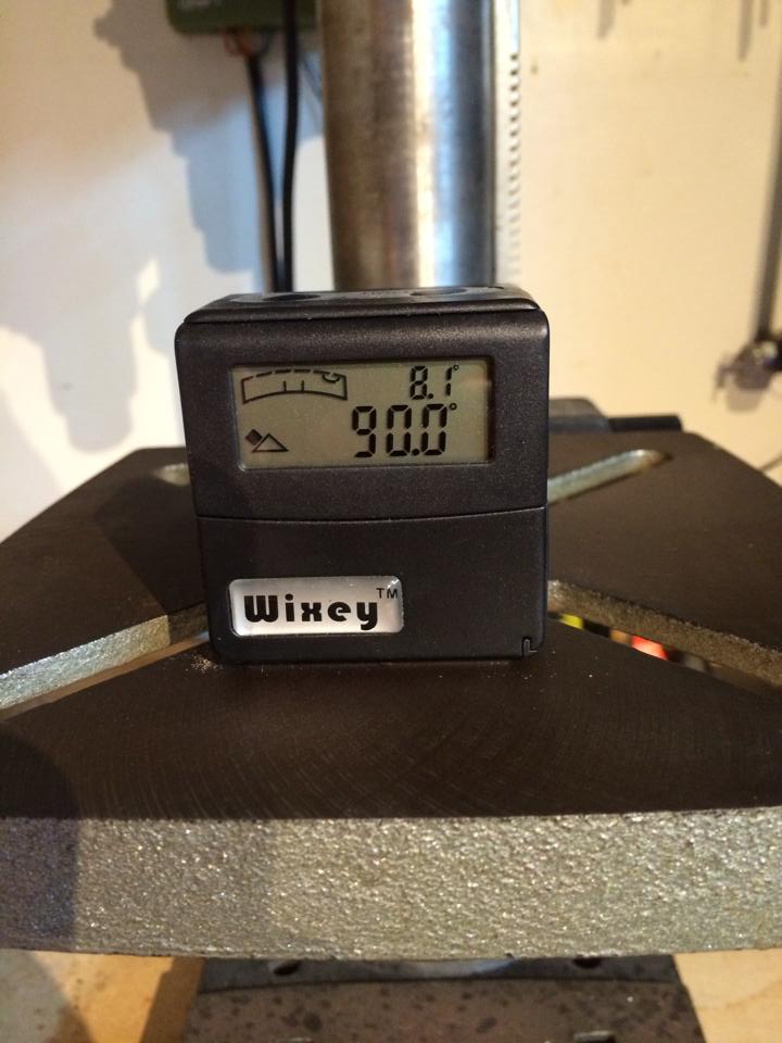

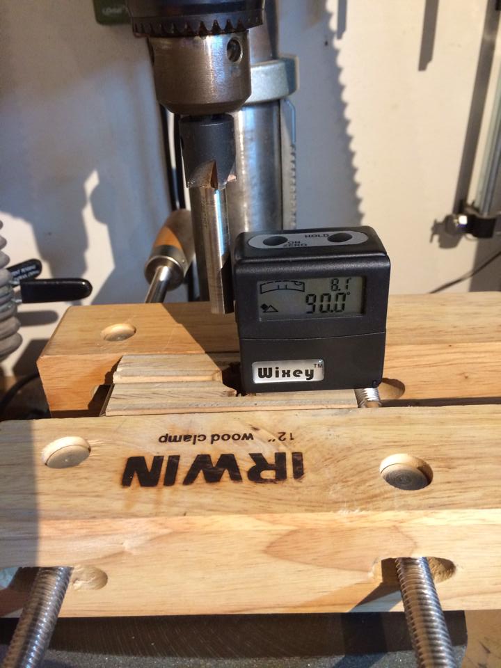

Here's now I set up my drill press - with a Wixey digital gauge that I originally bought for the table saw.
Just stick the gauge on the chuck, zero it, then put it on the table and set the table to 90 degrees.

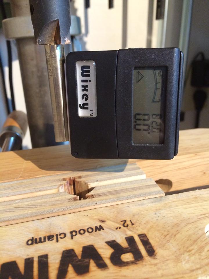

I also have the Nova Pen Plus jaw set for my Nova chuck.

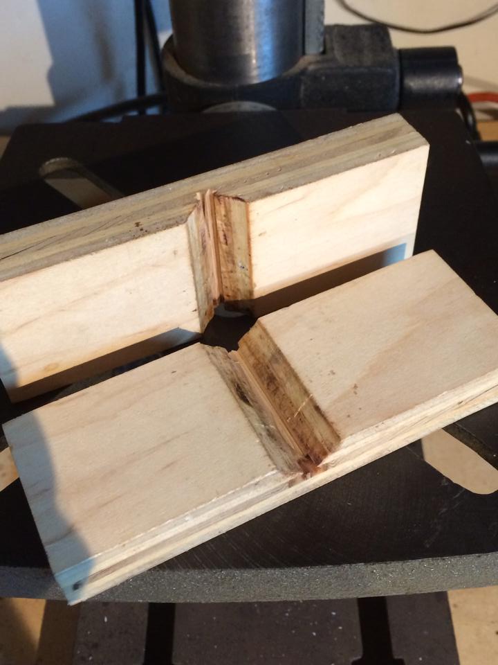

I initially went from using the drill press to the drilling on the lathe but when I need to drill accurately - like when drilling a 3/4" blank for a pen that usually uses a 7/8" blank - I do it on the drill press.
To hold the blanks on the drill press I cut a couple of 45 degree cuts in some scrap on the table saw then cut the scrap into two "jaws" to sit in a clamp.
Since the jaws I made are square and the notches I cut are perpendicular to the sides of the jaws, I know that my blanks should be held (and drilled) as straight as is possible with my little benchtop drill press.

I sandwich my blank holders in a basic wood handscrew clamp.
Since I know my table is perpendicular to my chuck and my slots in the blank holders are perpendicular to the table and parallel to the chuck, I just place the blanks between the blank holders, tighten the handscrew clamp, and drill/ream/trim the blanks.
For me, working like this takes some of the variables out of the picture. As far as I know the only variable left is the blank itself - or the actual table of the drill press flexing - but if that happens I think it's time to sharpen the bits. With the blank holders I made I can drill square, rectangular, and round blanks without issue. I'll see how they fare with horn and antler soon enough. I have yet to work with those materials so it'll be a learning experience.

BTW, the reason you see the 82 and 8 degree readings at the top of the Wixey is because it's showing that my floor is at an 8* slope. Makes toolboxes and everything look weird - especially when you hang pictures and such in the shop.
