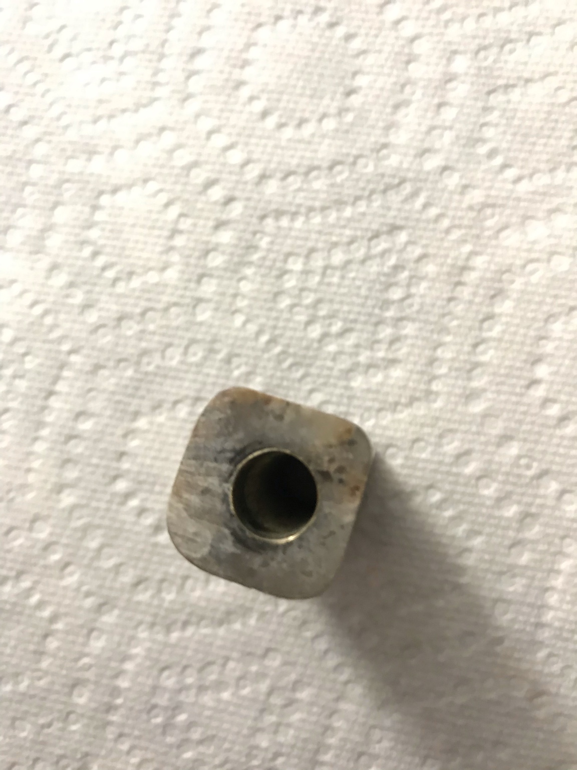

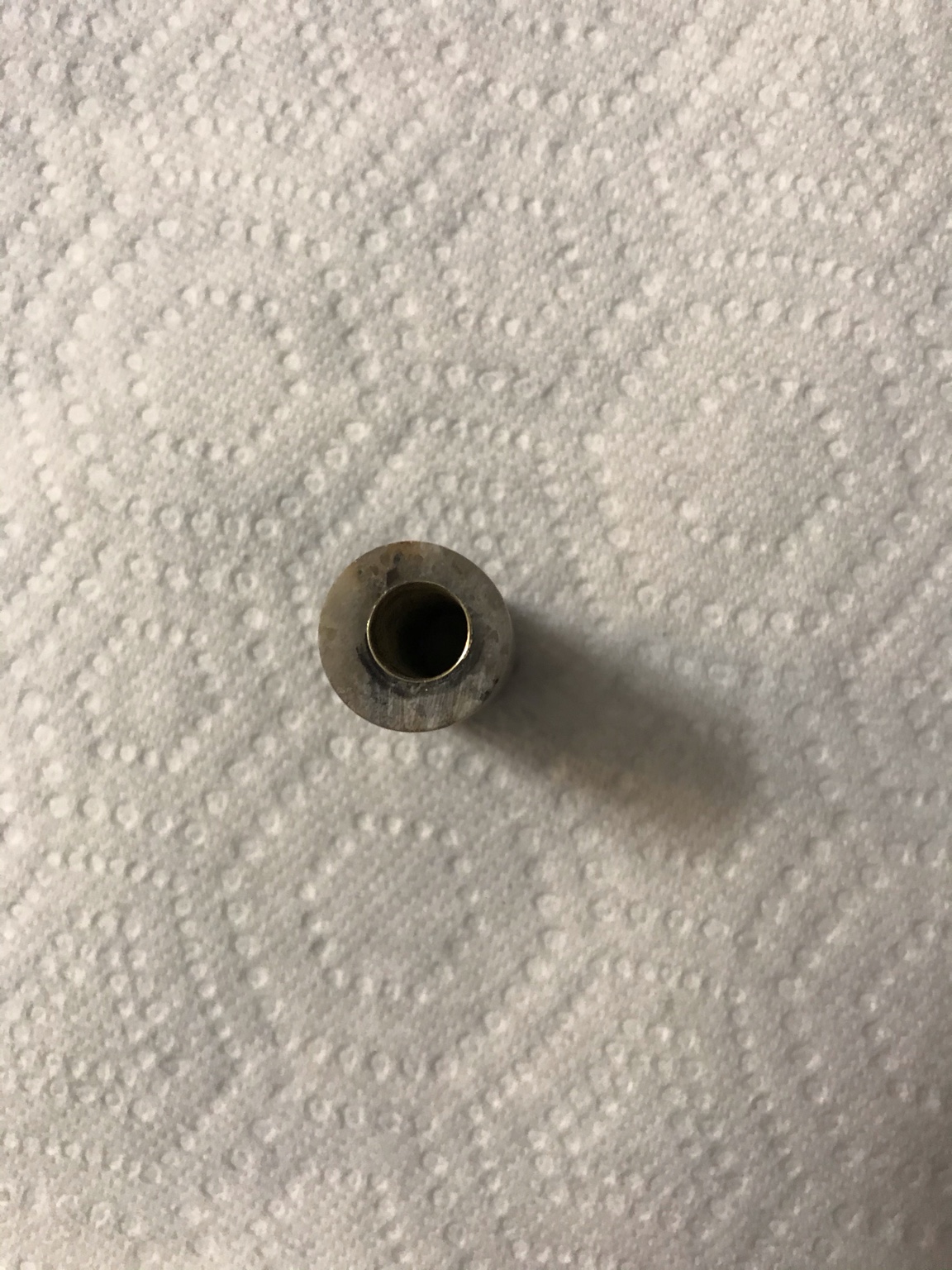

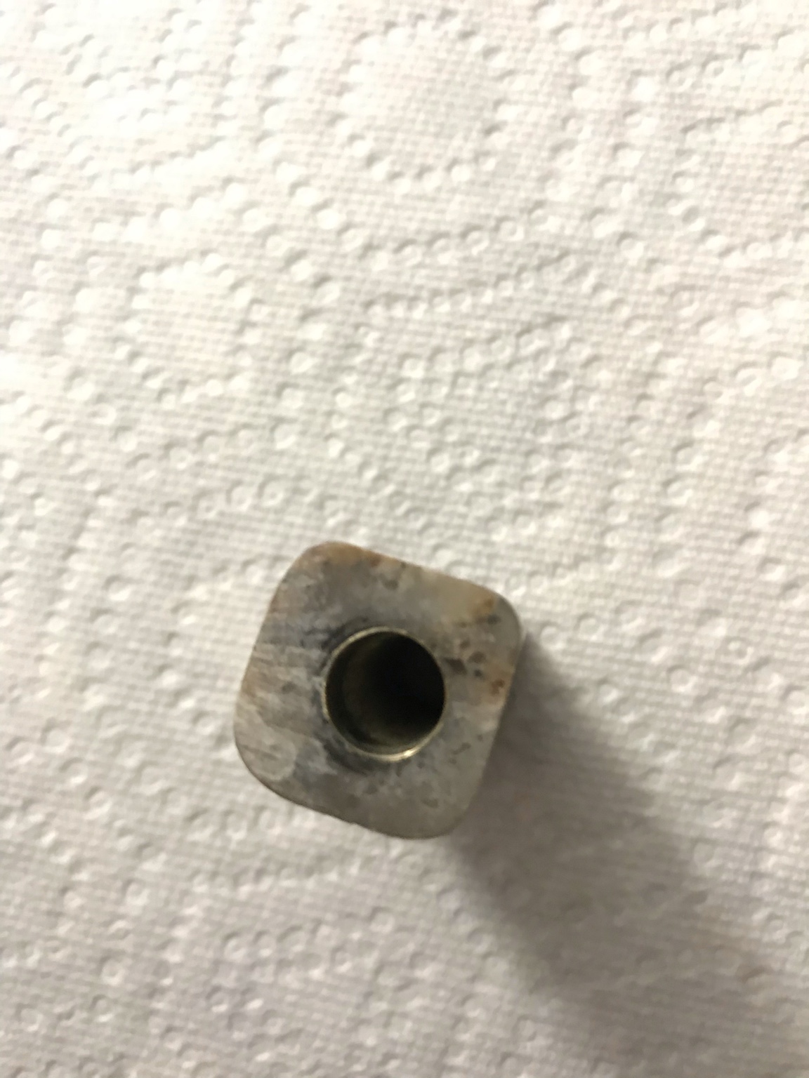

I've had in regard to this hobby, this one has me throwing in the towel, hanging my head in shame and admitting defeat [emoji22] Let me explain. A couple of years ago, we replaced our counter top with a quartz countertop from Cambria. Ever since I've always thought what a beautiful pens could make from that material. So finally my curiosity gave way and I ordered a couple small samples, pretty cheap actually, less than 5 dollars for a 3 x 3 inch sample. I had some cheap masonry drill bits, bought a rather inexpensive diamond blade that would fit my table saw. The quartz countertop is not as some people think a solid piece of quartz but rather crushed and powdered quartz and resin. So down the rabbit hole I went. Cut the samples, which are 3/4 inch thick into 3/4 inch blanks, that part went fine, they cut very easily with the diamond blade. Chucked one up and drilled through with masonry bits. Went okay but very slow, took probably 2 hours to get to the final hole size of 3/8. Glued in a painted tube and glued with epoxy that I added a little black dye to. Next day I squared it with my disc sander, again really slow but got it down. Turning it, now that's a whole nother ballgame. Ruined a carbide cutter in about 30 seconds. So I'm not pursuing this any further. My wife graciously pointed out, it's not a complete failure because otherwise I would have always wondered
if it would work. There may be something out there that would work, but I'm done with this idea. I'll post a couple of pictures. The slight roundness you see on the blank was done on the disc sander. I'm sticking to wood and the occasional acrylic.

I've had in regard to this hobby, this one has me throwing in the towel, hanging my head in shame and admitting defeat [emoji22] Let me explain. A couple of years ago, we replaced our counter top with a quartz countertop from Cambria. Ever since I've always thought what a beautiful pens could make from that material. So finally my curiosity gave way and I ordered a couple small samples, pretty cheap actually, less than 5 dollars for a 3 x 3 inch sample. I had some cheap masonry drill bits, bought a rather inexpensive diamond blade that would fit my table saw. The quartz countertop is not as some people think a solid piece of quartz but rather crushed and powdered quartz and resin. So down the rabbit hole I went. Cut the samples, which are 3/4 inch thick into 3/4 inch blanks, that part went fine, they cut very easily with the diamond blade. Chucked one up and drilled through with masonry bits. Went okay but very slow, took probably 2 hours to get to the final hole size of 3/8. Glued in a painted tube and glued with epoxy that I added a little black dye to. Next day I squared it with my disc sander, again really slow but got it down. Turning it, now that's a whole nother ballgame. Ruined a carbide cutter in about 30 seconds. So I'm not pursuing this any further. My wife graciously pointed out, it's not a complete failure because otherwise I would have always wondered View attachment 246771View attachment 246772if f your choice to the blankoit would work. There may be something out there that would work, but I'm done with this idea. I'll post a couple of pictures. The slight roundness you see on the blank was done on the disc sander. I'm sticking to wood and the occasional acrylic.

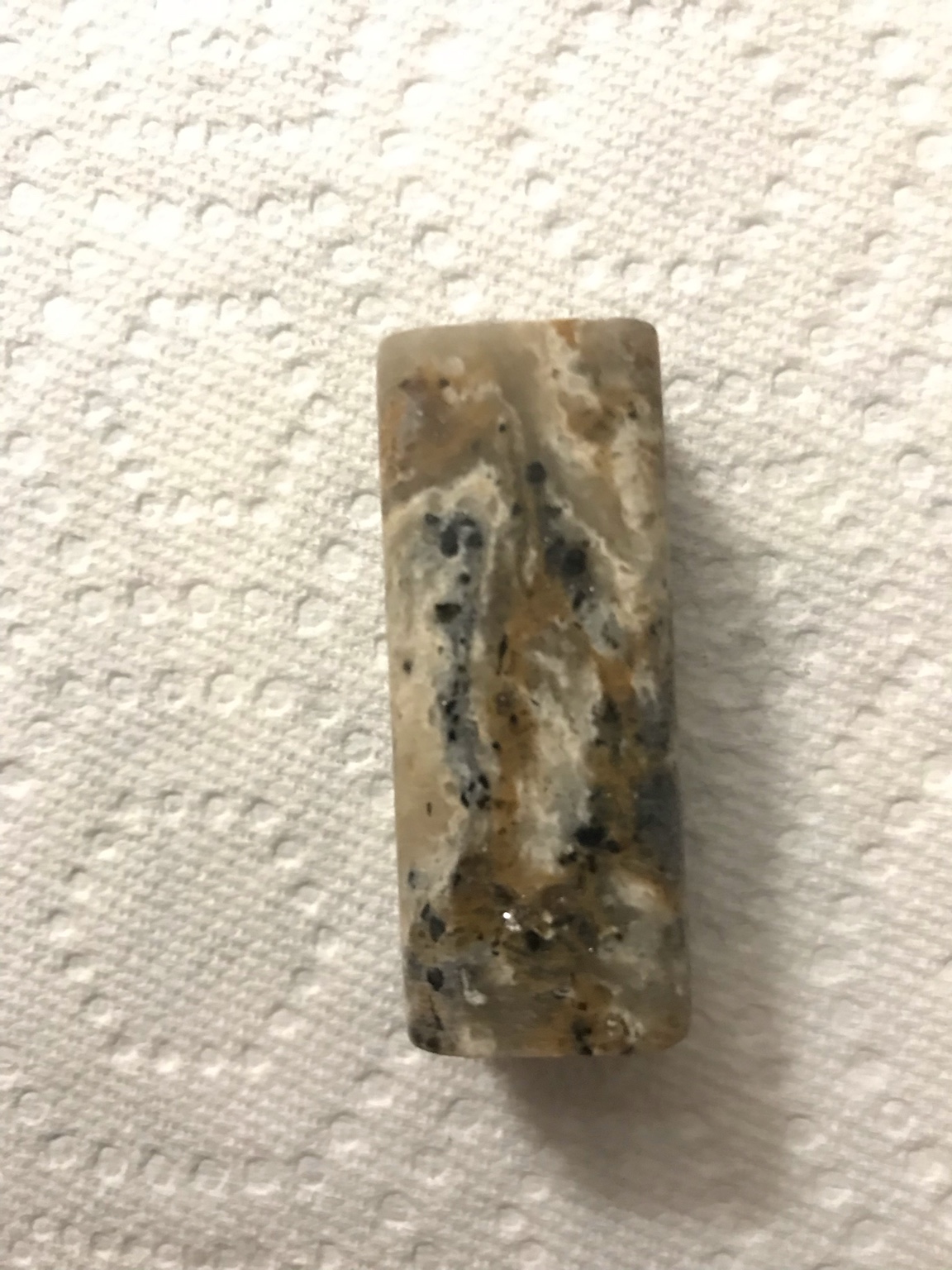

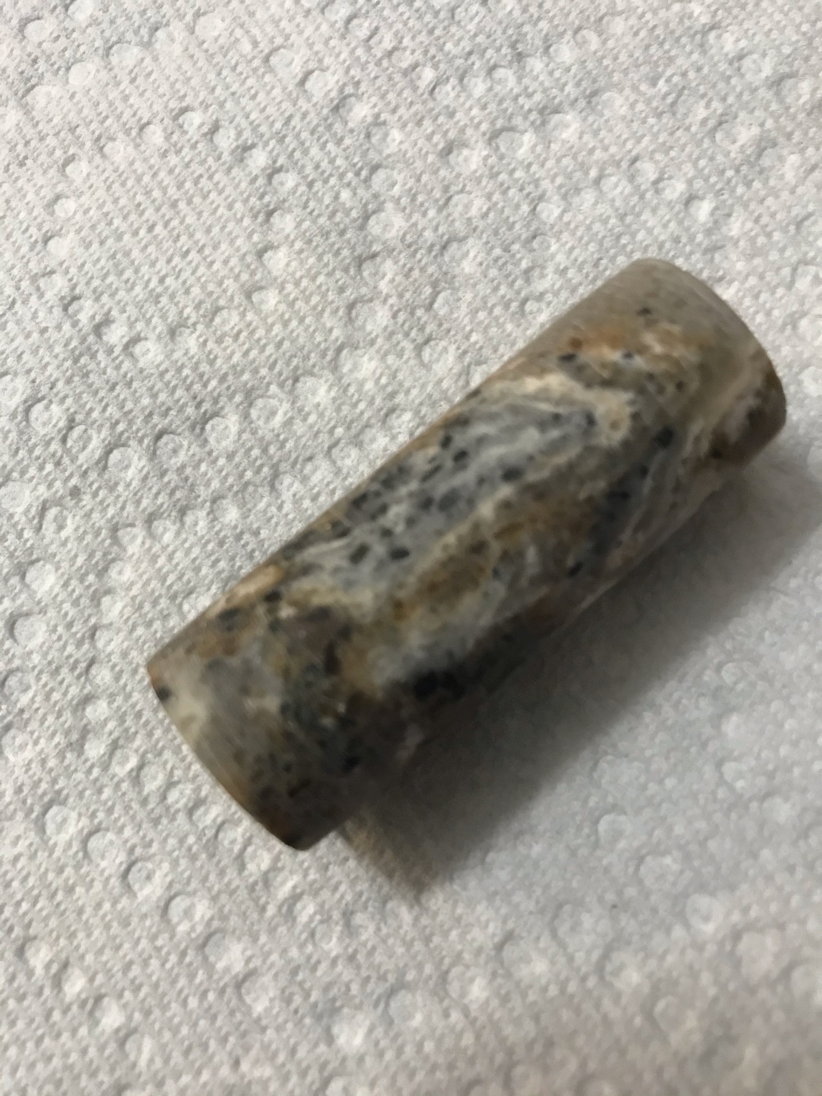

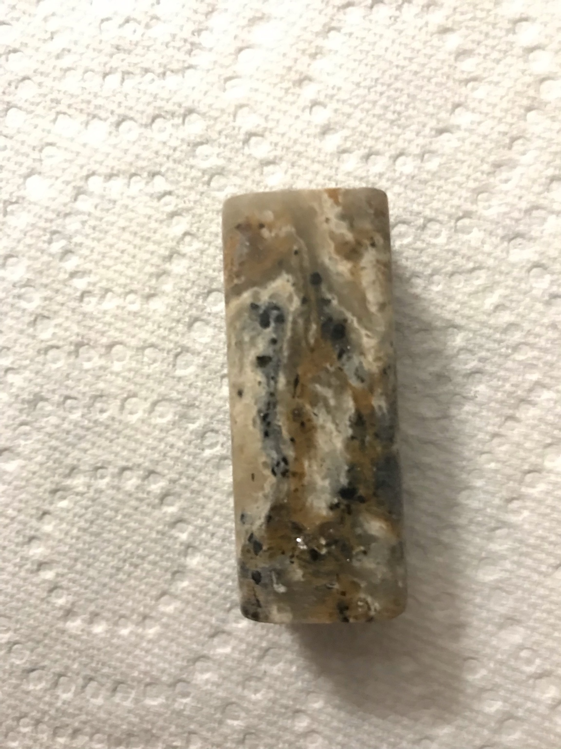

Well I decided to pursue this a little further. I managed to get it round by sanding with 80 grit sandpaper. It's never going to turn out though because the hole was not very straight going through the blank. That wouldn't be a problem in most any other material because the lathe tool would hit the high spots and it would even out, the closer you get to center. That's not the case when you're trying to remove stock with sandpaper. So again, I think I'll quietly put this one to bed or perhaps throw it off a cliff. Here's a couple of pics.
