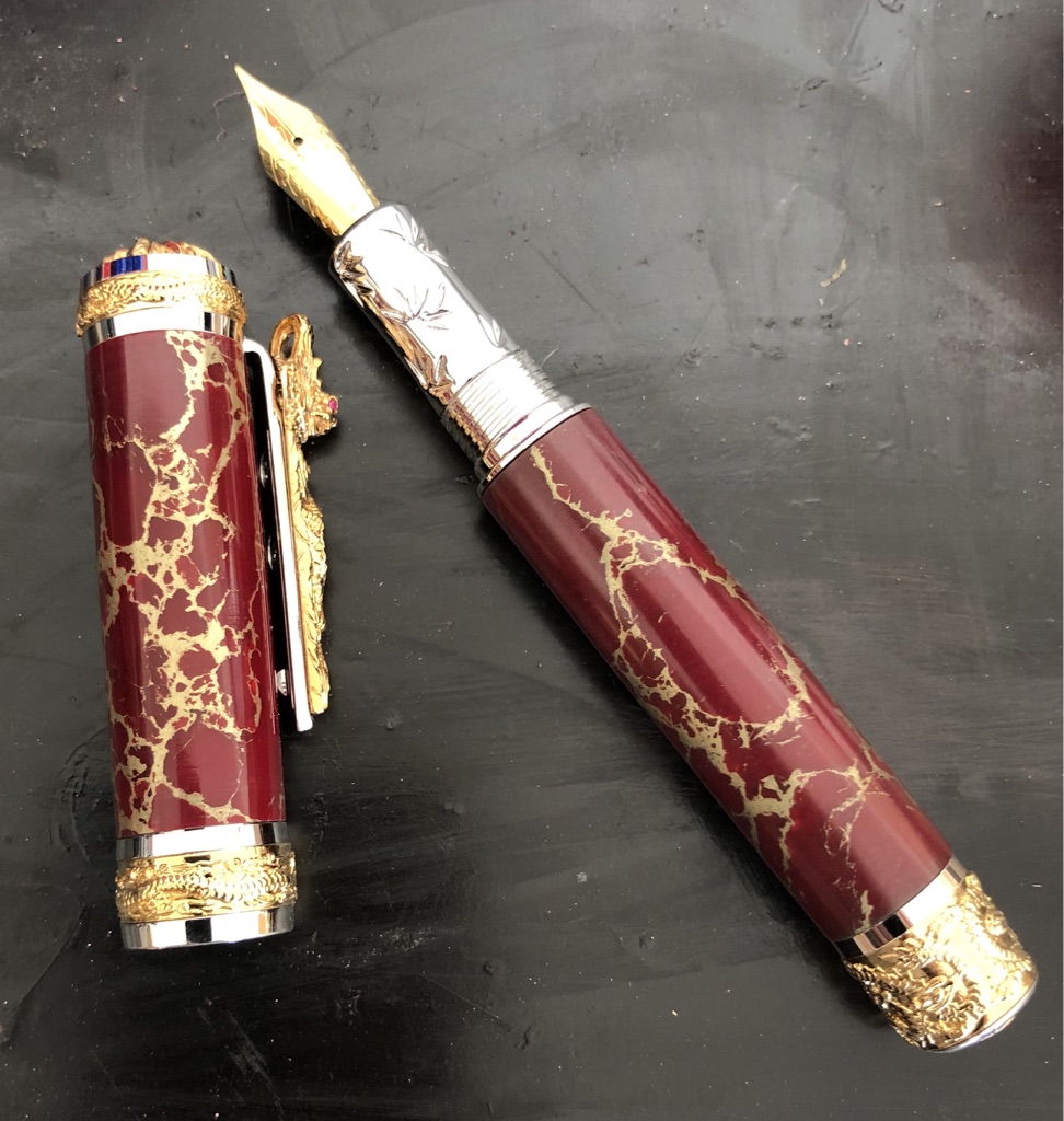

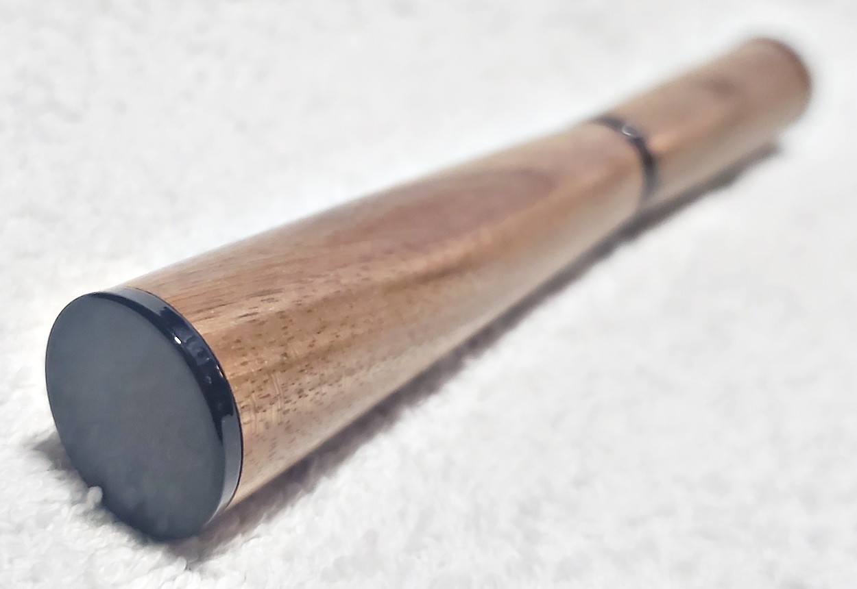

I think combining a heavier blank (most of which have been mentioned above) and a heavier component set will give you the result you are looking for. In addition to the ones Louie mentioned, you might consider the Nouveu Sceptre kit. I made a pen a while back combining those components with a Conway Stewart Coral Green blank (you can find them both through Exoitc Blanks), and the end result was a fairly heavy pen at 65 grams.

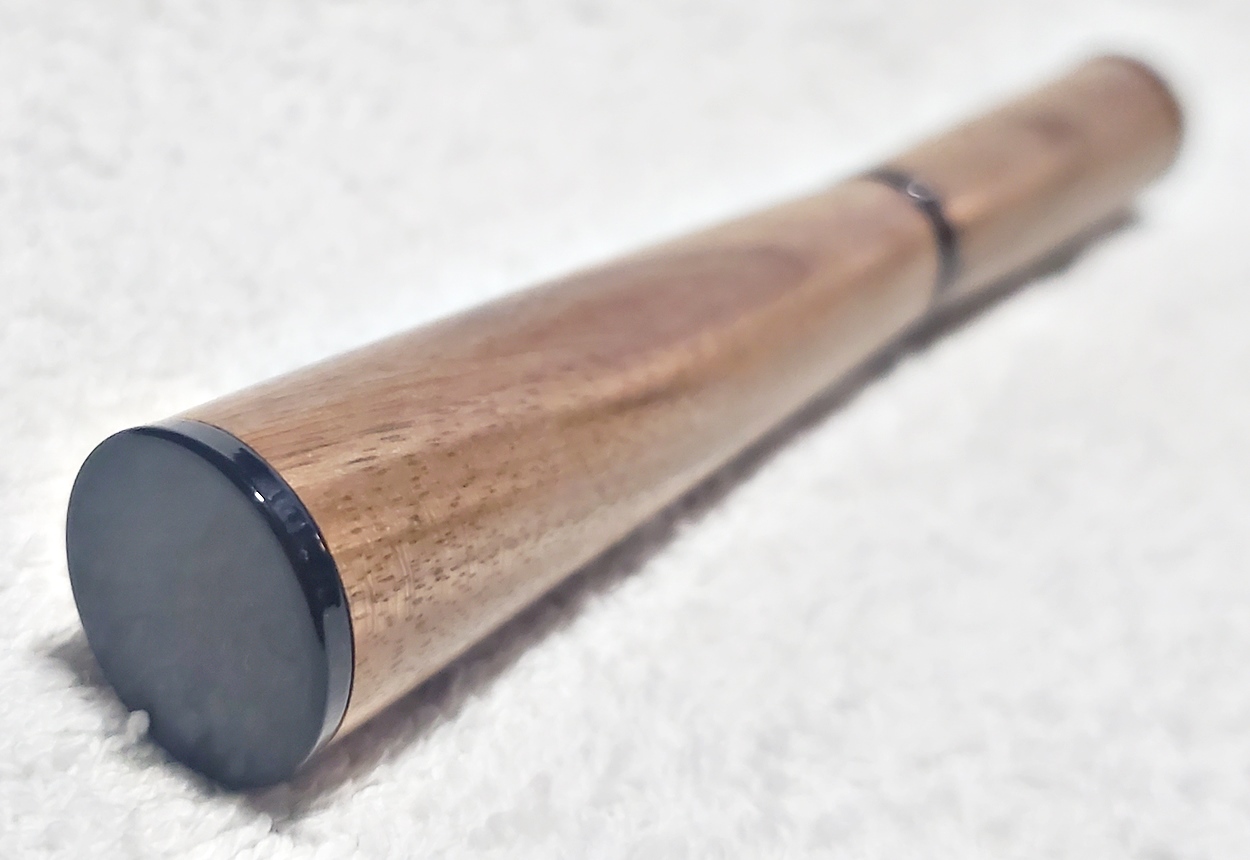

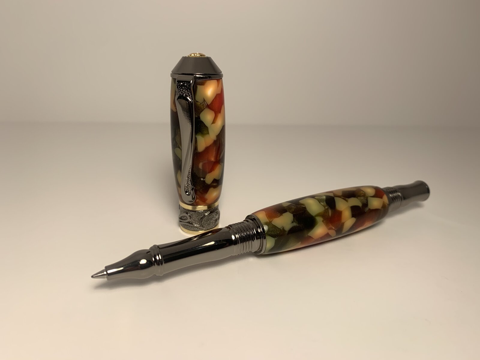

Although I have never built one, the Panache Rollerball looks like it would be a very heavy pen because of the exaggerated diameters on the ends. (One end is 0.67-inches and the other is 0.79-inches) - Dave

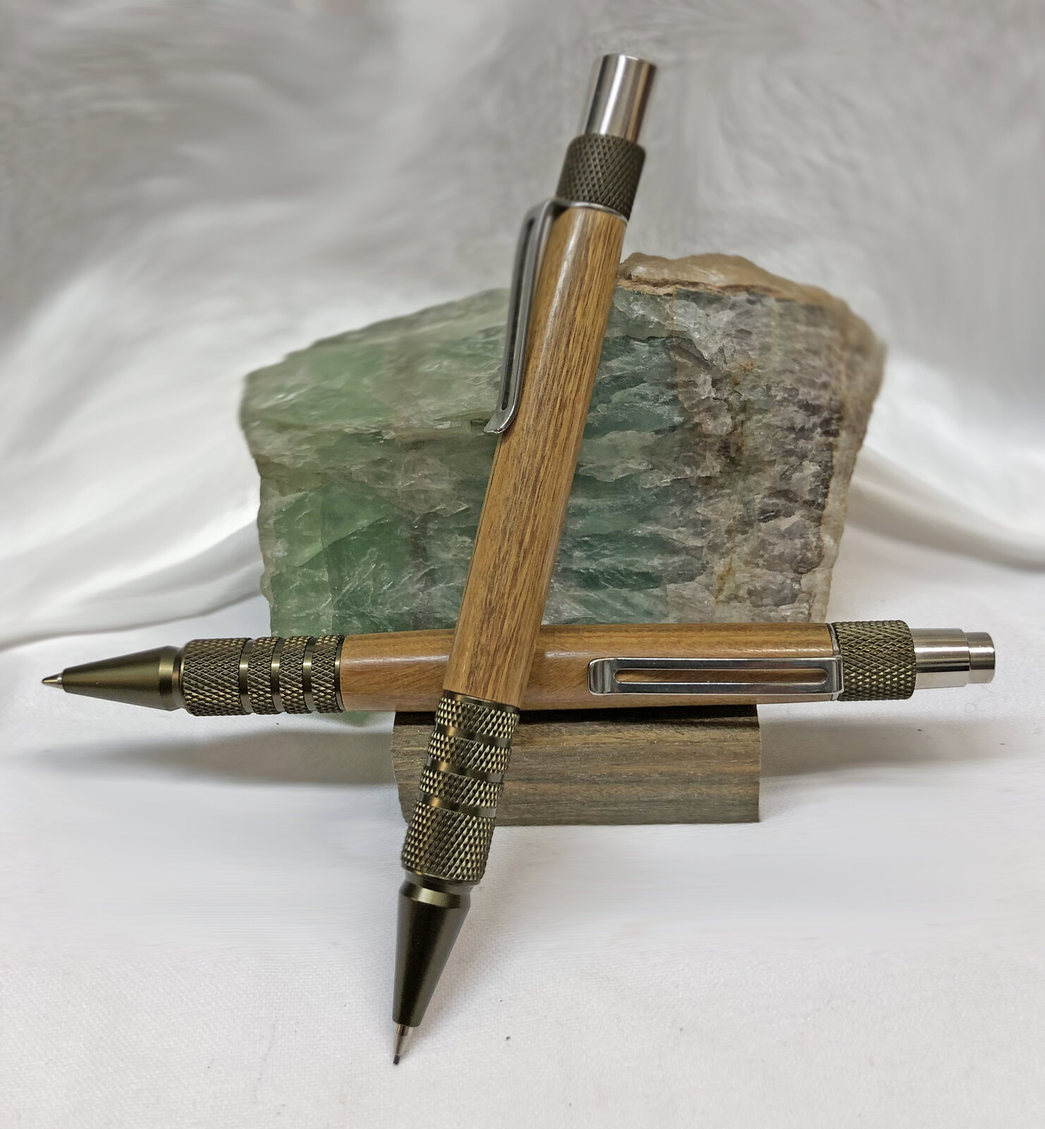

Great recommendation. I used some Lignum Vitae to make a pen and pencil set on DuraClick EDC kits. I didn't recall it being heavy, but I do recall it being extremely hard. As you indicated, mine did have a muddy-greenish tint, but I think it paired ok with the Burnt Bronze plating option. - Dave

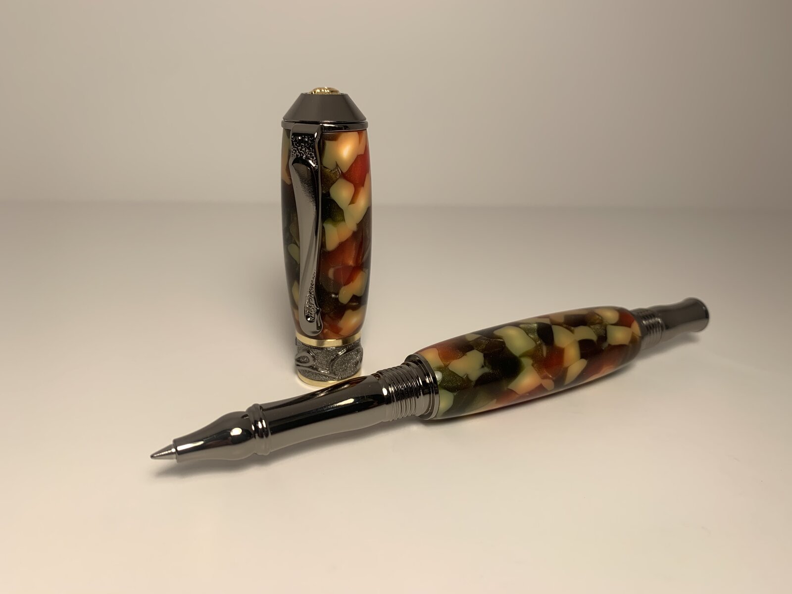

You need to look at kits with a lot of metal and relatively thin tubes and combine it with heavy material. For example, PSI's cast kits (Phoenix, Dragon, newly added Basketball kits, and others with a "sculptured look") are usually much heavier than most rollerball pens and have 9.5mm long tubes with up to 13-14mm outer diameter so the weight of the material actually matters. Brass or copper might be the heaviest materials you can use and you can make them really pretty with some patina - just use a kit with similar color. For patina search youtube, there are a lot of videos showing how to use ammonia, salt, vinegar and mustard to achieve sick results:) Just don't forget CA on top to protect patina.

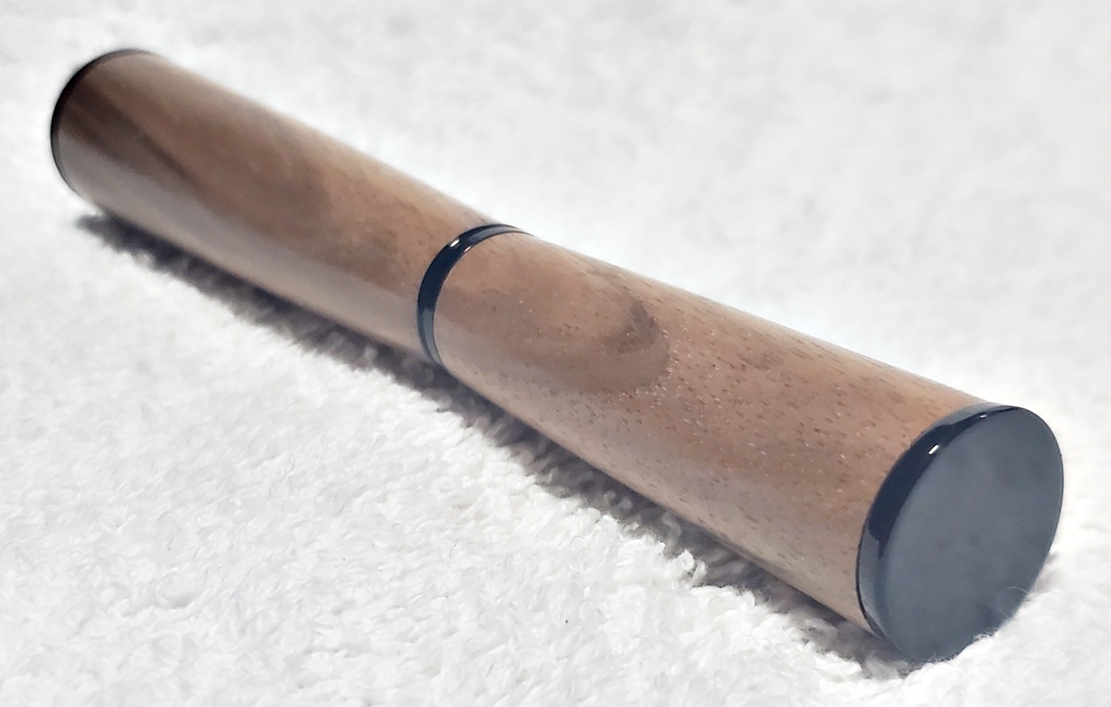

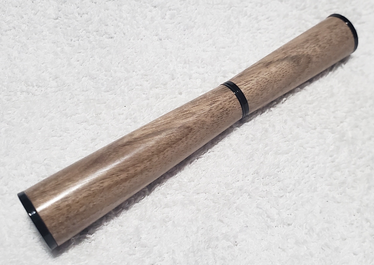

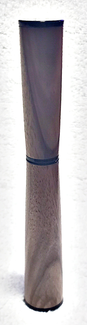

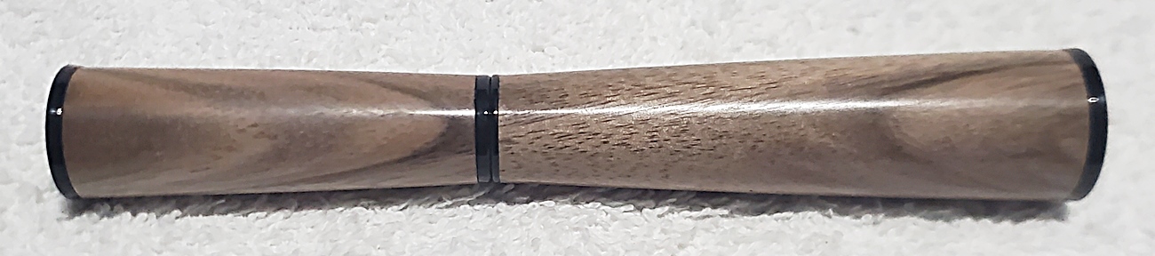

I have made several Panache pens, and in fact, have one on my desk at work. I can weigh it tomorrow.

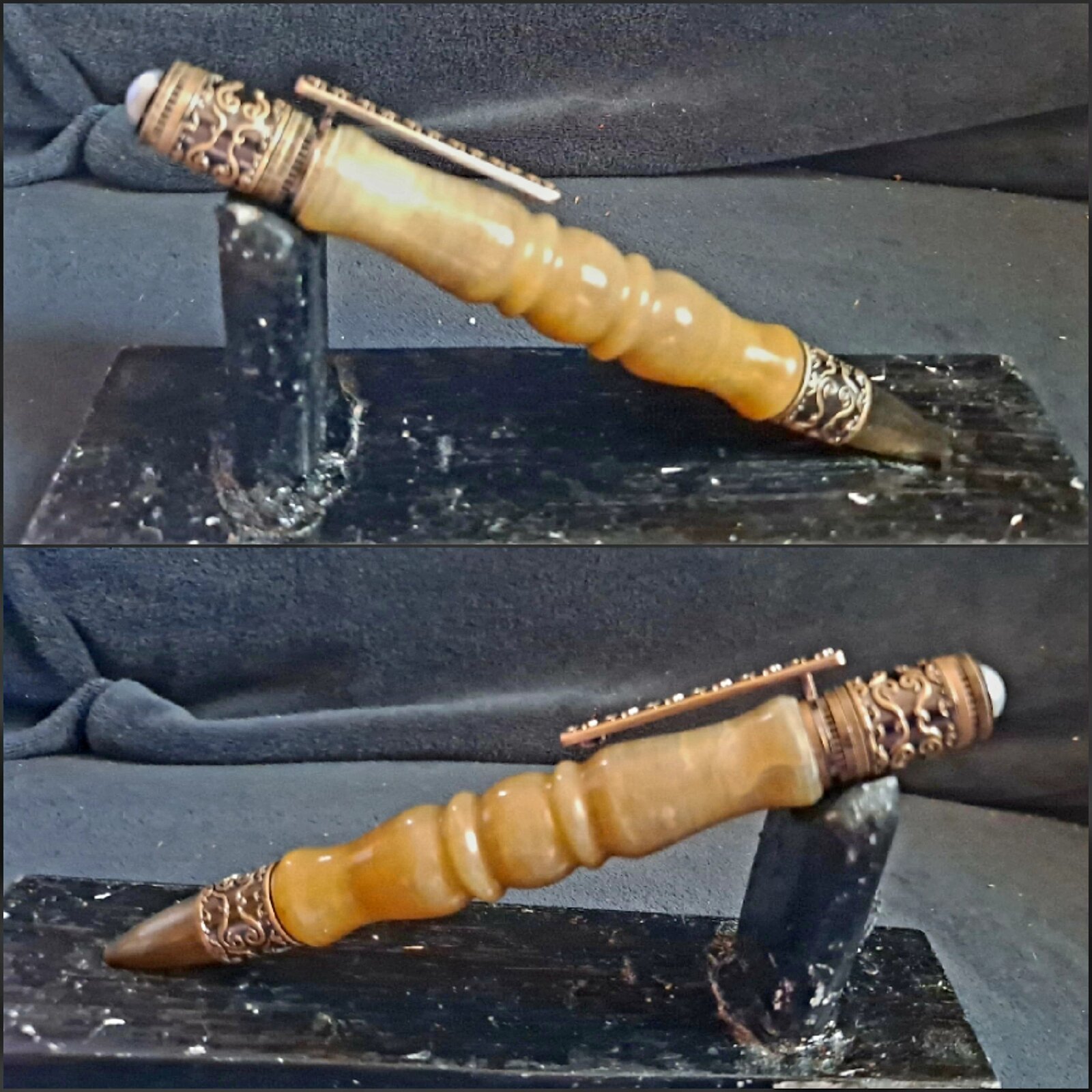

I have the same tremor. I've made a number of heavy pens. Dragon, Phoenix, Steampump and others. I also have used blackwood and ebony and agree with others who suggest that the actual pen provides more weight increase than the decorative material.

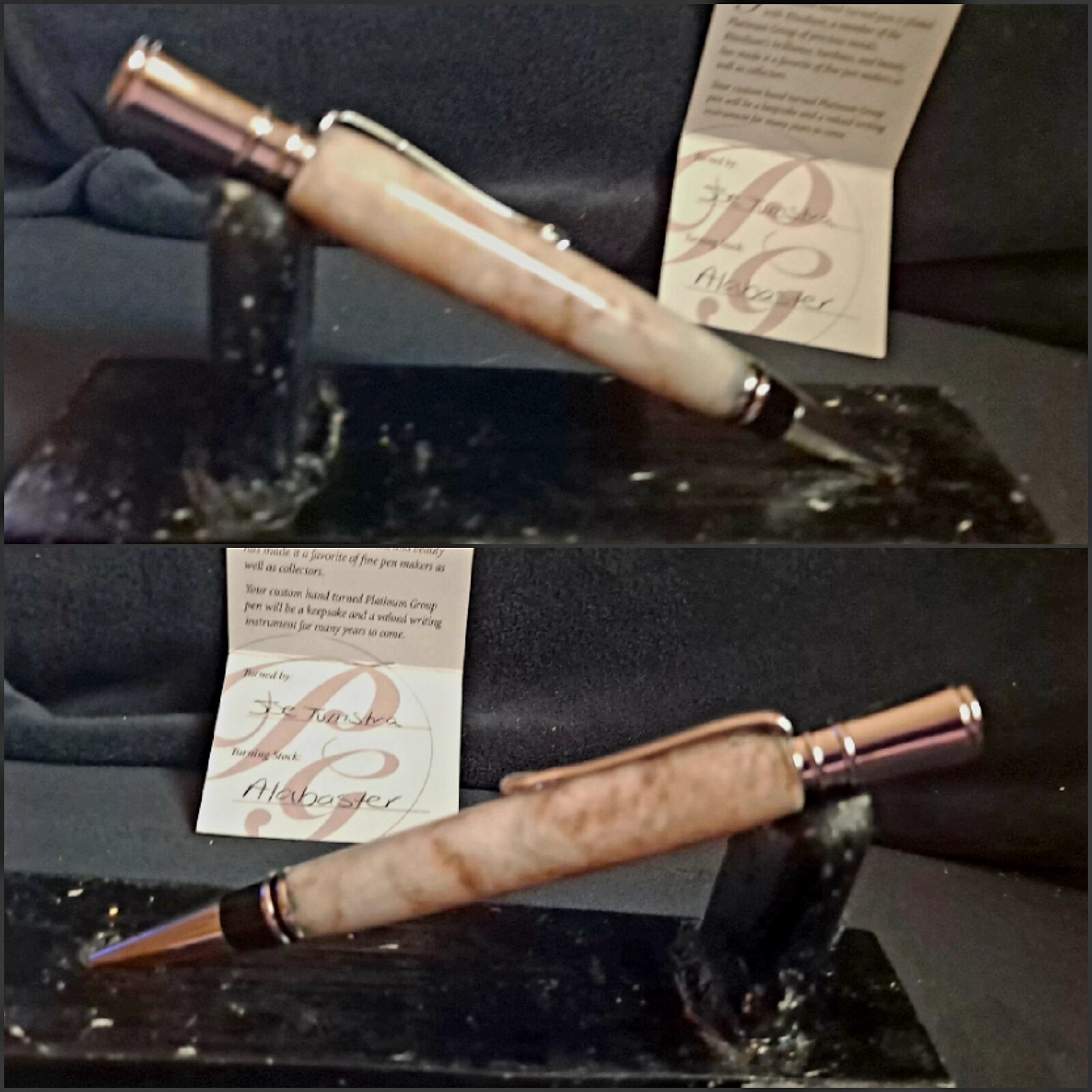

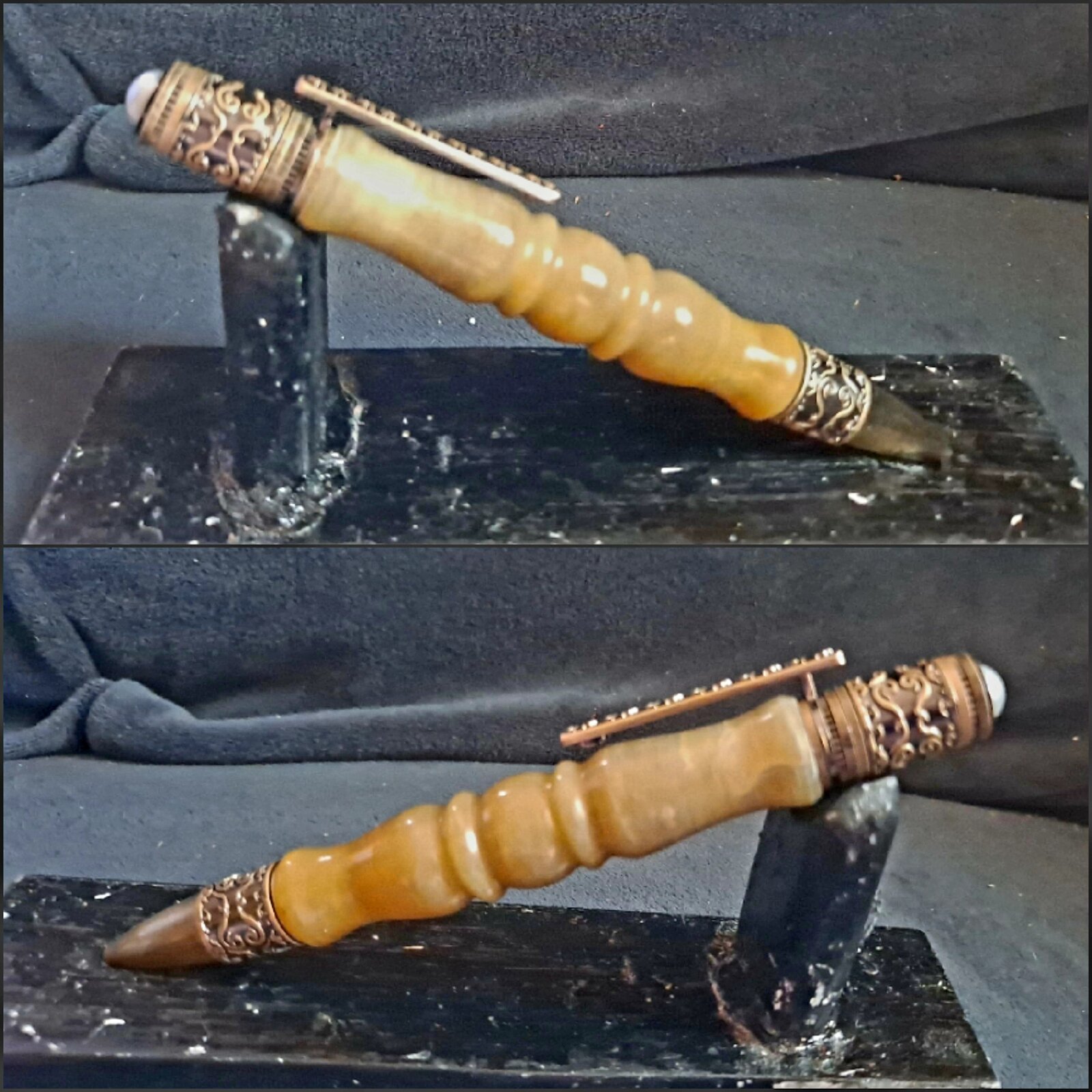

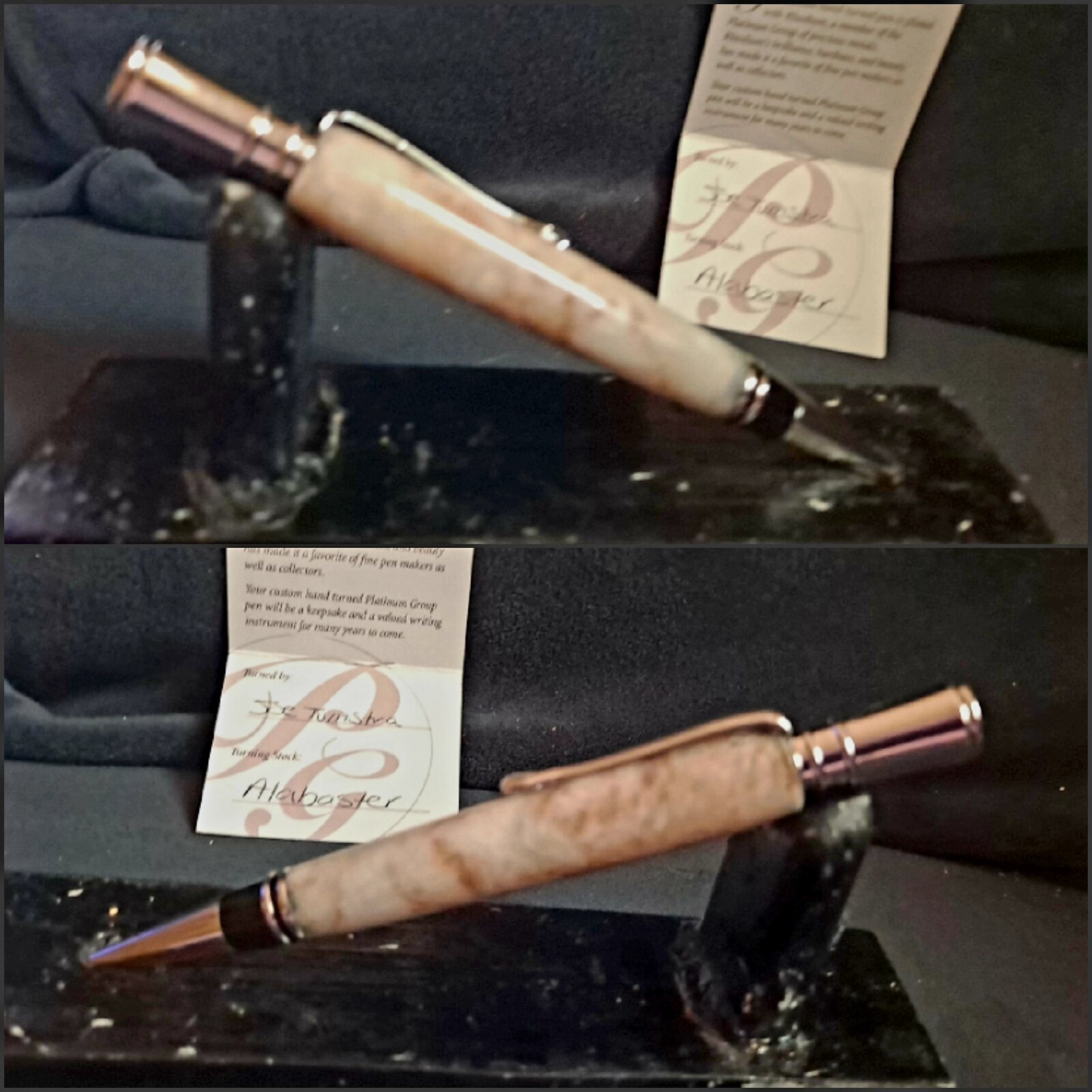

I just made a couple of pens from alabaster and soapstone and they are by far heavier than anything ive turned. I have a few blanks if you need 1 or 2.
