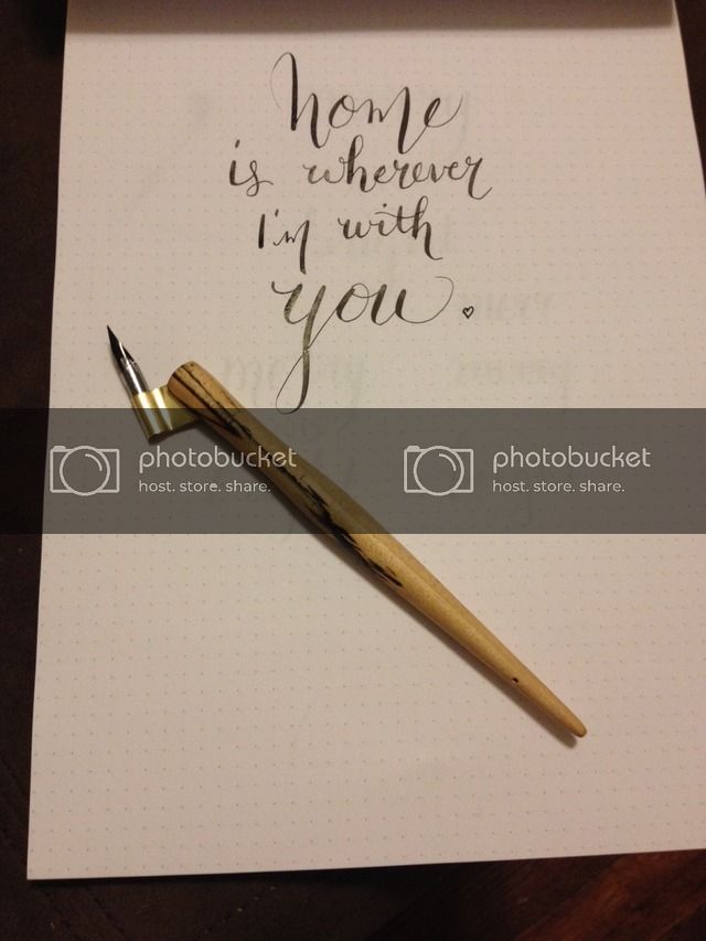

My wife recently took a calligraphy class and was taught how to use an oblique pen. Did a little reading and youtube watching and decided to try my hand at making one for her. I figure I could do a little better than the made in China, plastic one they gave her. Just did a real basic design to figure out the nib holder. Didn't want to spend a whole lot of time on a nice piece only to mess it up on the last step haha. She seemed happy with it, so that's all that matters. The wood is some spalted maple I had laying around. Comments and questions welcomed.

The holder looks good. Nice simple curves.
Its hard to tell from the picture, but it looks like the angle of the flange is a little off. Usually its about 50-55 degrees, with the point of the nib, in line with the center of the holder.
I'll be honest, I don't know the first thing about setting the pen up. I just would have my wife test it and keep adjusting the angle until it got to where she liked it best. She seemed happy with that angle. I did read something on-line about having the tip of nib in line with the center of the pen.

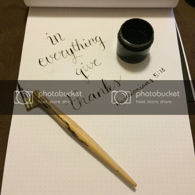

Looks great. My first attempt went so-so. My nib holder wasn't great, nor the cut to insert it.
I can relate, I made a few nib holders before I got one I was happy with. I ended up clamping the pen holder in my vise and cutting the slot with my super duper high end Japanese flush cut saw....from Harbor Freight haha. The kerf on the saw is close to the same size as the brass. Ended up using a piece of paper as a shim to create a real tight fit so the holder doesn't move.
