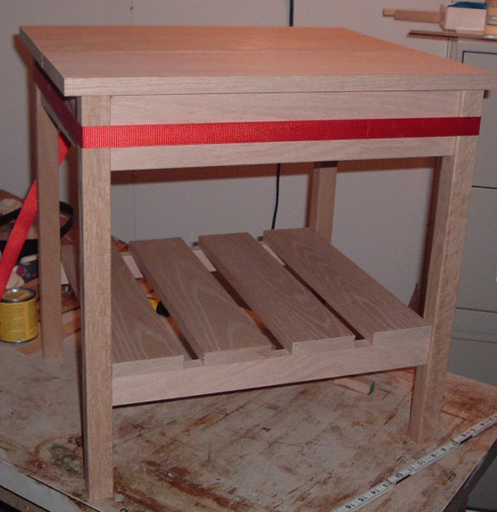

I wanted to see how 'inexpensive' I could make a side table.
This is about 20 x 17 x 20" high. I used 2 oak balusters 1.25" square from the box store and some S4S oak from the local lumber yard. I think there may be a drawer too, not quite sure. Nothing is glued up and the top boards and the shelf boards are not yet finished to size. Also nothing is sanded yet. I think I like the look and the concept. Now the all the parts are cut I can determine the cost of the wood.

Gary, I was told there wouldn't be any math.:wink:
What I calculated is about $45 worth of red oak, and that would include some 1/2" BB ply for the drawer box. Add a set of drawer slides, some stain and polycrylic and I figure I'll have something over $50 invested. I'm thinking it would be worth between $85 and $100
I doubt I could have saved much by buying rough cut and planing it down.
There is a lot of time involved in that. But, that is my preferred method.
My next one will be a 3 legged hexagon table from rough sawn maple.
Tony, I use loose tenons on the sides and biscuits for the top sections.
I made some modifications to a dovetail fixture that allows me to make consistent mortises in the ends of the boards and another jig that uses the guide plate does the mortises on the sides. Tenon stock is cut from the same oak using up otherwise scrap pieces.
Gary, while I may consider my time and effort worth more, I doubt I'd get that price. However, I can always start higher and come down!:biggrin:
Thanks all for your comments and kind words.
