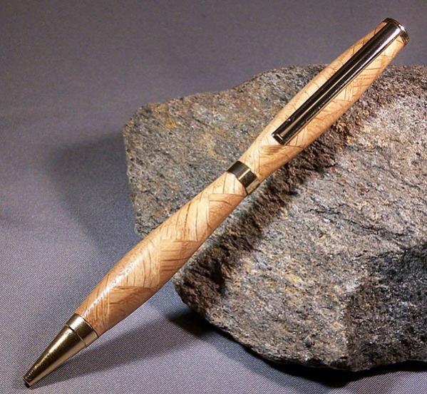

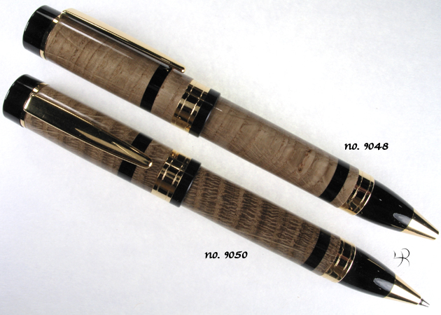

I have recently made about 30 pcs of oak pens. I sealed the surcafe with medium CA - wet sanding (the way Russ Fairfield did it in library).
I did not have any problems with grey dust filling the pores as long as I did not go over the bushings. I think that's where the dirt comes from. After sealing I went up to 12.000 MM and did several coats of CA.

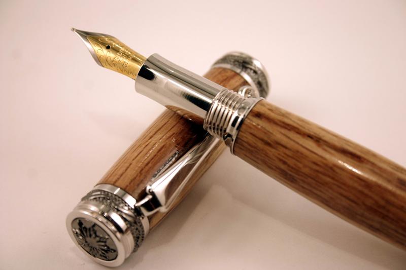

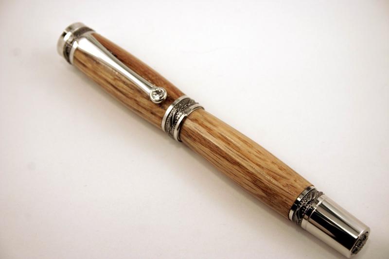

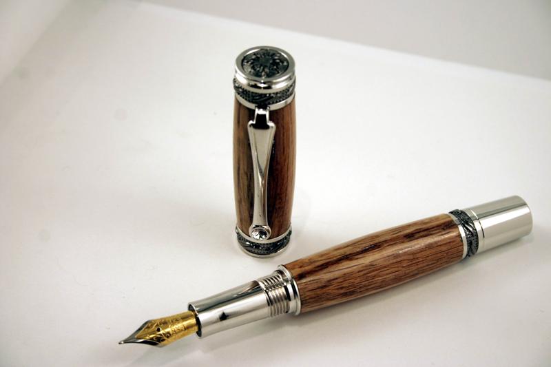

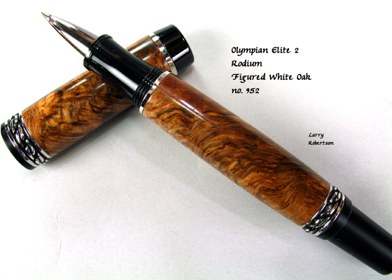

Some Pretty Oak
Highly figured white oak finished with Polyurethane
Crosscut White oak pen and pencil set finished with water born polyurethane.
The water born poly is very high solid content and tends to fill the large pores well. I believe I applied 9 coats with an airbrush on the crosscut oak and the pores are all filled. Water born poly surface dries very quickly as well (and no smell)

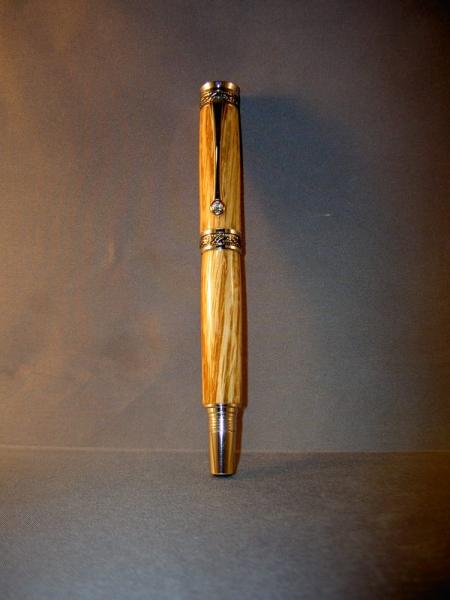

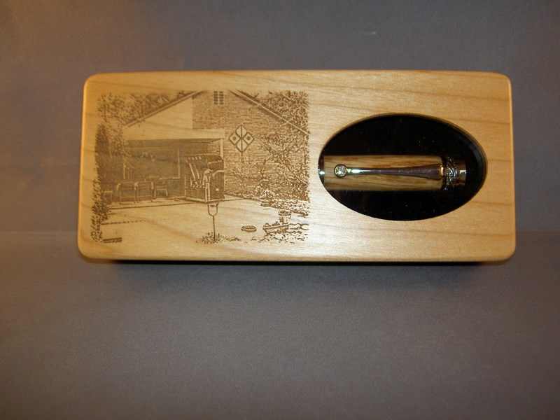

Thanks again for all the great info. I sanded and added CA at the same time, it filled the grain and looked very nice. I was able to get only the second CA finish in my 8 years of doing pens. I think I will stick with it and try to get it down to a science. I gave it to the customer this morning and he was very happy with the finished product. Thats what counts.

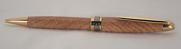

When I did my Majestic FP for daily use and abuse, I sanded to 320 and added two coats of med CA. MM to 600 to knock off any ridges or grooves. I didn't clean out the grain or do anything special.
It didn't come out super smooth or mirror-like. It has a rough feel and finish.

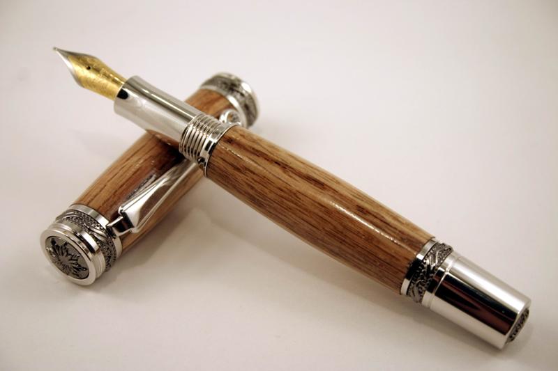

I did this olympia cutting the oak on a 45 deg. angle to the grain. Just sanded to 600, and my normal CA finish. No problems with dust getting in the pores. As someone mentioned earlier it may have been dust from the bushings.
