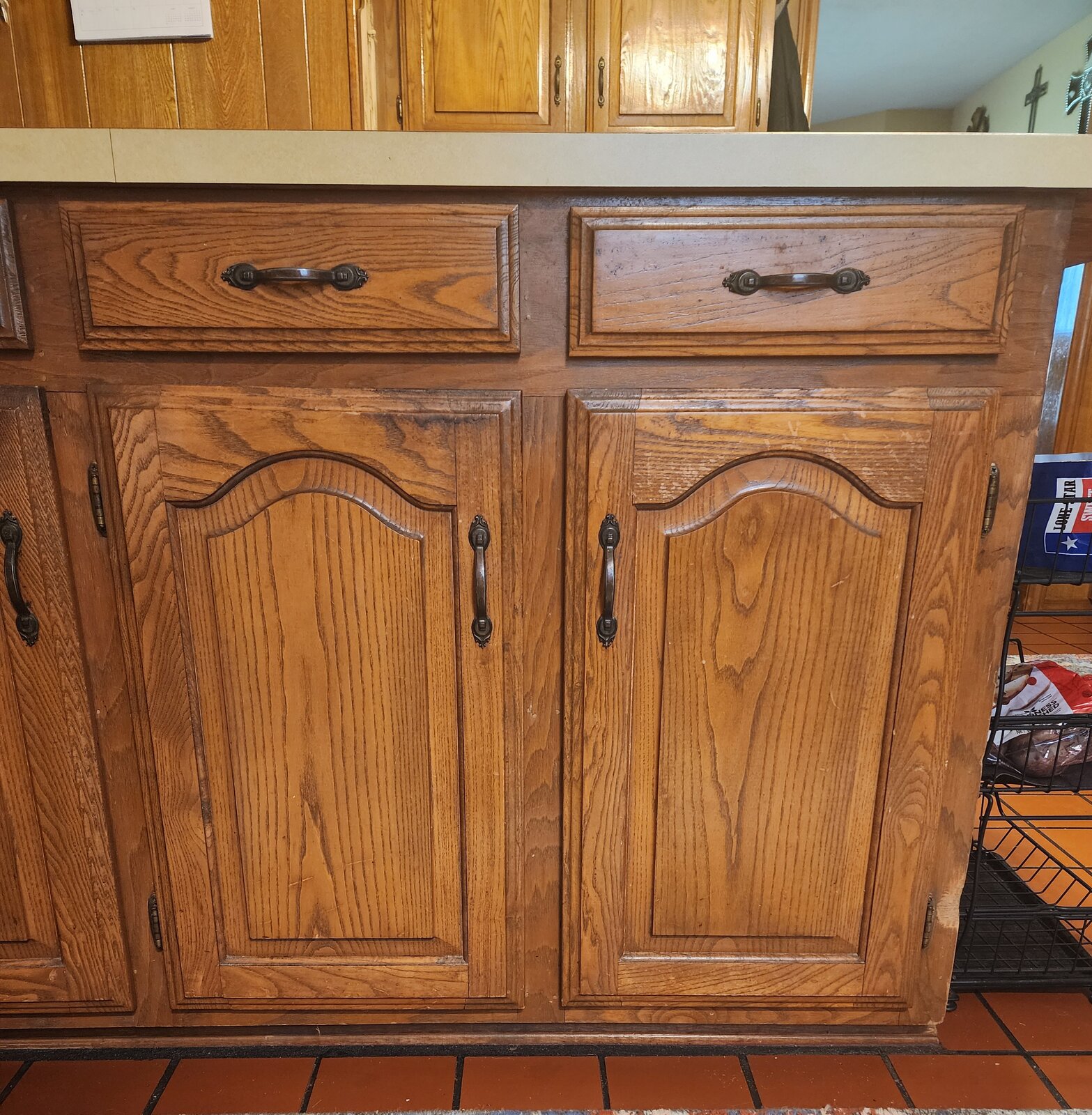

So our kitchen cabinets have a corner lazy susan setup that the lazy susan part is bad. I'm thinking of tearing that out and just making them two regular cabinets. I'm gonna have to get some boards to make the corner frame to be able hinge the cabinets too. I'm thinking the wood is oak. This house was built in the 80's and is solid, not laminate.
What do y'all think?
Thanks!

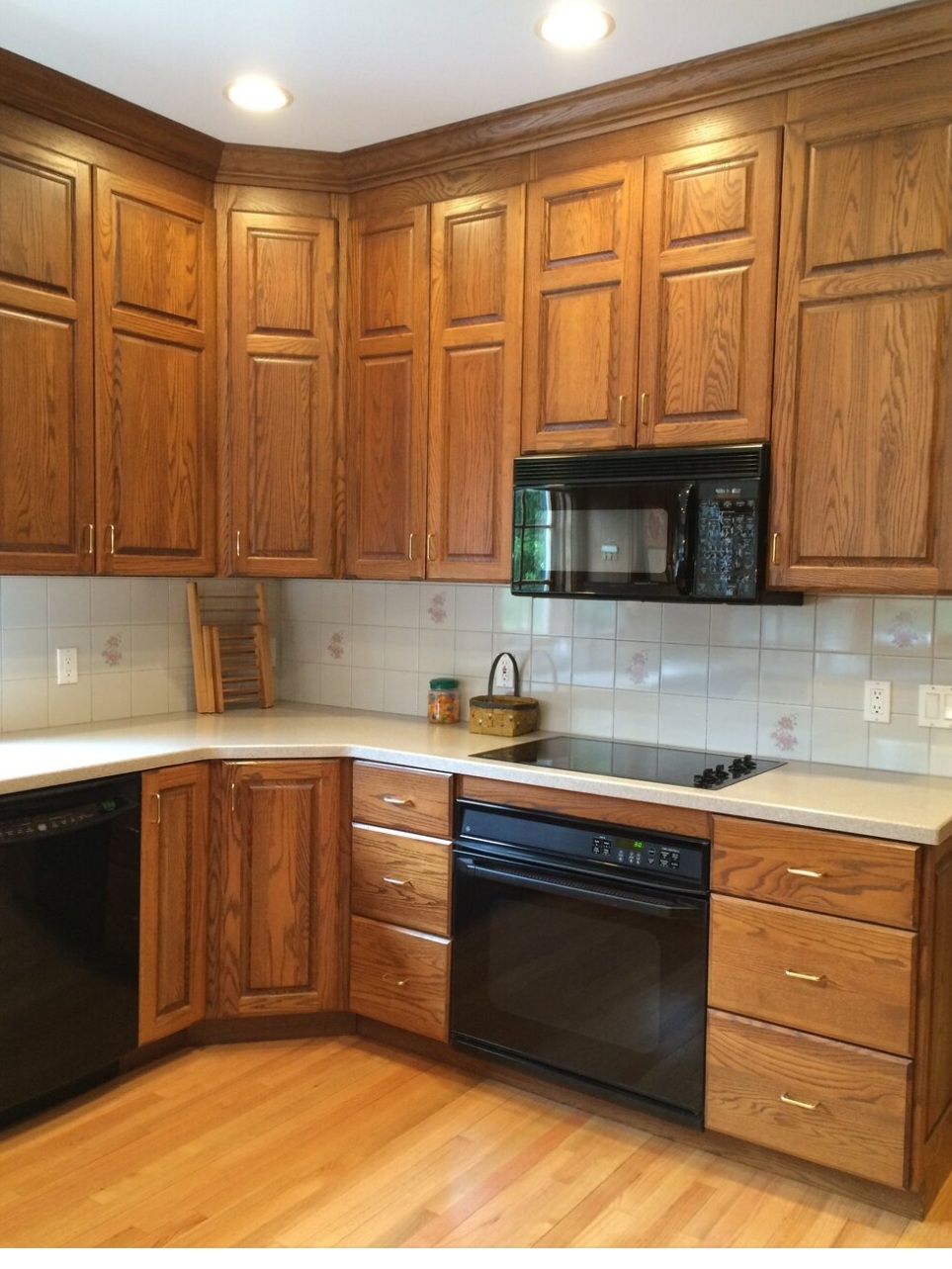

We had a home built back in the early 2000s and picked Ash for the cabinets because of those peaks in the grain.
Looked just like this. However, looking online at oak and cabinet photos, it's hard to tell the difference.

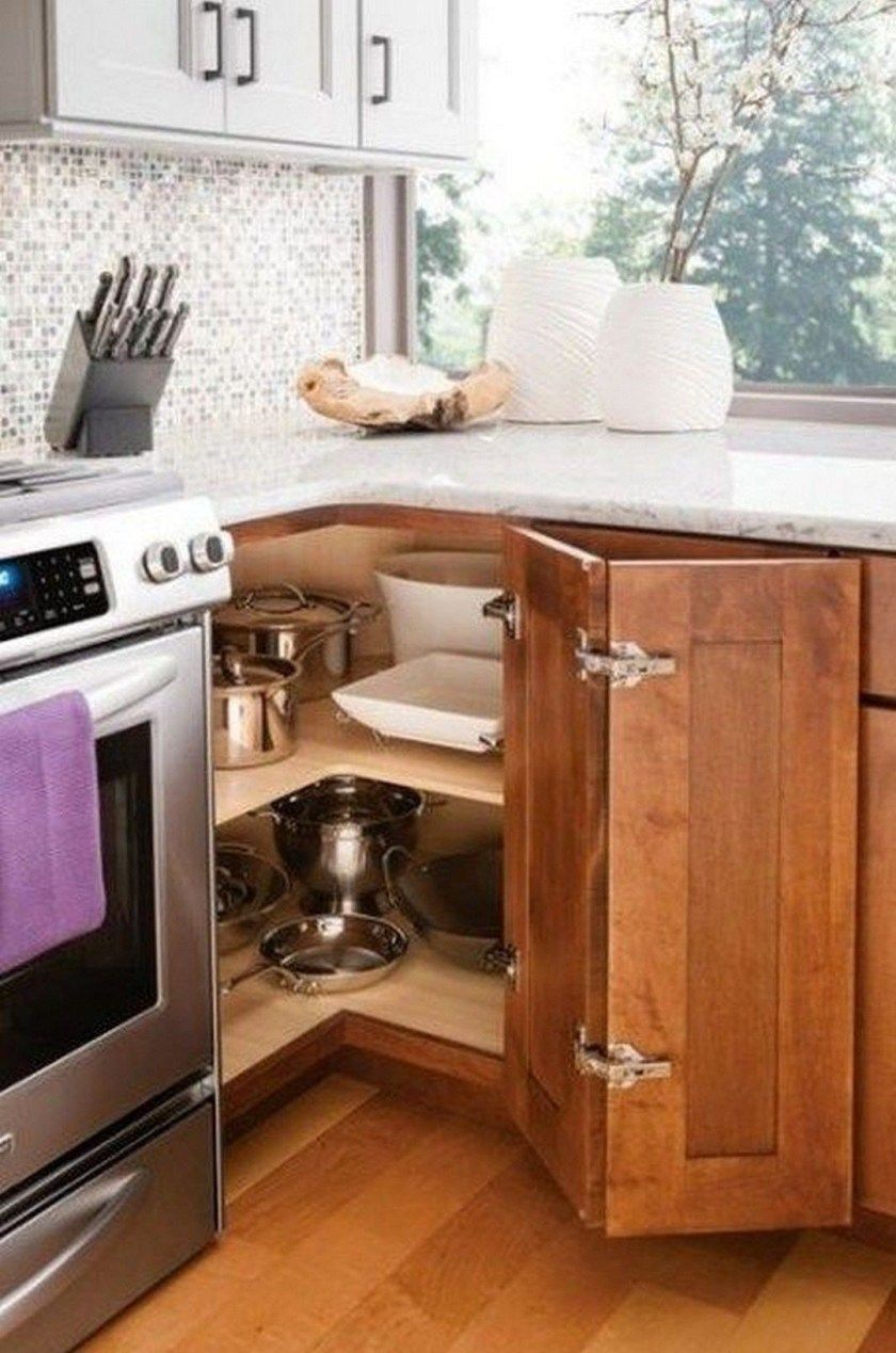

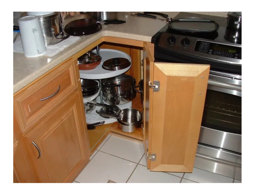

I would resist the temptation to make that corner into two separate units. They will be in conflict with each other and if you dont put some sort of outward extending system, getting to the items that drift toward that back corner will be a PIA. Just my humble opinion and past experience.
One example
One example

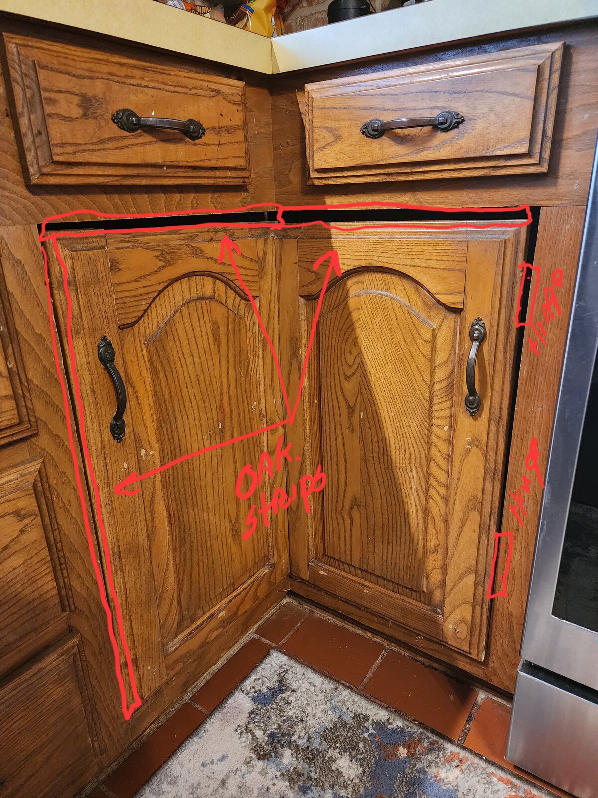

I see what you're saying. I like the concept in the video but a lot more work than what I want to do. I wish I could just make an "L" door to swing out but don't think I could hinge it to stay flush with the cabinet.
I'm wondering if I could just add some oak strips on top and one side of cabinet. Hinge one side and just swing out the door. Won't be flush with wood but will look same as other doors. Thoughts?

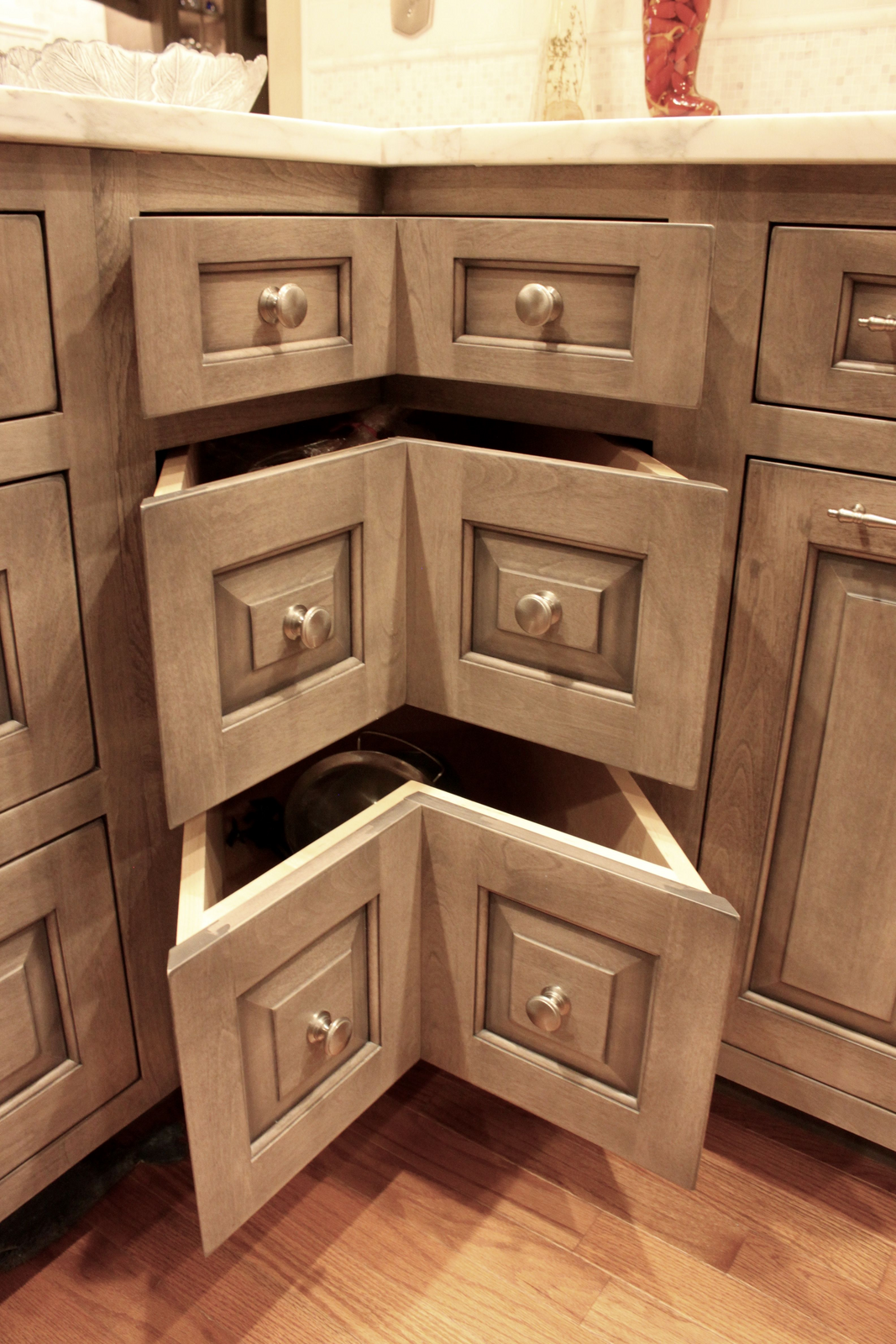

Have you looked at corner slide out drawers? Unless there are obstructions the existing corner cabinet door gets attached to the bottom drawer. If you haven't, and if you are interested, I can post some videos I have seen of people installing them. - Dave
That would be cool Dave. I have taken these doors off 3 times in the past to hopefully just fix the lazy susan to no avail. It would be nice to just get a setup I can mount to the bottom of the cabinet instead of mounting separate shelving tracks and all that. Lol
Btw, I see videos on the slide-out shelves that I can mount my originals doors too, but haven't found anyone that sells them.

That's pretty cool! I'm almost leaning to just double hinging the doors, taking the susan out, and just give the wife a place for her large kitchen appliances. I think that is going to be the cheapest and physically easier thing to do. Lol
