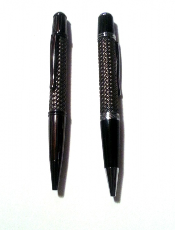

M mike4066 Member Joined Sep 24, 2014 Messages 353 Location Akron, Ohio Dec 21, 2015 #1 Les has been posting these here and on FB so I had to try it. Wall Street II and a Le Roi cell phone pic a that I had to lighten up.. hope you can see it Attachments 2015-12-21 21.29.09.jpg 71.3 KB · Views: 341

M mike4066 Member Joined Sep 24, 2014 Messages 353 Location Akron, Ohio Dec 21, 2015 #3 Thanks, its interesting because its a "no turning required" pen.
magpens Member Joined Feb 2, 2011 Messages 15,907 Location Canada Dec 21, 2015 #4 Mike, do you coat the whole braid with thin CA ? Also, is there a coat of paint or a black sleeve under the braid ? Thanks.
M mike4066 Member Joined Sep 24, 2014 Messages 353 Location Akron, Ohio Dec 22, 2015 #5 magpens said: Mike, do you coat the whole braid with thin CA ? Also, is there a coat of paint or a black sleeve under the braid ? Thanks. Click to expand... It is glued with enough thin CA to stick to the tube but not build up in the gaps of the braid, think wick not coat. Yes, the tube is painted black.
