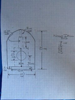

I purchased several Nutmeg graters from Exotic Blanks. There were no instructions included and I cannot find them on the Exotic Blanks website. I have emailed Exotic Blanks several times and have not received a response.
Does anyone have the instructions for the Nutmeg grater that Exotic Blanks sells?

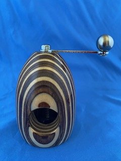

I am out of town until Monday but can send you instructions I made for it. It is simple but does require a few bits.
When done it looks great and works well. I will check with you here on Monday and will post them. Sorry for the delay.
That's fine, Mark no rush. I probably won't get started on them for another week or two yet. Just wanted to see what size blanks I need to get.
I believe there is basically no max limit on blank. Maybe a minimum limit to fit guts in but any shape you want. Your design.
Here you go - all the sizes are in mm (not that I use it but that is what I figured out or found). And the drilling for the most part can be approximate - if you want to use US measurement bits. The one I made I used nutmeg (brown) spectraply.
Let me know if there are any issues or you need more ...
Hope this helps.
