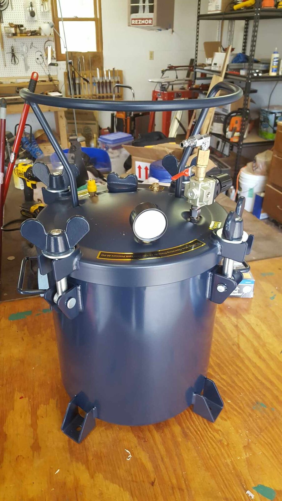

It came in today. I did all the tests you recommended and it passed. The box was California Air Tools.
Very good. That is a big boy one. After your post I decided I needed to upgrade so I bought the 2-1/2 Gal because that is all I need for what I do. I did a review of mine and they are well built and recommend them to anyone getting into casting. yes they are more expensive than a Harbor Freight but well worth the security and safety they do offer. Good luck and hope to see some terrific stuff come out of there.
