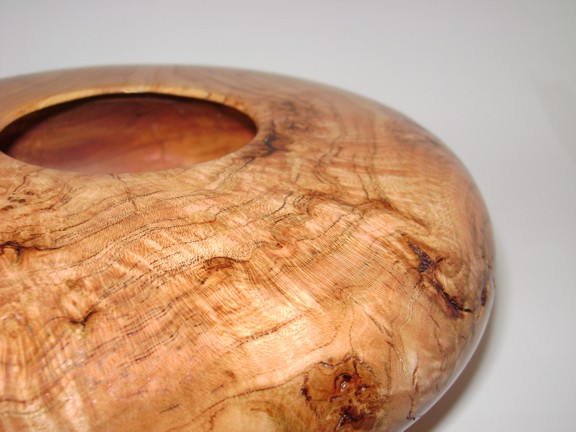

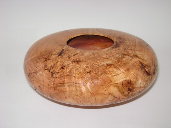

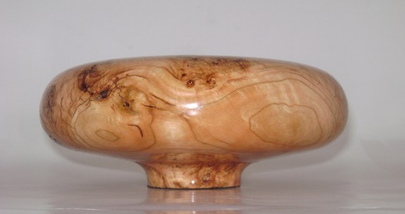

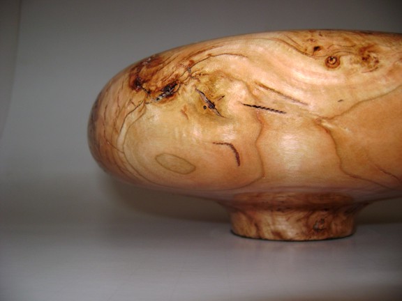

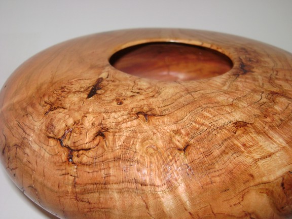

Cherry Burl Hollow Form (from the same burl I've been posting)
About 8-9 inches wide and about 4 inches tall.
Totally dripped/soaked in CA Glue to fill in cracks. I used Baking Soda as an accelerate. (something I had seen on a science channel) Bad thing was it turned all the cracks white. After, drying it was turned again then sanded. I then used some Cherry stain (hoping to do something with the leftover white cracks). After the stain dried I sanded down to 320. Then I put 6 coats of poly wipe.
I don't know how this shape happened, but something about the way it was coming out I liked. I think of it as if I was in the 1950's and this is something 'they' would say would be the shape of the 'future.'
