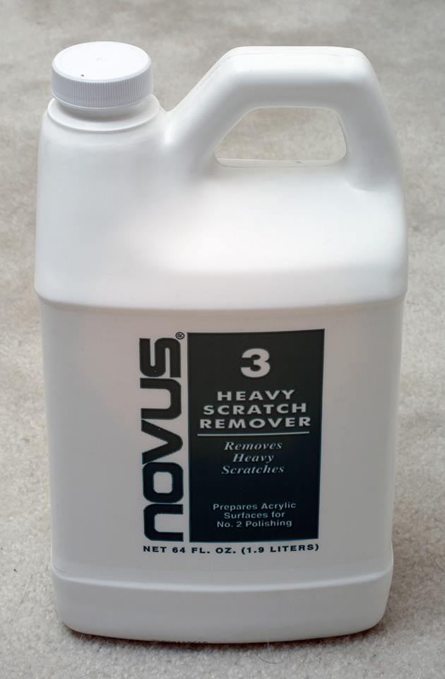

Having said that ;) How do you know you are hooked on novus? Simple, you have containers like this in your home. ...
attachment.php
