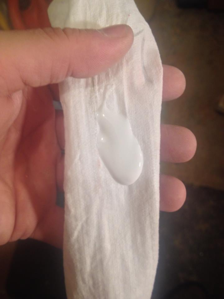

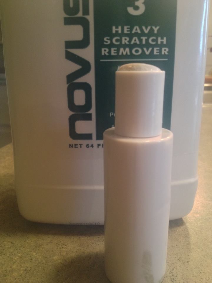

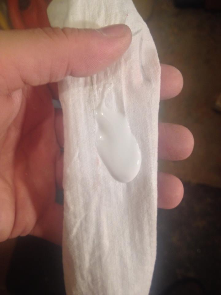

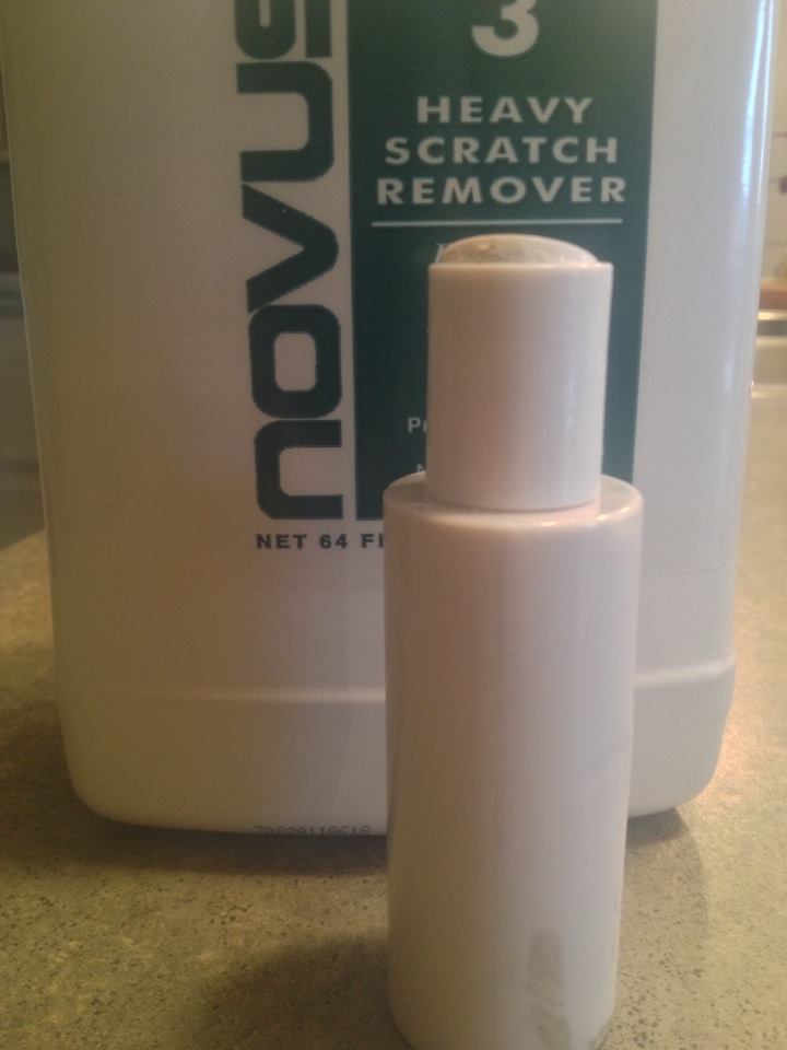

This is the amount that I put on. Also the container that I use. The flip top lid comes in very handy, does not clog up, easy to operate one handed and the bottle can be bought in the travel section of just about any department store for under $1. Also if the bottle gets damaged then it's not end of the world.
Also just because I put out that amount of Novus does not mean it all goes on at once. I will feed it to the blank over time, I start working at the end and pull the blob out of the blank and use the section above the blob to work that in then add more. If you put all on at once it will sling it all over the room which is bad bad and bad. I could go with less amount and recharge the towel more often but I choose not to :)
The other thing to note is because I focus on one spot on the towel that spot becomes wet so the blank does not really dry out. At the end of the session I will use my palm in place of the towel and that to gives finer polishing
