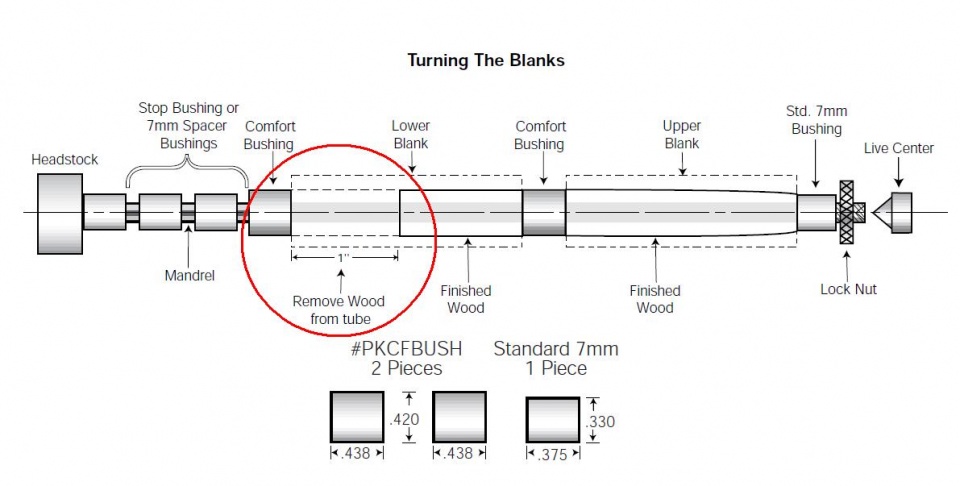

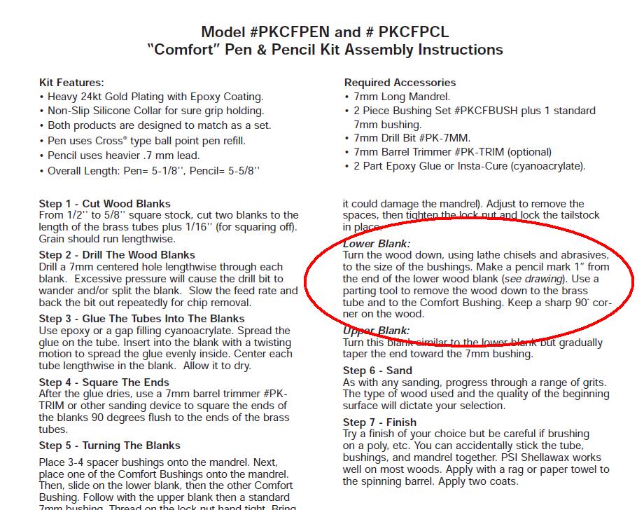

Just looked up the instructions on the PSI site. It's 1' of blank you remove from the lower blank. I remember now why it was difficult for me to locate when I turned this kit. I'm very "graphic" oriented. I skip right over text and go for pictures in all instructions, no matter what the item. In the graphic, shown below, the tapered end of the pen is on the right hand side, which made me think that's the lower blank, (even though it's clearly labeled as the upper). I always have pens oriented on the blank with the lower portion of the pen to the right, which fits with the graphic in the instructions.
