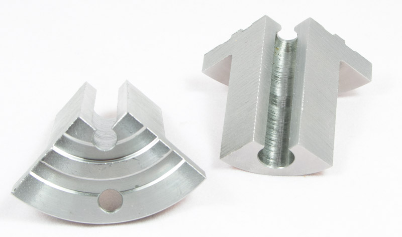

It's here. Confirmed there are 2 holes on each jaw. Well 1x whole hole, and 1x 3/4+ hole where the screws go. No screws were included in the box. I know I have them, but seems like they'd put 4 screws in there. There's not that much cost on that.
Here... haven't mounted them yet, but I think this will show what you want.
ok that is weird. it is going to take a long bit to reach that area. In truth you can probably just use the outer screw, esp with that quarter circle ridge on the bottom.
A T-handle key should fit no problem is think. I forget the exact size of these screws but harbor freight has sets of the long T handles cheap.
If they are like other jaws the screws are universal.
Teknatool also has the spares on the website.
NOVA Chuck Fastening Spares
They list
8 x M6 Screws
1 x M3 Allen Key/Wrench
1 x M4 Allen Key/Wrench
1 x M6 Grubscrew
1 x Fibre Washer
The M3 key, grubscrew and washer is for the insert adapter.
I suppose any long Allen shaft M4 should fit nicely in there, Afterall the jaw grip length is 1 1/2" so 2"+ should fit.

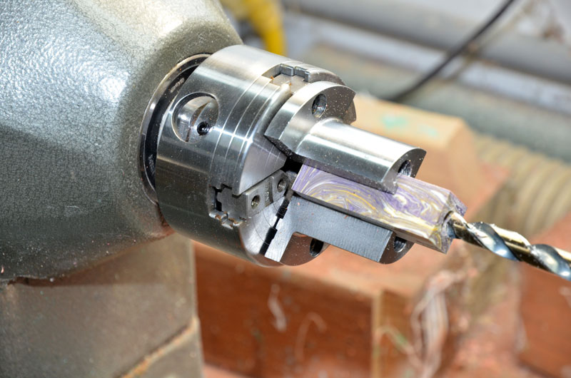

Just chucked up a couple blanks. I promised my better half Tammy a particular pen from a Chipped Mint and Chocolate Euro Blank from ClassicNib, and 1 for inventory. It did beautifully as expected. Nice tight grip. No play. The Allen key that came with the chuck originally is long enough to put the inner screws in.
One thing I need to look closer at. It felt tighter when I left the blank above the screw holes. So 1/4" or so from the bottom. It gripped fine and the only place I saw a noticeable mark (like I care since it's going to be turned anyway) was on the paper label.
Short answer: I like it better than pIn jaws or the smaller PSI chuck.

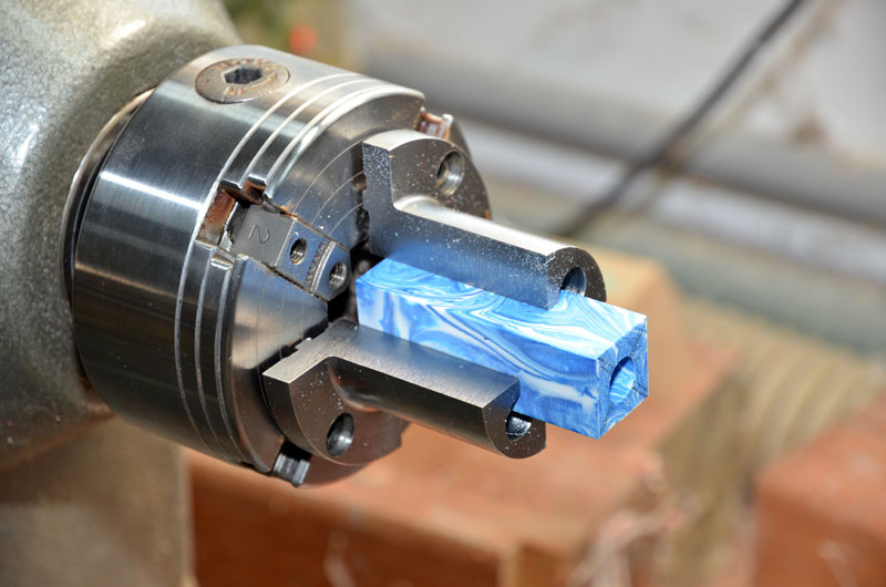

OK a few notes about these new pen jaws. They are massive compared to the pin jaws. This allows me to mount my blank in them and easily be able to see the back of the blank while drilling. I really like this as I can see exactly what is going on with the entire blank as I drill. The pin jaws are just short enough some of the blank is quite a ways back so I really have to work to see what is going on. This is especially difficult when I am trying to watch my segments for signs of stress.
The pen jaws have a nice large area behind the jaw that allows the corners of the blank to not come into play. This means that if you have a blank that is not square that will be taken out of the drilling equation when you actually clamp down on it. Also these jaws take a very large bite and hold thing very stable.
These jaws also open up much wider than the pin jaws and this means that I can put a larger blank into it. I have often had a blank that is just a little too large to fit diagonally in the pin jaws. This will not be an issue at all with these.
Last but not least. These are powerful jaws you can really clamp down on them if you want to. Not that this is really necessary but these jaws are definitely big boy jaws.
I am very happy that I purchased them, they will be my standard jaws for pen drilling.
Hope this helps you all.

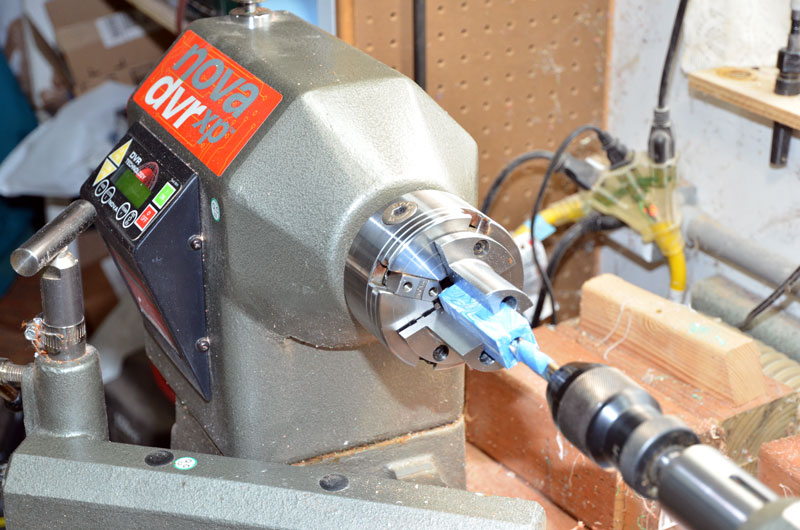

Mine came today so I had to drill a couple blanks. I am impressed, the jaws are beautifully machined and definitely heavy duty. I tried it on my G3 and Super Nova 2, worked fine on both but they will reside on the Super Nova 2, much nicer chuck to use.
