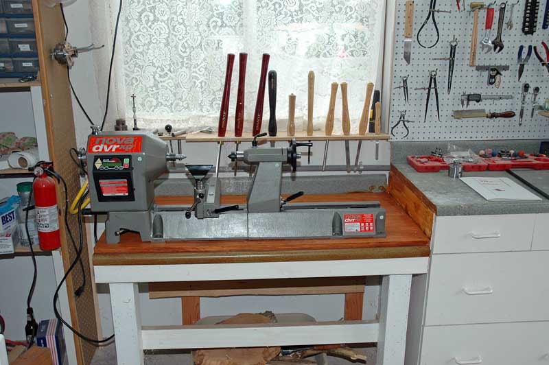

To join the thread; The cast iron legs raise the lathe up too high for my taste. The lathe bed is flat on the bottom, so raise the lathe up on some kind of mounting blocks so you can sweep chips from under the lathe.
The Nova DVR-XP is the best thing I have ever added to my shop. You will love it.
