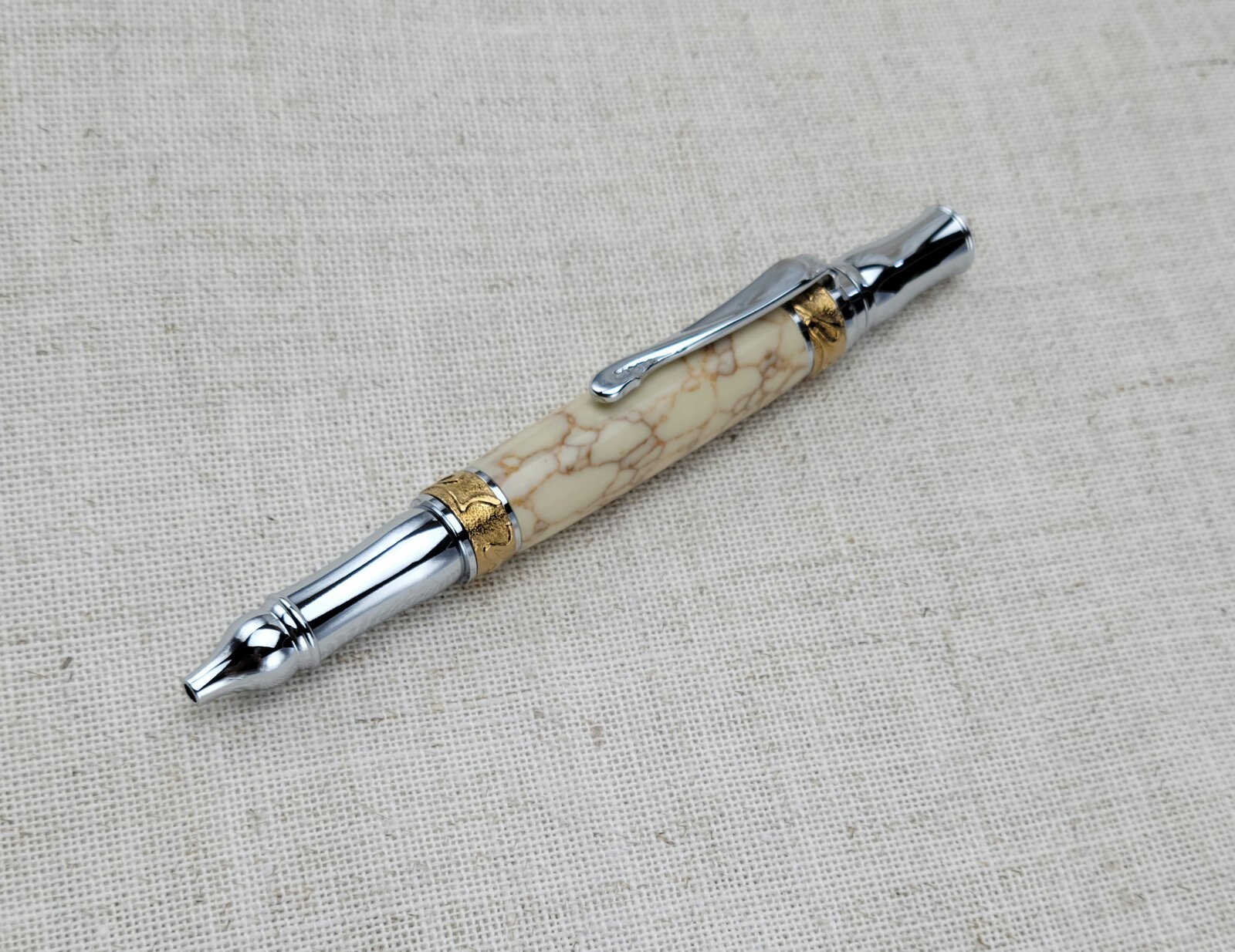

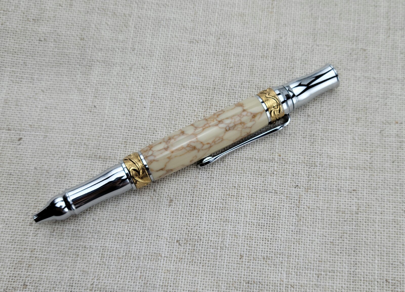

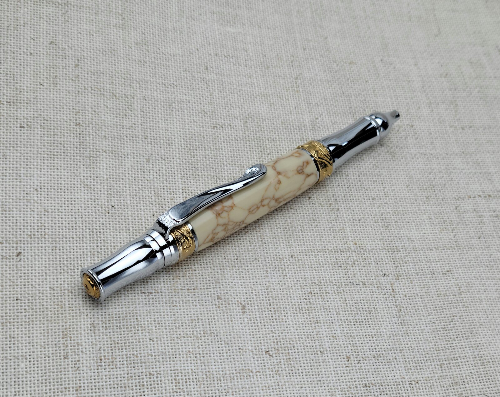

This is my first time working with truestone, or whatever PSI call their version of it. I polished it down through the grades of Zona paper with no finish over it. Wasn't too tough to work with, but a little dusty.
Awesome!! I've always liked the look of the Trustone blanks. A friend told me he had a heck of a time with his first...messed it up. But he showed me his second attempt, it was very nice, he said it was a bear and he wouldn't be doing that soon! At about $30 a blank I want to get more experience before I try it...and look for a sale on them...LOL.
Yours came out beautiful! Will there be another soon? Any tips on what to do...and not to do differently than other blanks?
Beautiful pen, very complimentary combination of blank and kit. Best part is you can easily make another just like it with the same blank...
Thanks all. This was the cheaper version of the stone blank. I don't know what the difference is, but they both say real pulverized stone with resins. They were on sale a while back so I picked up a couple with the order. I don't know if there will be anything more soon as I have had very little shop time and way too many things I have been ignoring for way too long (think the Beatles song "While My Guitar Gently Weeps", but substitute lathe for guitar, and turns for weeps)

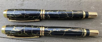

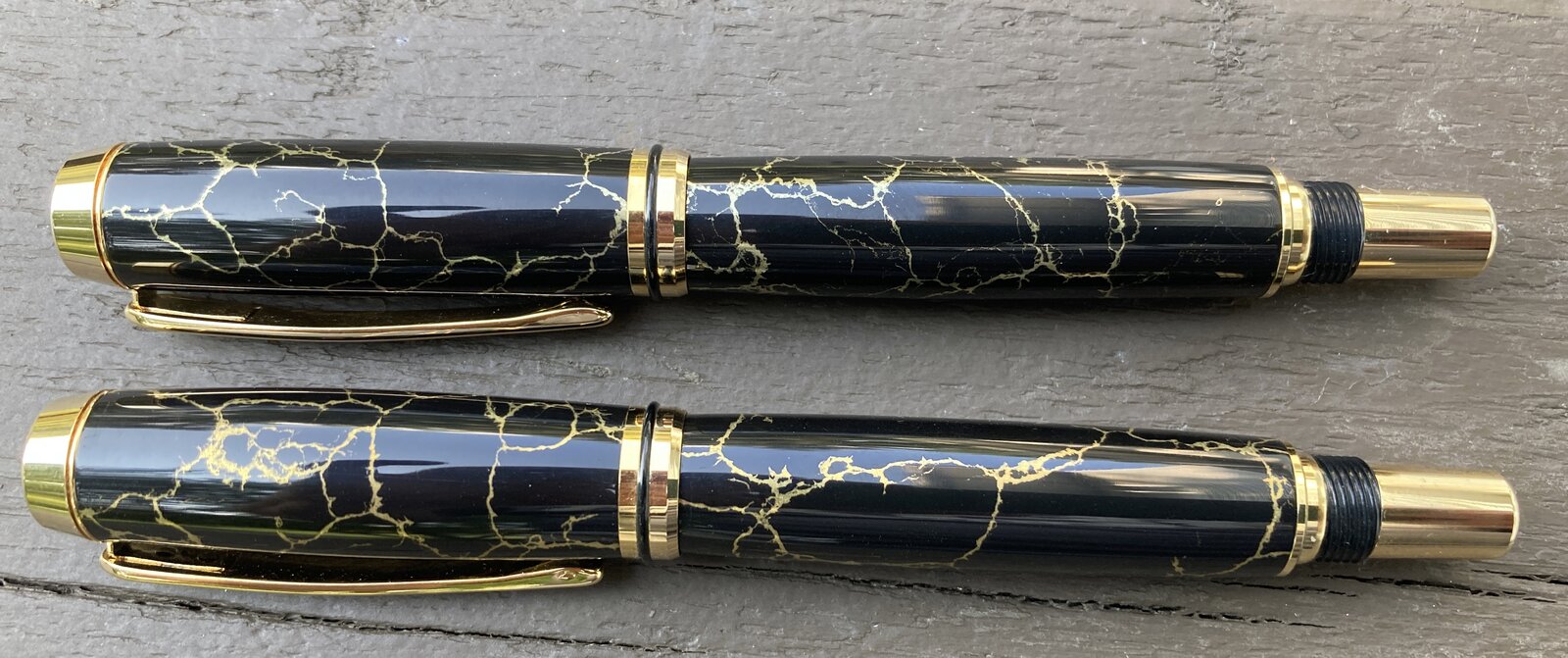

I have made several pens from Tru-Stone - I had read all the cautionary posts about it being hard to drill, hard to turn, and hard to finish. I think the main enemy of these types of blanks is heat. Keep your drill bit cool. Keep your turning tools sharp. Go easy on the sanding (a lot of dust can be generated).
As for applying CA, I think it's a matter of personal choice. The pens in my photo were wet sanded with micro-mesh, polished with Meguiar's Plastix, and buffed on a wheel buffer. I did not use CA.

Beautiful pens Kevin!! I want to try that!
