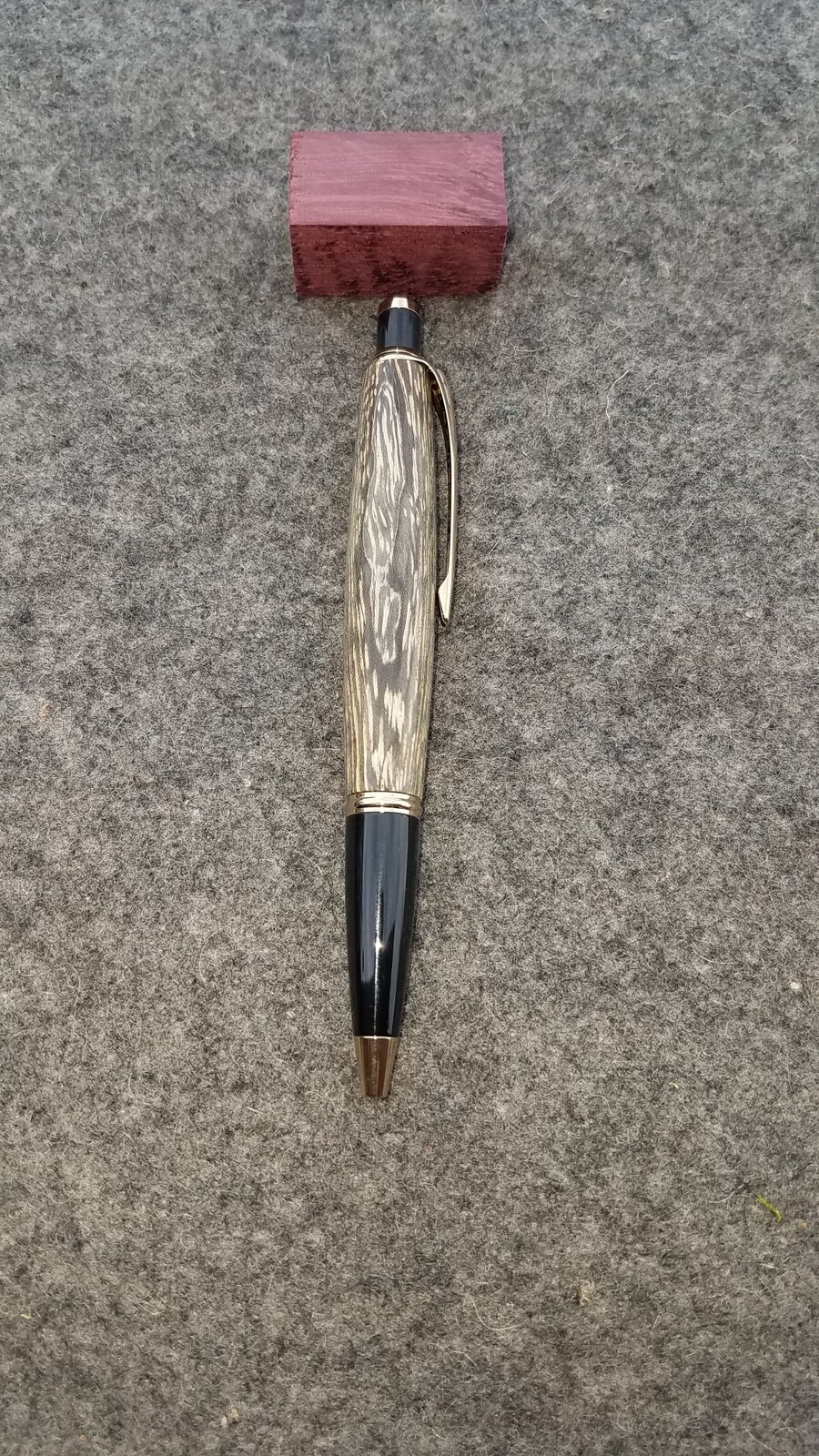

This is not what I was going for, but not disappointed either. I turned a PSI Compson click tube with purpleheart, sanded to 500, and then dropped it in bleach for about an hour and a half. I let it dry overnight and then put back on the lathe for a CA finish. It really brought out some unique grain of the purpleheart. I thought the gold metal finish went well with the olive color. Thanks for looking.

That is different. Not sure I ever heard anyone trying to whiten purpleheart. Always hear they want to keep that color purple. Wonder what would happen if you left a piece alone after you bleached it. Did the bleach take all the oils out of it.

Cool result, Mike !!
Thanks for showing !!
I am wondering, though, whether the color will change again with age.
Also how any residual moisture from the bleaching might affect the CA.
Please keep us posted.

I've never seen purple heart this way. Seen and did a few Wenge that resemble it. They stayed that way after sealing in CA. Guessing that one will too.
