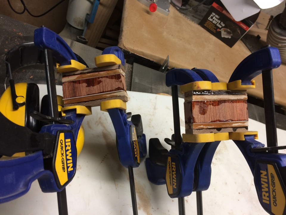

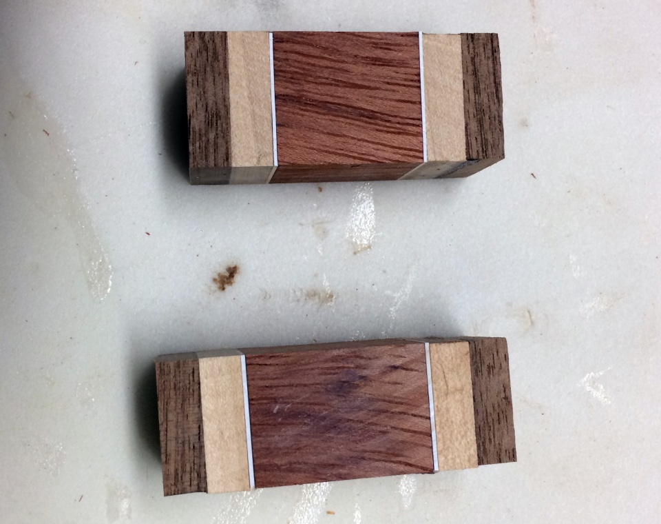

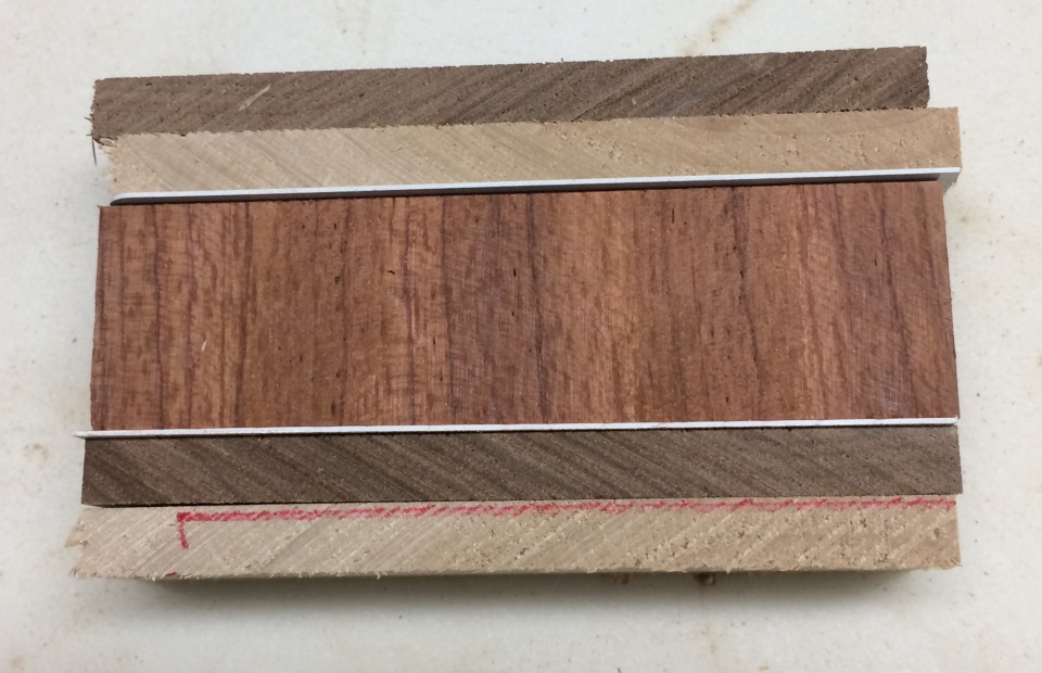

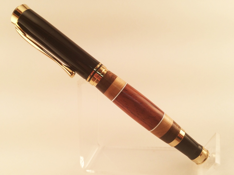

In my mind, I imagined this really cool PSI Olympian Elite 2 piece pen, with segmented blanks for the cap and main shaft made from Bubinga, Maple and walnut. So I jumped in, glued up the blanks, and I was really getting into it.

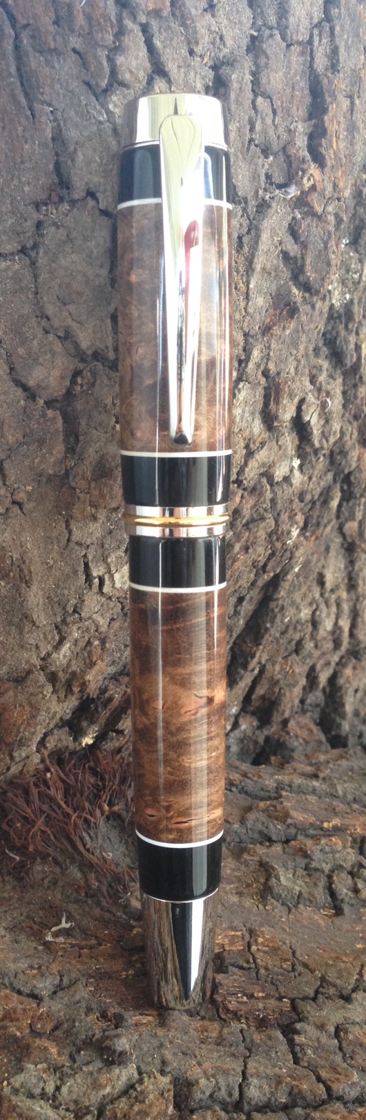

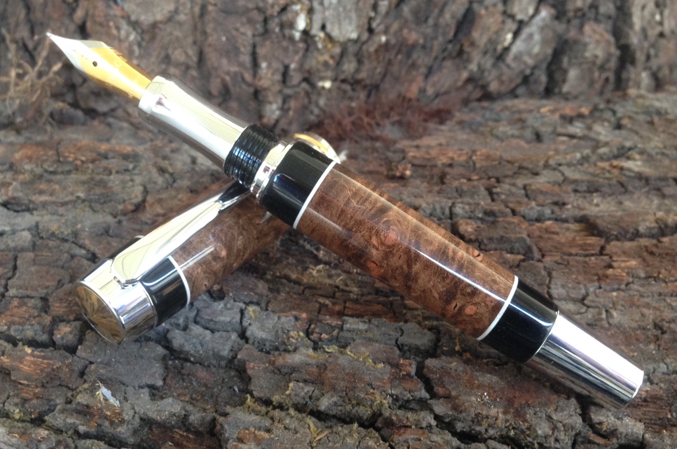

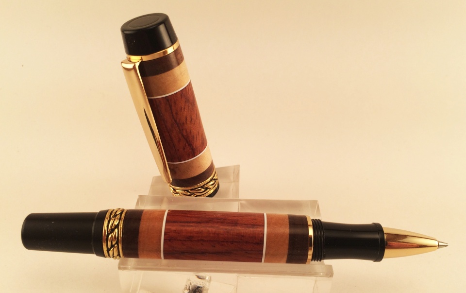

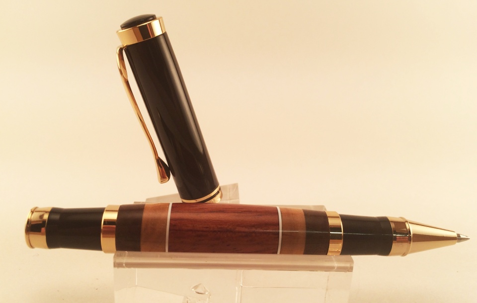

I then went about cutting, drilling, and gluing tubes into the blanks, and tonight I made the first pen.... and I don't like it at all. There's too much going on.
So the lesson I learned is that a segmented blank like this would probably look ok on a single barrel pen, but not on a 2 piece.
I also learned a little about turning woods with different grain directions - the Bubinga (center section) was soft and turned very easily, but the Maple was end grain, which is much harder. The walnut is also end grain, but a bit softer than the maple. The result is uneven material removal as I passed the gouge along the length. I ended up sanding more at the end, to get everything to the final diameter. Also, as I sanded, the maple seemed to burn a bit, resulting in some dark discoloration. I think some of the walnut sanding dust may also have gotten into the maple's pores. Dunno.
Anyway, I have a pen that writes ok, but looks like I tried too hard to make a fancy pen... I don't think it's going out of the house, except maybe in my wife's purse, so she can cross stuff off of the grocery list at the store.
Thanks for reading. Any tips would be appreciated.
And by the way, I still had a blast making it! I learn a little (sometime a lot) more with each pen.
I have run into that before also. There are some segment designs that when on both parts of a two piece pen, just distract from one another. Yours doesn't look bad at all!
On mine, the individual segmented sections I made looked great, but together it was the pits.
The pen looks good and the blanks are flawless but I agree, it's a little busy. I did the same thing when I started segmenting, only I made blanks very similar to yours for two pens and decided it was too much only after finishing both. At least you learned in half the time it took me!
Still good work and nothing to be ashamed of. I'm sure many will think it looks great just as it is.
I like your pen personally. Yes, it is a tad busy.

Excellent Segmenting Kevin.
I don't think that it is too Busy, but more like the Sizes of some of the Sections, may have worked better if they were Smaller and the Major Materials, made a little Larger.
I suppose what I am saying, is that some materials could have been sized as Thick Veneers, rather than "Chunks" of Wood, and would not have create a Busy Reaction.
Your Segmenting is Terrific, Excellent Fit and Finish.
Yes when you use different materials, and Differing Cuts, you will get differences in the amount of material removal, and some times colour transferring, so you need to be conscious of this when Segmenting and also Turning.
An Excellent Lesson, and from what you mentioned, Well Learned.

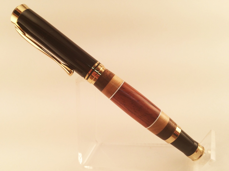

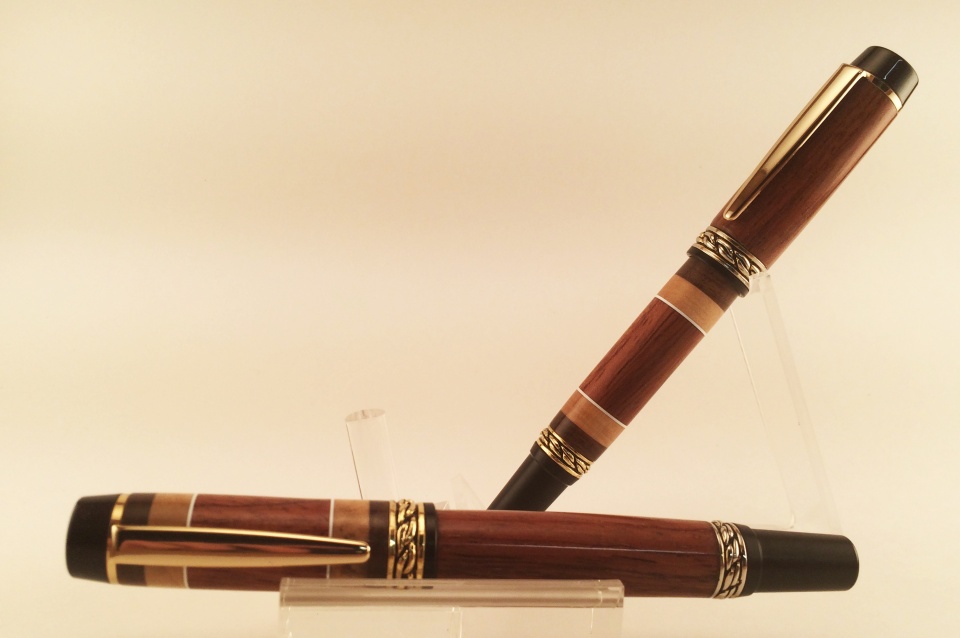

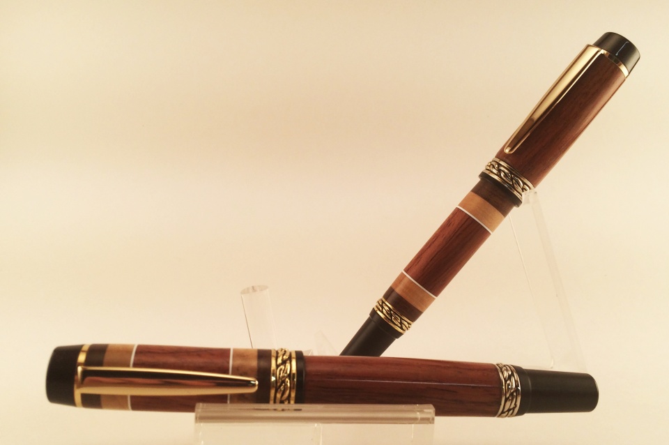

GWatson: Brilliant suggestion! I happened to have an Olympian Elite 2 Pen made of solid Bubinga, so swapping the caps between the 2 pens sort of gets at what you are suggesting. I wished I had thought of that!
IMG_3293.jpg,

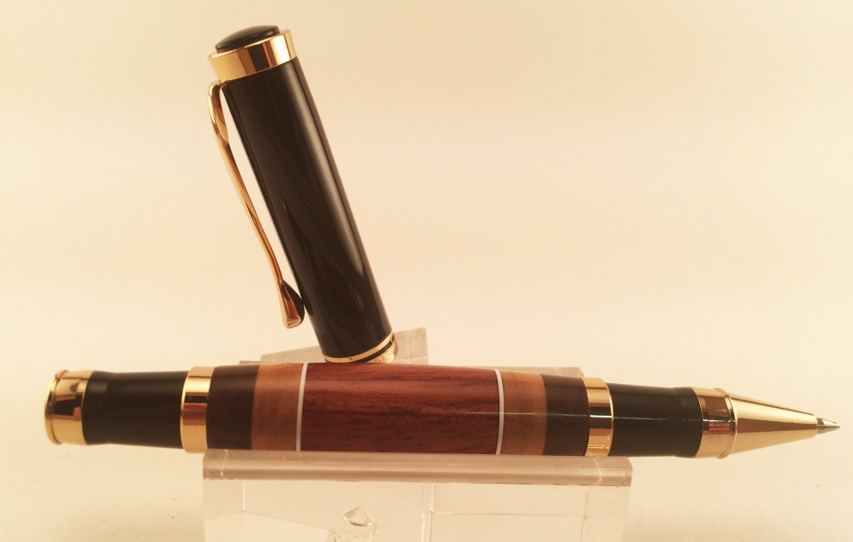

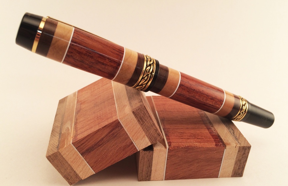

Also, I had some extra segmented blank material left over, so I made an Oxford Rollerball with a single shaft. It's less busy.
I think that's the end of my lessons learned for this topic. Thanks again everyone for the excellent feedback!

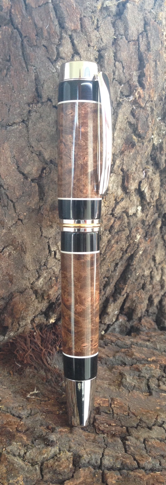

My personal carry is similar in design with a few subtle changes.
View in Gallery
View in Gallery
View in Gallery
Same basic idea with a few differences. Blank is made from only 2 species - Maple Lace Burl and Ebony with a Credit Card dividing line. Had I added another species next to the Ebony I think I would have run into the same issue you did.
Now, when I build my next one I will only do something special to the cap and leave the body one wood. I also think mine is a little busy with the cap and the body matching but a lot of people really like what I did.
