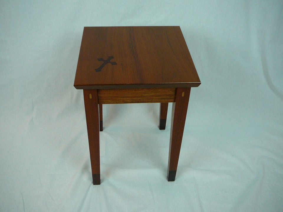

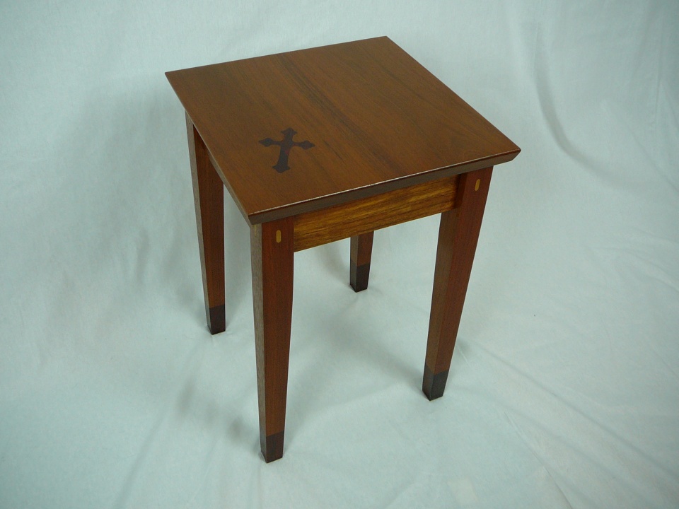

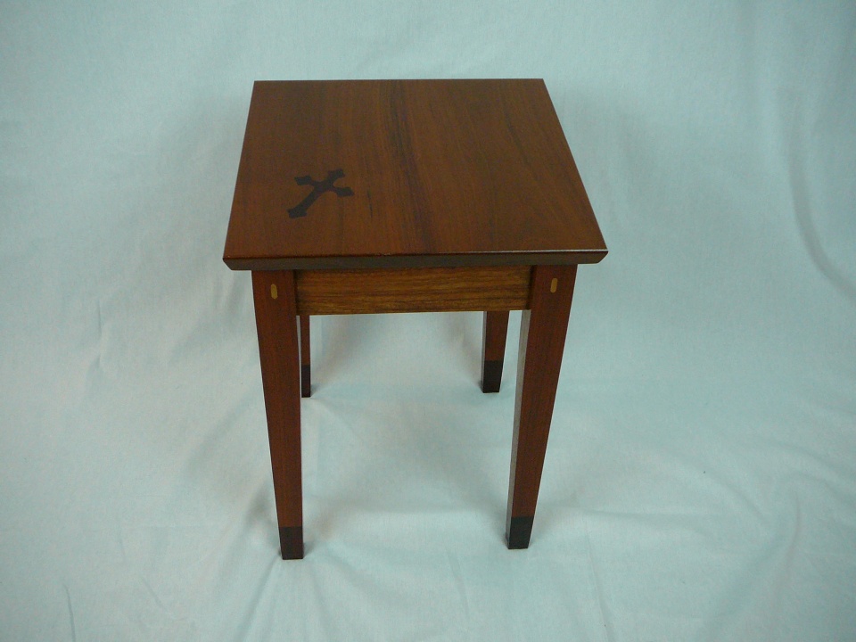

Here is a picture I took with with the ISO at 100 and the W Balance set to Cloudy. - still looks blue to me.

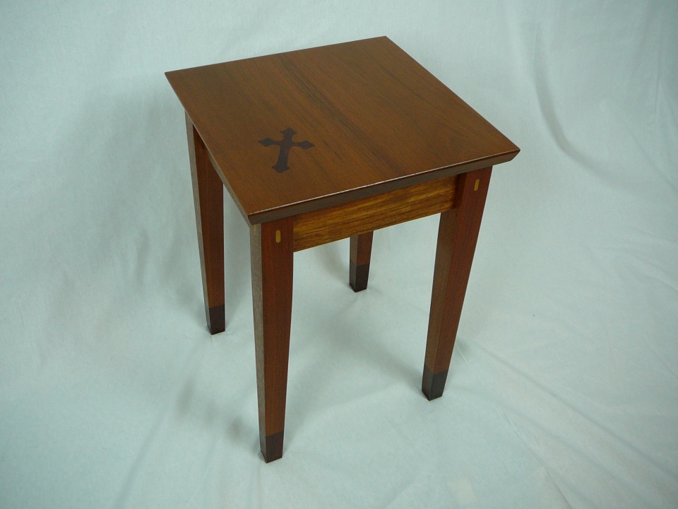

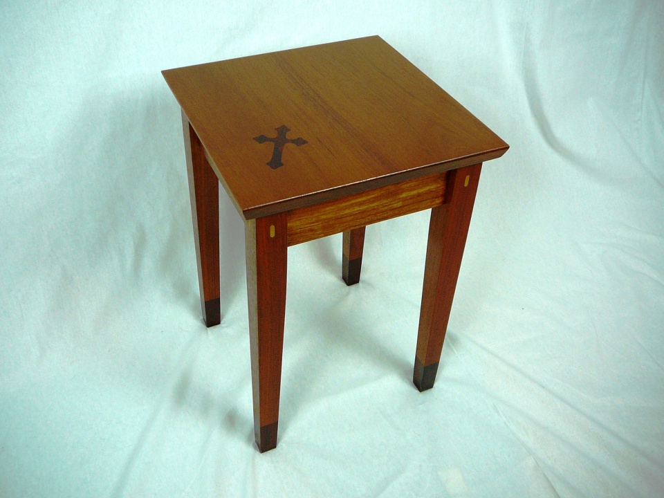

Here is that same picture from the previous post "corrected" in the photo program.
While it doesn't look that blue any more, the legs are now darker then they are in real life and the back corner of the table looks yellow while the front corner of the table is more red. In real life the whole top is similar in color, except for the dark strip in the middle.

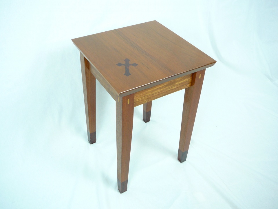

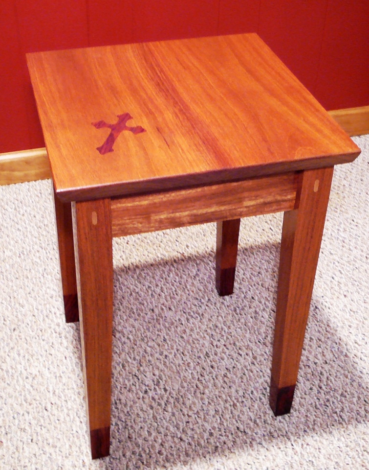

And here is a picture I took of it under the regular spot lights in my basement with a desk lamp and a regular 60watt bulb to help with the extra lighting.
I think there was some auto correction done on this too, can't remember because it was done a while. But I think this picture shows the color of the top much more how it looks in real life.
And here is a picture I took of it under the regular spot lights in my basement with a desk lamp and a regular 60watt bulb to help with the extra lighting. I think there was some auto correction done on this too, can't remember because it was done a while. But I think this picture shows the color of the top much more how it looks in real life.
the top looks nice in the light but the front looks odd.
Does your camera allow overexposure? You can see that when the sensors pick up a varied background (how they are programmed) the exposure is much better. The white backdrop confuses it. I use a white lightbox for pens and typically have to overexpose +1.3 to +1.5 stops. If you can do it, try for at least +1 stop overexposure.
It appears that your images are underexposed. The background you purchased is white and it is recording as blue/grey. The standard for photographic exposure is 18% grey. The camera is dumb it does not know what is in front of it. Unless you get into really high end cameras that have scene control. Put something that is white in front of it it is going to calculate the exposure to make it grey. Put up a black cloth and it will try and overexpose and make it grey. Back in the old days we would have a grey card and used it to take our exposure settings This all being said you need to adjust the exposure. In this case add about 1.5 to 2 stops of exposure from what the camera says to bring up the shadows. You also have a focus problem. To get the most depth of field you have to use the smallest f-stop possible. It is the highest number seams kind of backward but it works. Put the camera in manual mode. Set the highest f-stop you can then adjust the exposure time for the correct exposure. Those CLFs are not that bright in terms of lumens produced. So your exposure time may get down to as long as a second or two. You will need a tripod to hold the camera steady.

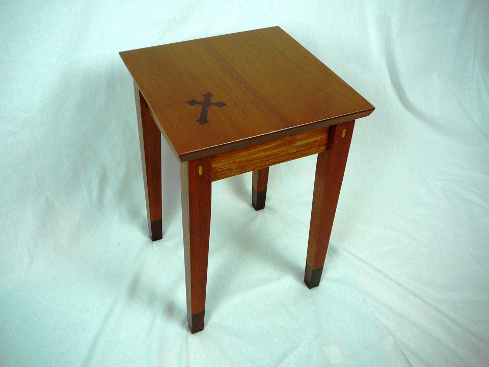

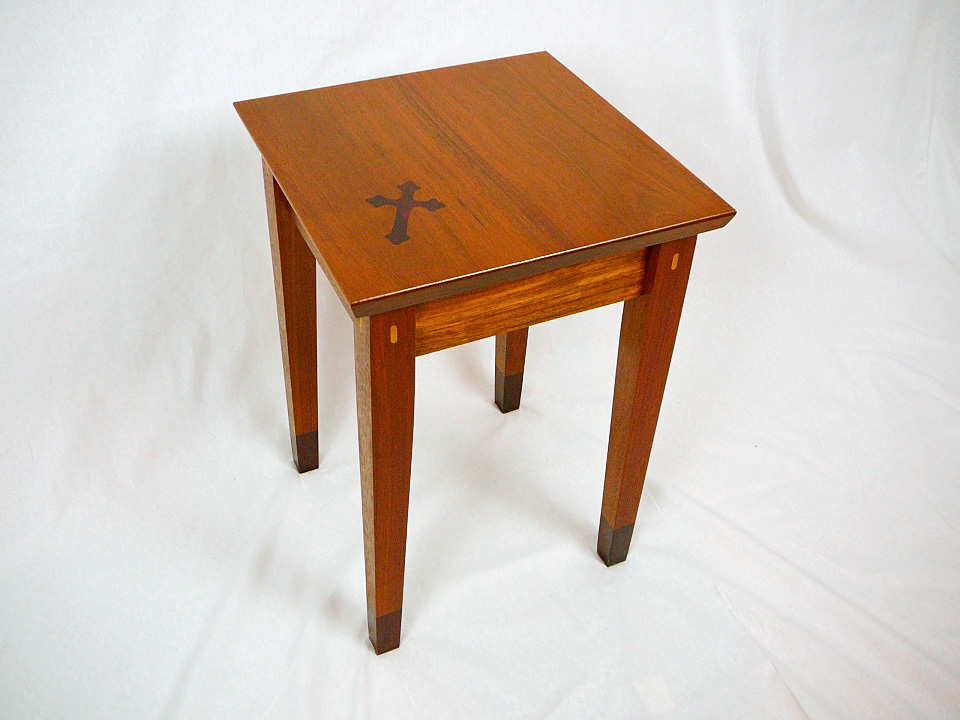

The camera is underexposing your photo. It's doesn't know that the background is supposed to be white, and is trying to make it gray. I did a little tweaking on the photo, which produced this:
attachment.php
The major changes are that I adjusted the white balance some (raised the color temperature and shifted the tone towards magenta) and I increased the exposure by one full f-stop. I think the photo is better, but it would be better still if you made the adjustments in-camera. If your camera permits manual exposure, check what it used and either increase the aperture by 1 f-stop (lower numbers represent larger apertures), or double the exposure time (halve the shutter speed). If you can't set the exposure manually, look for an "exposure compensation", or "EV" setting. Set it to +1.0 EV (which will increase exposure by 1 f-stop). In the absence of that control, look for a "back lit scene" mode. That will tell the camera to expose the photo for the central subject, not the surroundings. You may find that proper exposure helps with the white balance. If not, try the "shade" white balance setting (but I suspect that may be too much).
I hope that helps,
Eric

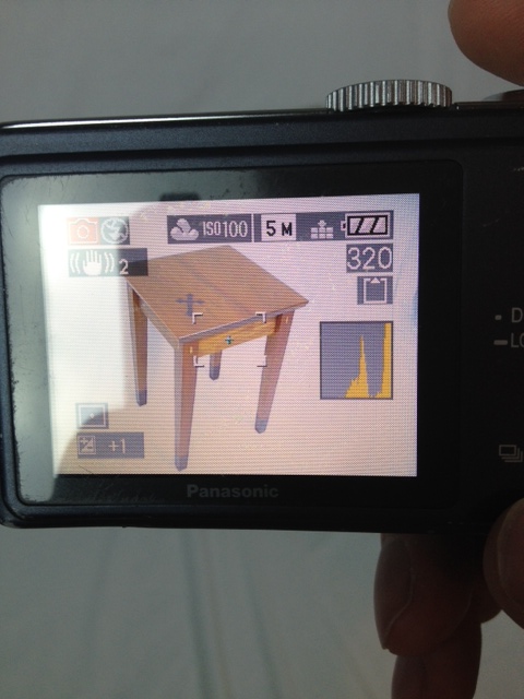

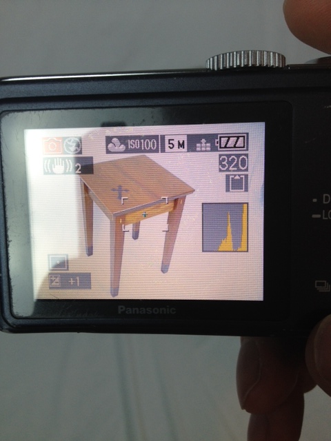

The camera has a little histogram that is supposed to check the exposure. Should I just ignore that... Cause I'm not really sure what that is really telling me
A histogram is a graph that shows how many pixels are how bright. A high value on the left indicates lots of black or dark tones. It typically indicates underexposure. A peak on the right means large bright areas and often implies overexposure.
Your photo, however, has no really dark areas - just midtones and lots of white background. Therefore, the histogram should show low values on the left, a bulge in the middle, and a spike at the right edge.

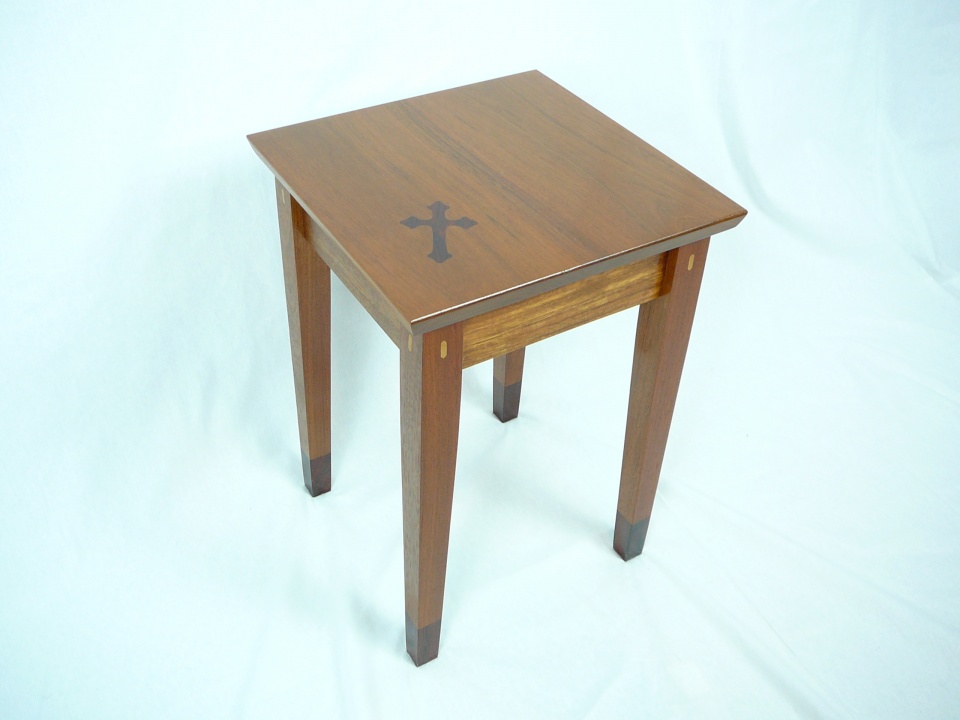

Here is a picture +1 exposure. I feel like it might be too white, but it is certainly not blue. And a picture of how the history gram on my camera looks just before I take it.
