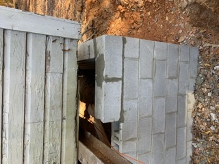

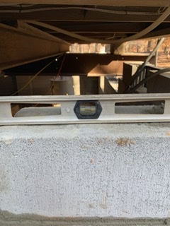

A friend is moving a house - not a modular. The way it's done is footings are poured. The house is moved over the footing and jacked up. Foundation is built, the house is then lowered onto it. The foundation was completed a few weeks ago. He called the moving company about 2 weeks to get the house lowered. they said they could either come today or "sometime next month" so he had to scramble to be ready.
I spent most of last week installing sill plates and figuring out what shimming was needed for the 3 different heights of band joists this house has. Whatever the previous foundation was it wasn't a full perimeter.
I also did a bit of masonry. We had to remove a few blocks to make room for the steel beams the house is on to be lowered. Near one corner a couple extra blocks came loose
