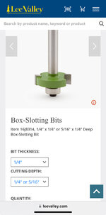

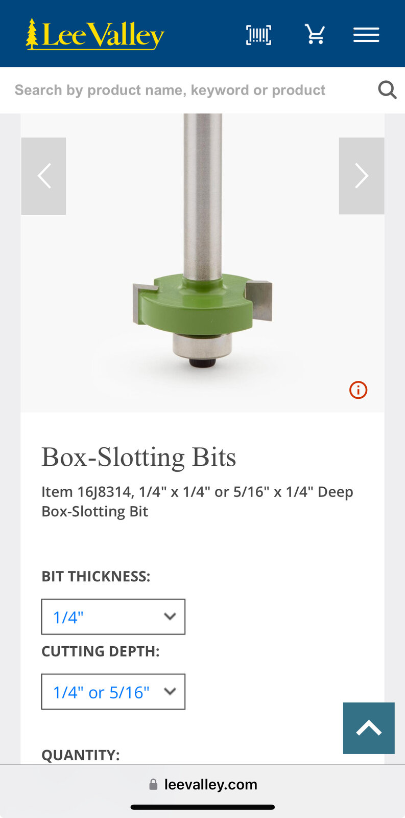

I use one of these whenever I am making a finger joint box, to cut a slot for a box bottom. You just have to put a radius on the corners of the bottom. Works very well and was designed for just this purpose.

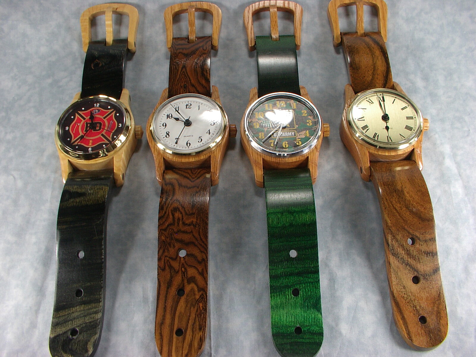

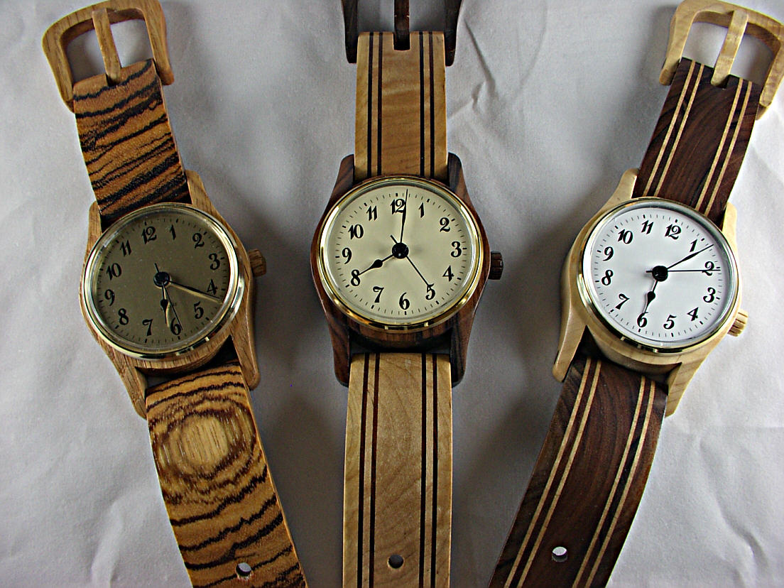

Man I clicked on the link above and noticed an old friend of mine. The wrist watch pattern from Wood Magazine from many many years ago. This is what got me started making those things and what a success they were. Sold many of these watches over the years. I had one lady buy 5 at one show I was at. She thought they were so cool.
There are actually some very nice plans in that link for woodworking projects. A nice tablesaw sled and more.

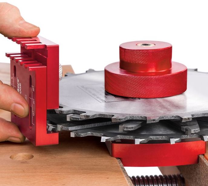

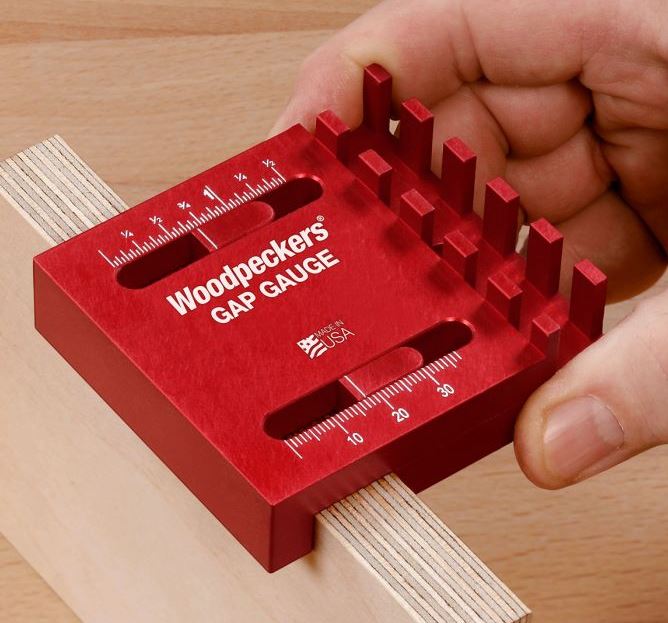

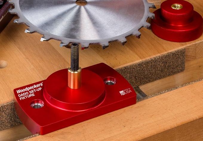

I have always had problems with getting box joints to fit so a couple of years ago I jumped on one of the Woodpeckers "One Time Tool" offerings which included a regular and mini Gap Gauge and a Dado set-up fixture. Set the wood thickness on the Gap Gauge and use the Dado set-up to build the stack of blades and shims.
I haven't used it much, but it does provide a unique method of making precision setups empirically without needing to make physical measurements. Empirical measuring has always worked out for me better than anything.
Good Luck. - Dave
