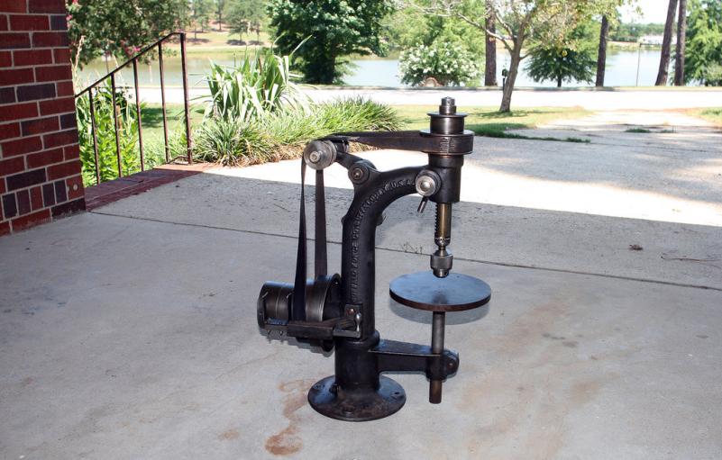

Good quality stuff now day's is not cheap nor easy to find by no means. I would suggest save up the money and spend it wisely on quality equipment that is built to last and will stand the test of time. The pain and nasty scars of using a sub par tool reeks longer than the time it takes to save up for the quality one. Until then you could drill on the lathe.
