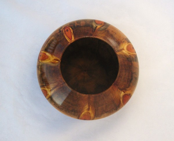

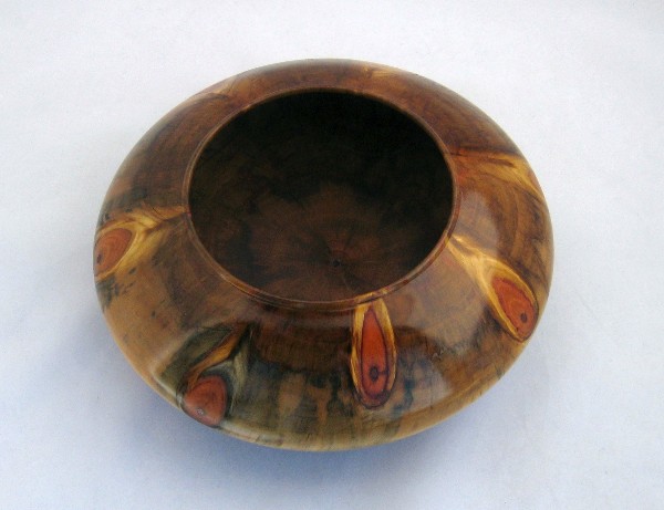

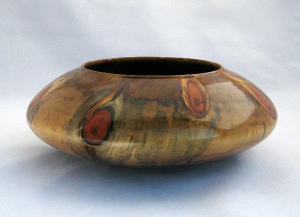

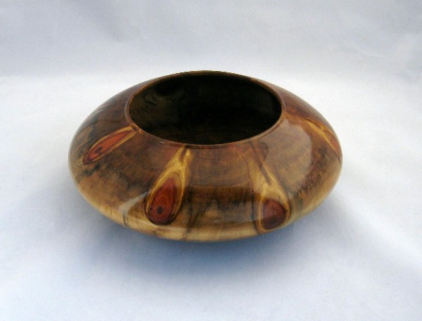

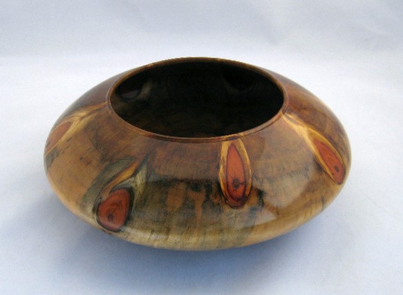

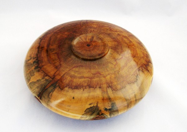

My first NIP hollow form came out with a wider opening than initially planned due to my eagerness to finish after rough hollowing. I had to take some cracks away but am happy with the final product. The grain and color are exceptional IMHO. Got the blank from Woodturningblanks4u.com.

Gorgeous.
Like Monty, I have a piece of NIP I have been waiting to turn. I've been building my pen inventory for the last month and half for an upcoming show, but seeing the beautiful work you did makes me want to go back to bowl turning.
Really beautiful. Thx for sharing.

Yeah Glenn, me likes it...!:wink:
In fact, one of my preferred shapes for NIP turning, the 7 knots are exceptional and the "bluing" only adds to the good looks. Great finish also...!

Glenn,
Those are fantastic... How is the NIP to turn... I have 3 logs about12 to 18" long each that I picked up from my local wood importer... they were in plastic to spalt for about 6 months and I just took them out to dry a little before I put them on the lathe... sure hope I do as well as you did.

It turns beautifully, soft enough to make hollowing out easier. Make sure you let is dry rough hollowed for a good period of time, I waited about a month...too soon. wait a few months oe soak it in denatured alcohol or whatever your preferred way of drying is.
Also, if you turn it thin (1/8" or less, check often for tear outs around the knots or use CA on them before you get too thin. I had one spot I had to fill, luckily I caught it before it caught me.

Great bowl Glenn! Bring it to a BAW ot IAP meeting. I'd love to see it. What did you use for a finish looks shiny!
