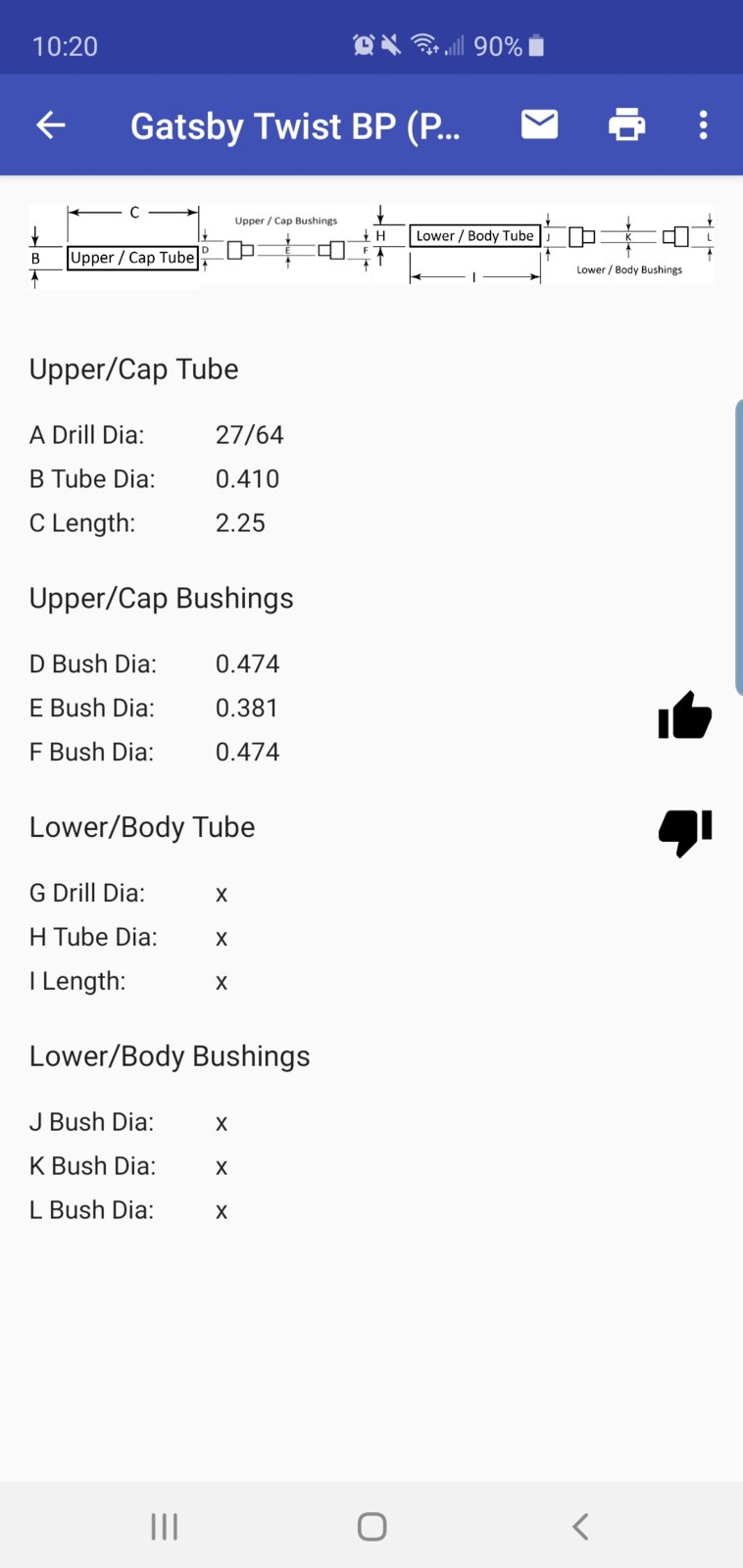

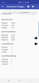

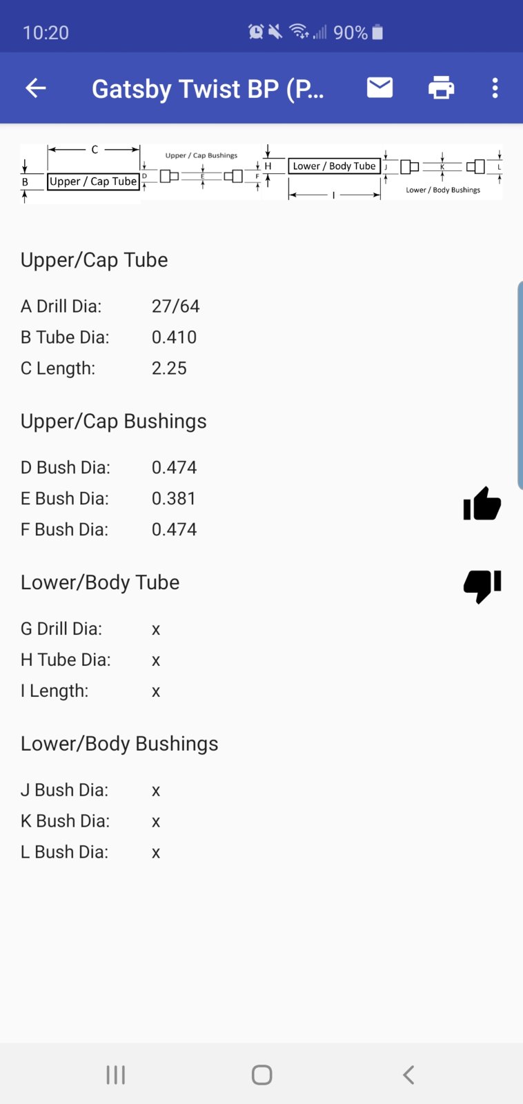

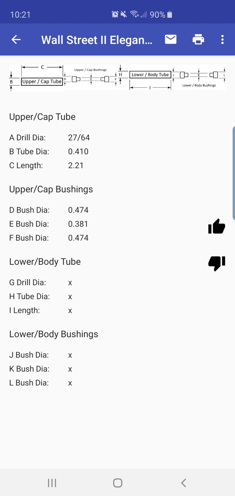

There is an IAP bushing app that is amazing and would have the answer for you. It is in the resources section. I've attached a screenshot of the gatsby twist (psi) and the wallstreet II. There are multiple types of these pens so I'd recommend verifying I picked the right styles via the app. Hope this helps

Just found it and installed -- going through it now..... so far they are the same...... fingers crossed....

According to the IAP app, they take the same bushings, 0.474 inches. I highly recommend the $0.99 IAP app for iPhone and Android.
