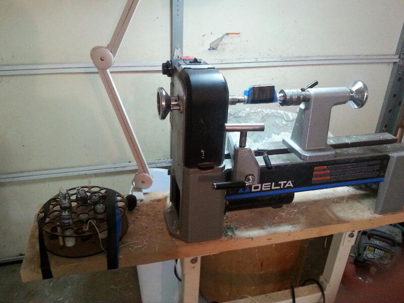

My pressure pot was unavailable for the last few days (my local maker space is moving to much nicer digs) and I have a deadline.
Turned my lathe bench into a variable speed vibration table. The speed control adjusts from gentle waves to bounce-the-molds-out-of-the-pen-studio. I had to fasten the mold-holder to the bench so it wouldn't fly off.
