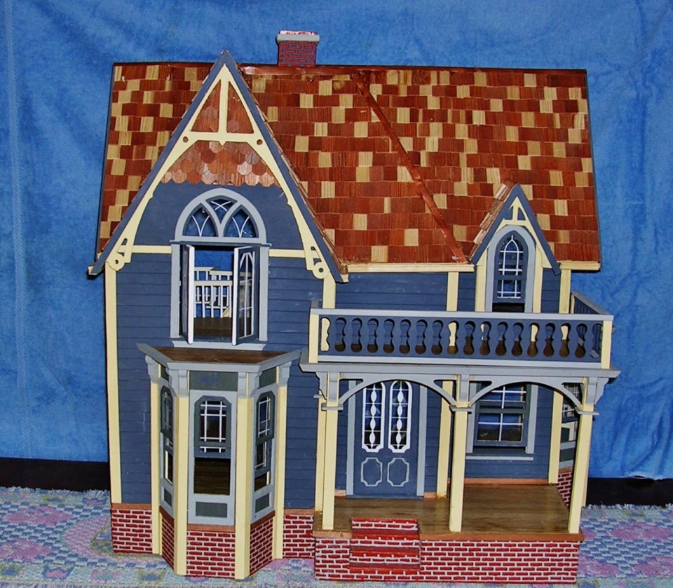

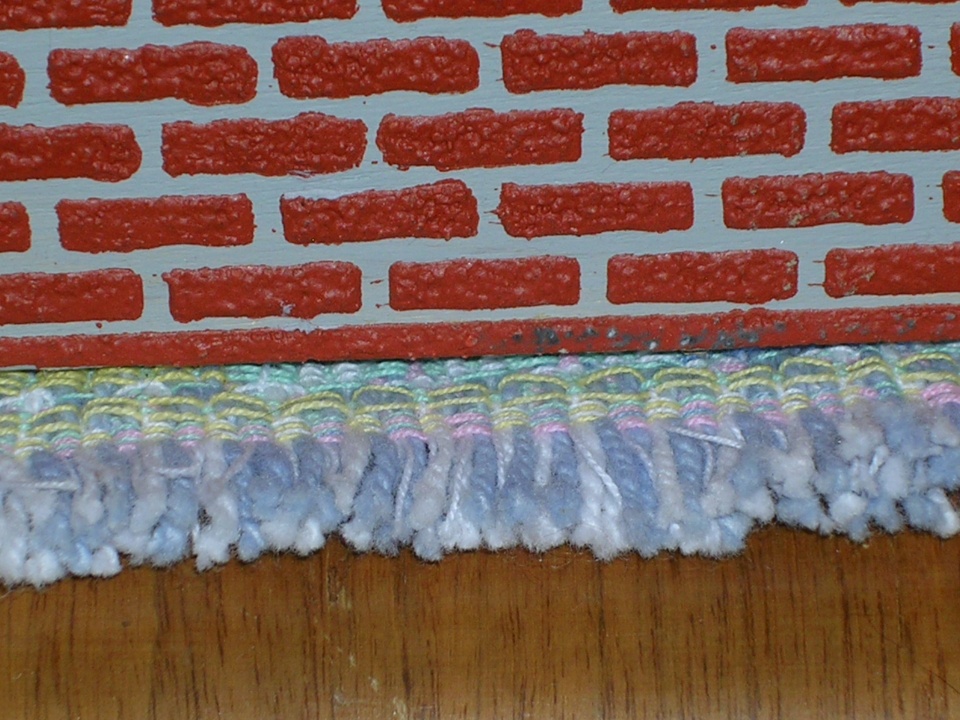

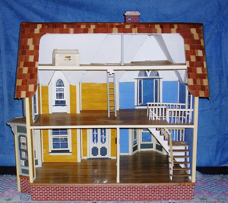

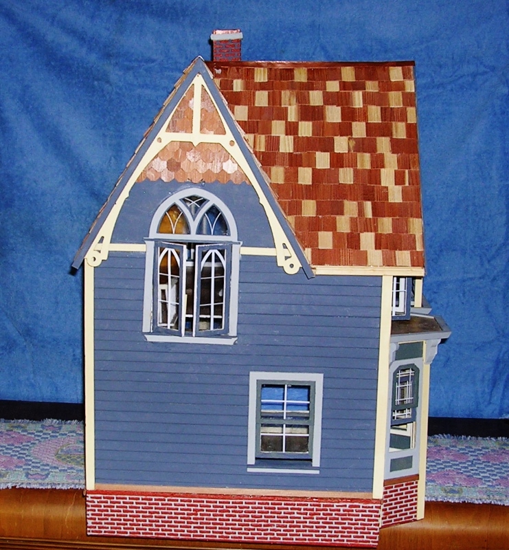

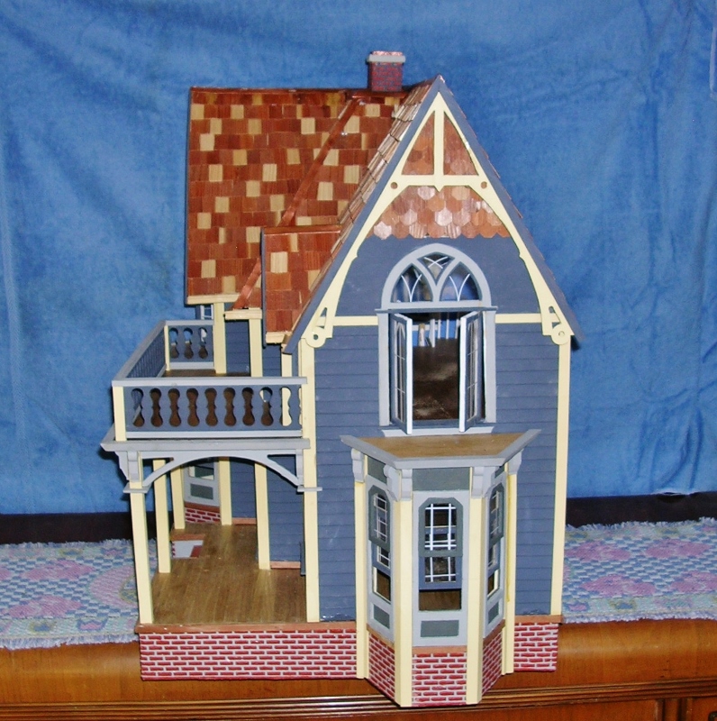

As you may or may not have noticed, I haven't posted any new pens since the first of the year, no have I enter any contests as of late. I have been working on several projects that I have been putting off starting, or ones that needed to be finished. This was one of those projects. It is a 1' to 1" scale model of a 19th Century Victorian 6 room house complete with opening doors, windows, staircase, attic, and drop down ladder. The front and sides are made with tongue and groove (1 1/16" ) pine with 3 laps molded into each peice. The floors are real oak planks bandsawn down to the desired thickness. All lower sash windows move up and down, and French and main doors open. Foundation walls are made of real brick using a mixture of water, Tacky Glue, and ground bricks, Shakes are glued and shaped one at a time, then glued on. Copper roof panels were hand formed, and wooden gutters added. All original colors of the day were used. This is one of four I am working on along with scale furnishings and lighting to be added later. Hope you enjoy !! Jim S

WOW, that looks like a lot of work. Very cool. Is this for someone?
Thanks Bob; This grandaughter has had her eyes on it since I started building it. She has a round cafe table in her room at our house, so I will mount it on a turntable to make it easier to play with. Jim S
