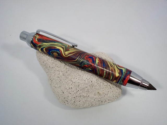

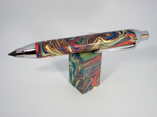

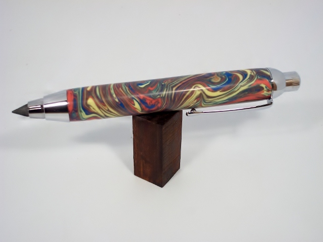

no clowns were harmed in the making of this sketch pencil, although it looked like one exploded on my lathe, not sure what its made of, i have to go look that up, but it was soft and turned like butter. was fantastic to work with, because it was soft it didn't polish up as shiny as an acrylic, but turned fast and looks and feels cool. might do a series of these.

Looks like explosion blank to me. Like what elmostro sells, and ernie at beartoothwoods. I turned a red & white one, the finish on yours looks like the finish on mine. JMO though.
You done a great job on yours, looks good with the hardware.
They turn like butter, but for the life of me, cant figure out what its made of.
To me, when im turning one, almost smells like an auto body shop to me, but i just cant place that smell. It's not a bad smell though.
was thinking the same thing harry. the site i buy from says acrylic, but i've turned many acrylics, and they are hard and have a tendency to chatter. this is softer. but i like it
Is it my sniffer or does smell like a body shop, where they use the auto body filler.
Now it's been awhile since i have been in a body shop, but that was the first thing that came to mind when i smelled it.
Great pen. Actually, I just turned a alumilite blank, from jeff powell. And I turned it carefully with a skew at the end, so there wasnt any stratches. Then went straight to micro mesh. I was pretty rough withthe first 3 pads, and then a couple plastic polishes. It turned out as shiny as all the other acrylic pens I make.
Looks great!
As far as I know, ElMostro has always done Alumilite which could fall under the umbrella of acrylic. Most of the time you can get a decent shine out of Alumilite, but if you do run into one that just won't shine up for you, you can always top it with a CA finish for a brilliant shine.

Not sure what the pen is made of, but I turned alumilite once, and I thought the smell reminded me of primer!
Great looking pen though. I may have to look into those blanks.
Woaa, I almost missed this one. That is a beautiful pencil and the kit really shows off the blank. The blank is from my "Color Explosion" line and it was what I came up with while attempting to duplicate "Fordite" (http://www.fordite.com/). The blanks are made of alumilite with several types of dyes and pigments. The best way to finish this blank is once you are done turning wet sand with MM with the lathe running at high speed, (start with whatever grit removes all the tool marks for you, I start at 3600) before you move to the next grit, stop the lathe and sand lengthwise with the same grit while hand turning the lathe then continue to wet sand up to 12000. You can also apply some Novus 2 for a final polish. The key is to make sure you start sanding with the grit that removes ALL the tool marks.

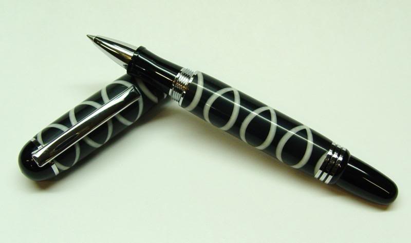

The pen below is made from the same material and was wet sanded to 12000 MM, I did not apply Novus to this one.
Again, beautiful pencil and thanks for sharing.
Eugene.
