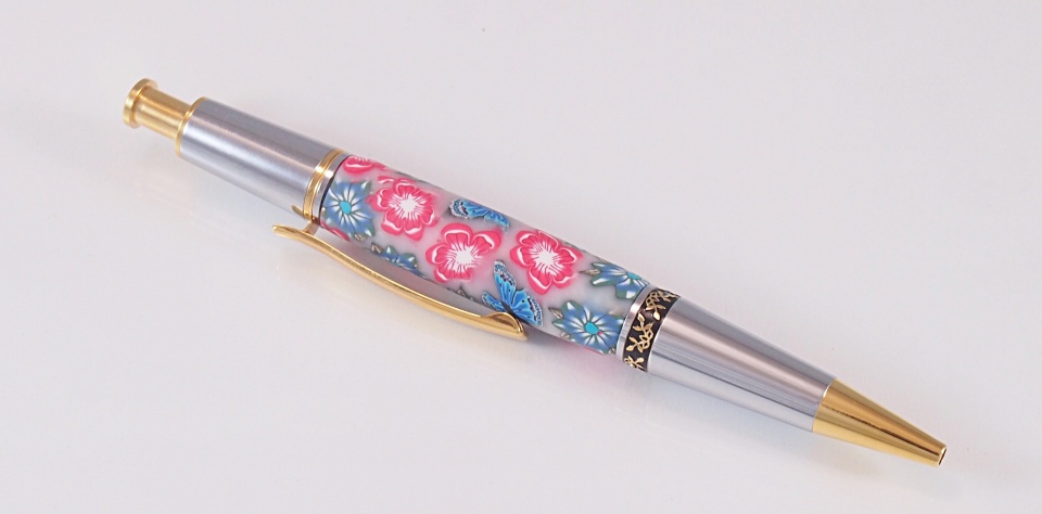

Cwalker935 Member Joined May 18, 2014 Messages 3,528 Location Richmond, Va Nov 18, 2015 #1 I figured out why my canes were turning brown, I was not preheating my toaster oven before putting in the blank. The heat was spiking during preheating and burning my canes. Aero click with pink and blue flowers and a couple of butterflies.

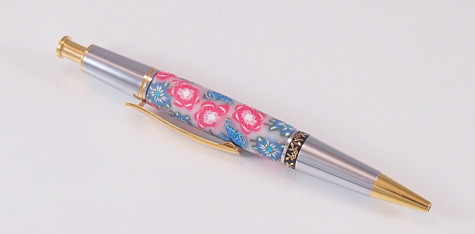

SteveJ Member Joined Jul 11, 2012 Messages 3,628 Location Grand Junction, Colorado Nov 18, 2015 #2 Well done Cody!
CREID Member Joined Jul 23, 2008 Messages 3,008 Location Vancouver, wa Nov 18, 2015 #3 That's beautiful Code. Glad you figured it out. Curt
Jim15 Member Joined Dec 20, 2005 Messages 21,710 Location Hamilton, Ohio, USA. Nov 18, 2015 #4 Wow! This one looks great.
qquake Member Joined Feb 8, 2004 Messages 5,057 Location Northern California Nov 18, 2015 #5 Very pretty!
