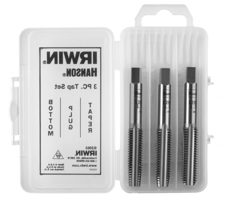

Bottom tap - Plug Tap...what is the difference...which one do I want.
Thanks for the replies.... tap tap...slight pun intended.
The difference between a bottoming tap and a plug tap is taper. A plug tap is tapered so that it more easily starts in the hole. But that means that the threading will be tapered toward the bottom of the hole. To produce uniform threading throughout the depth of the hole, a bottoming tap is used to finish the chamfered threads near the bottom of a hole after it has been threaded with a plug tap.
I would suggest always starting with a tapered plug tap - these are readily available at hardware and big box stores (and are less expensive than the bottoming tap you found).
Whether you also need a bottoming tap really depends on the material you are using. Bottoming taps are essential when threading metal, especially if the thread is to be used repeatedly. However, when threading wood bottle stoppers, threading once with a tapered tap is sufficient - the taper tends to lock the threaded stud on the stopper in the hole to prevent it from backing out with use. I don't routinely turn plastics, but I would be concerned about screwing a threaded stud into a hole in brittle plastic if thread is tapered - the additional stress as the stud approaches the bottom of the hole could crack the plastic.
Incidentally, you can also find 'tapered taps' - the difference between a tapered tap and a tapered plug tap is the amount of chamfer at the end of the tap. Plug taps taper only 3-5 threads at the bottom of the hole, while tapered taps chamfer 7-10 threads.
Thanks again for the helpful replies. Ordered a kit and handle. Will follow up.
I did not see on the box the pre drill size, often it is found on the tap itself, I wouldn't vary from what is written for the pre drill size, no matter how odd the size may seem. I have some standard British small and Wentworth taps that list predrill with fractions of millimeters (I.e 8.6 mm drill). If your predrill is bigger the listed on the tap it may be easy to do but not enough thread will be made. Agree with monofoto, always go with taper then if you want to clean it out more use the plug or else we risk the material trying to get out will build up pressure at the bottom and fracture your hard work, risk also depending on amount of fluting for material escape. Good luck. Let's see how it'll "turn out"( my favorite penmaking pun, I like you tap tap too!)
