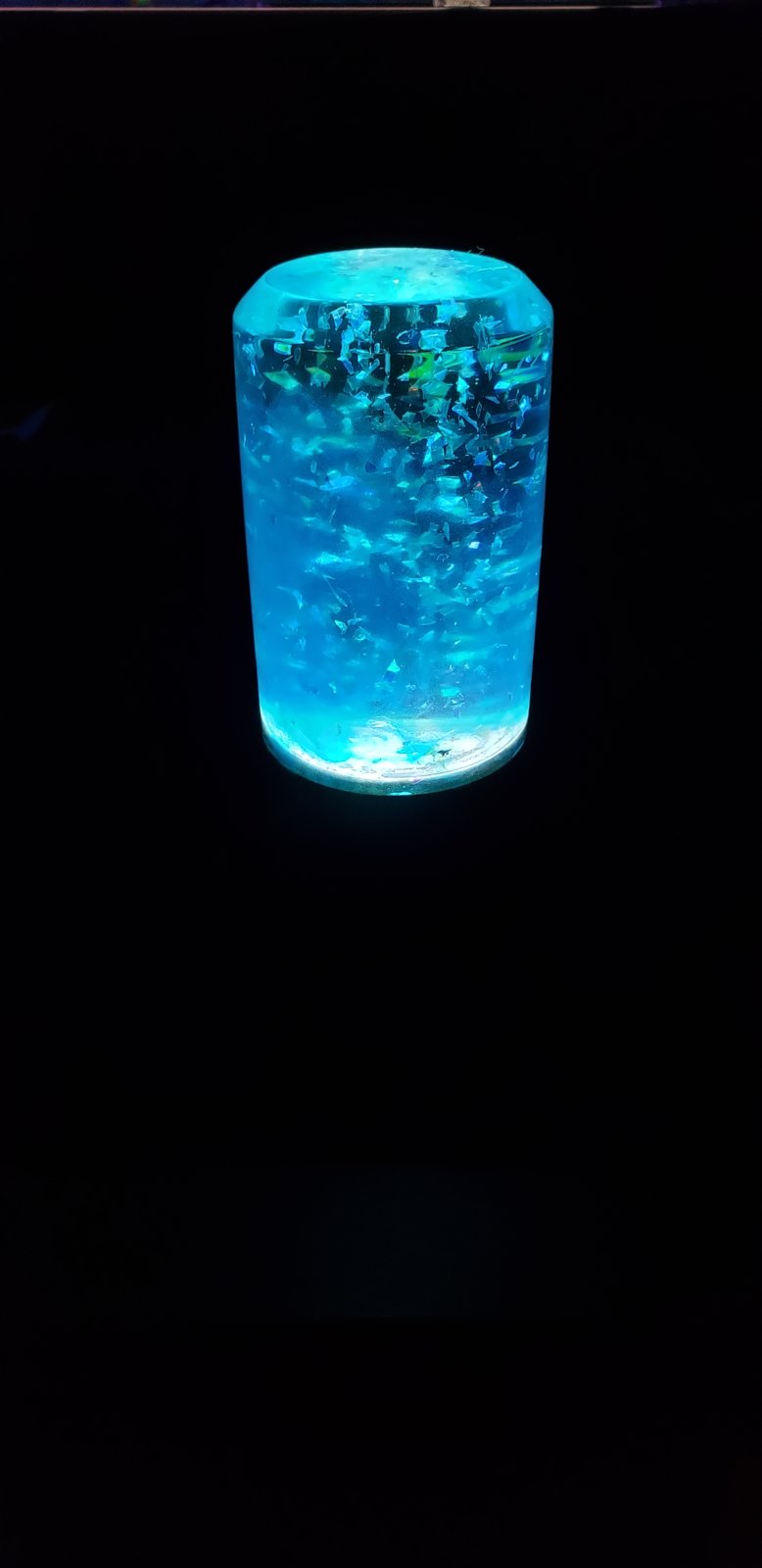

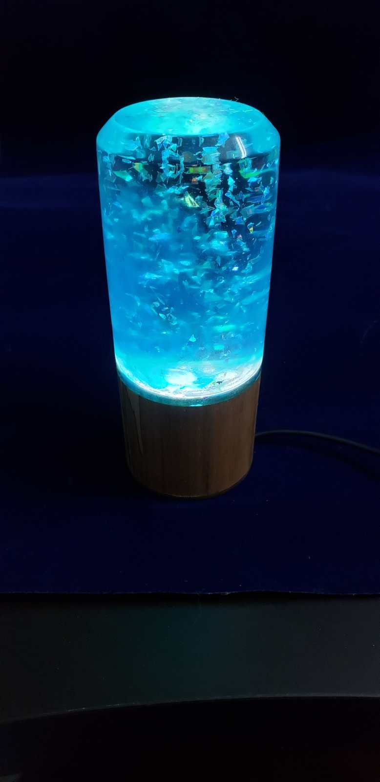

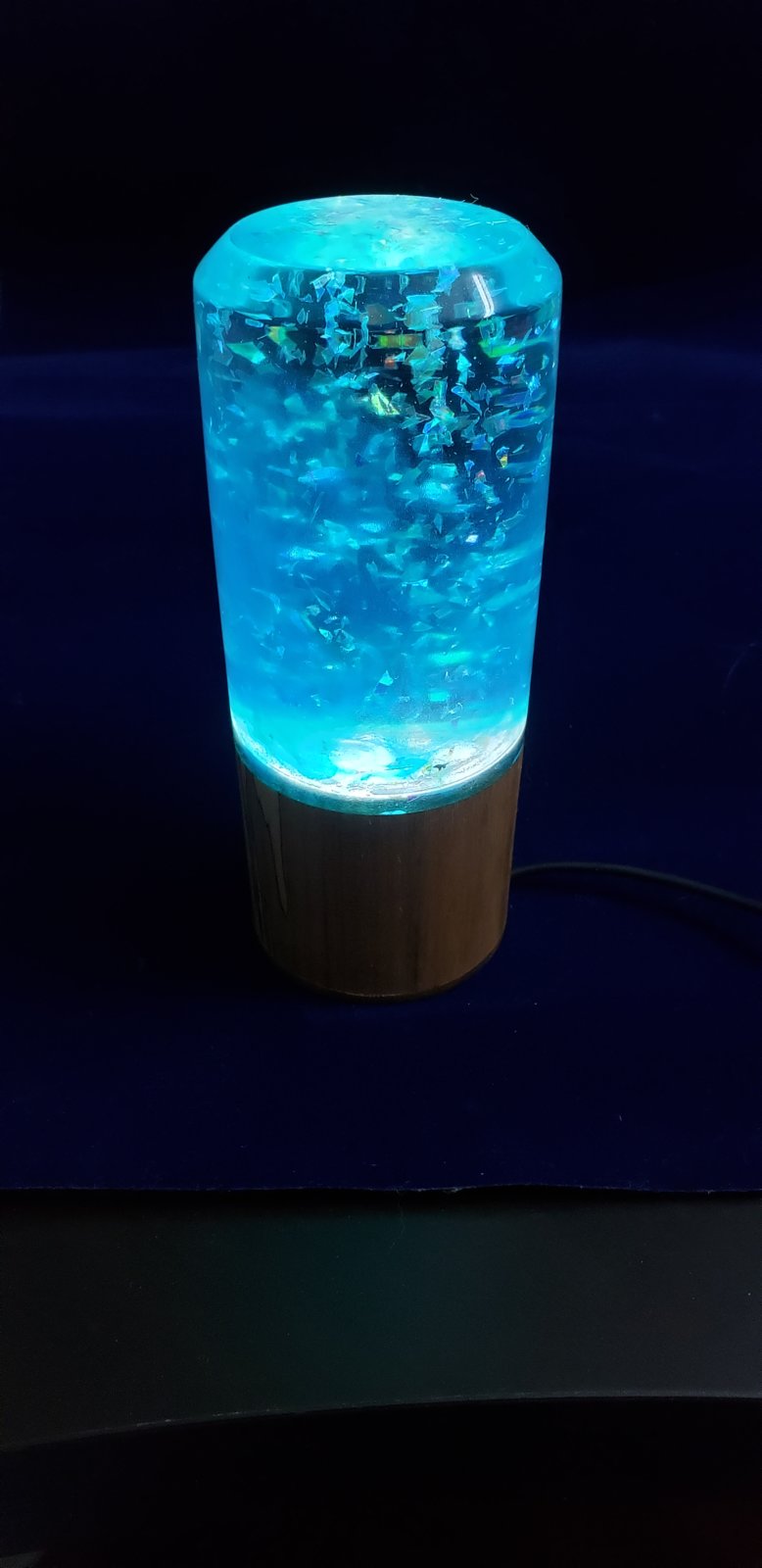

This is one of several that I have made but the first one that I turned on my lathe. These are fun and it's great to see the kids (and adults) faces when the plug them in!

I just realized that the image makes it look like the finish no complete on the lower 2/3 but that is the color "clouds" inside the resin. The finish is clear as glass.
I'm intrigued as to how and if you integrate the lights into the resin or below it to light through it?
Any clues?
@howsitwork You are living up to your name, LOL.
The light is below the resin. I cast the resin and the wood base together, then hollow out the base. I turned a thin walnut cap that covers the bottom and has the LED mounted on it. I glue that to the bottom of the base to close it all up.
