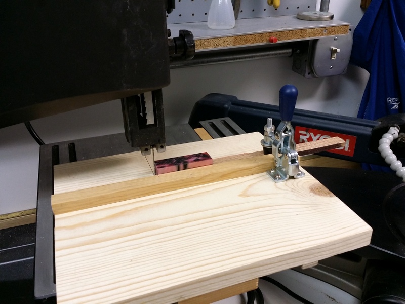

Lots of ways to cut blanks. Here is my way. My often denigrated HF 9" band saw. Works perfectly, safe, accurate and quick. And not to mention CHEAP.
I cut my blanks on an old benchtop Craftsman 10" bandsaw with a setup similar to Rocky's.
