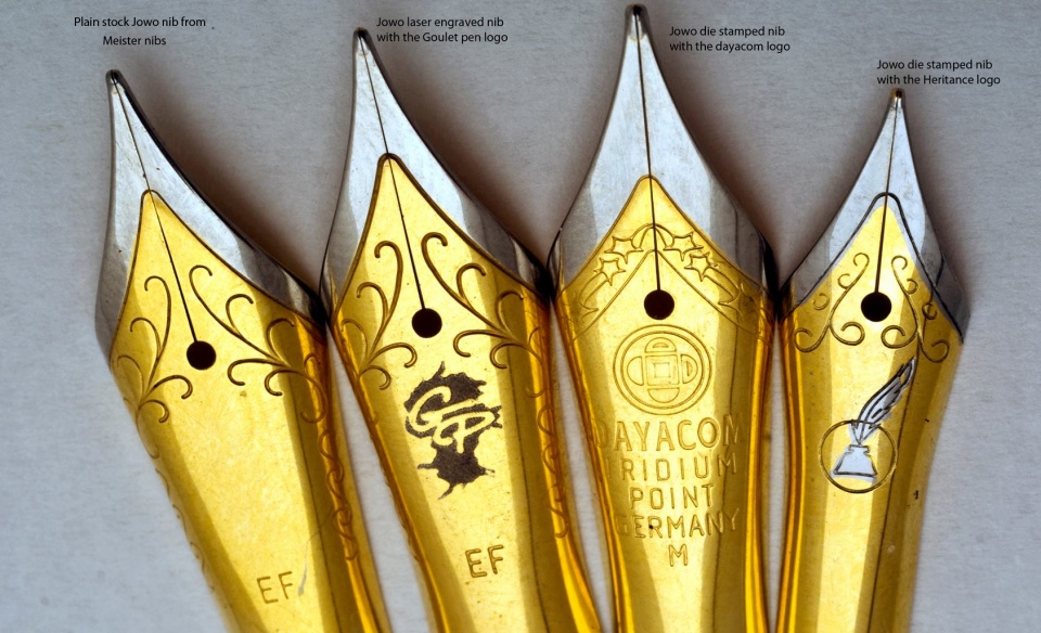

One thing overlooked by everyone, or perhaps it's the white elephant in the room... "higher quality nib" has been overlooked up to this post.

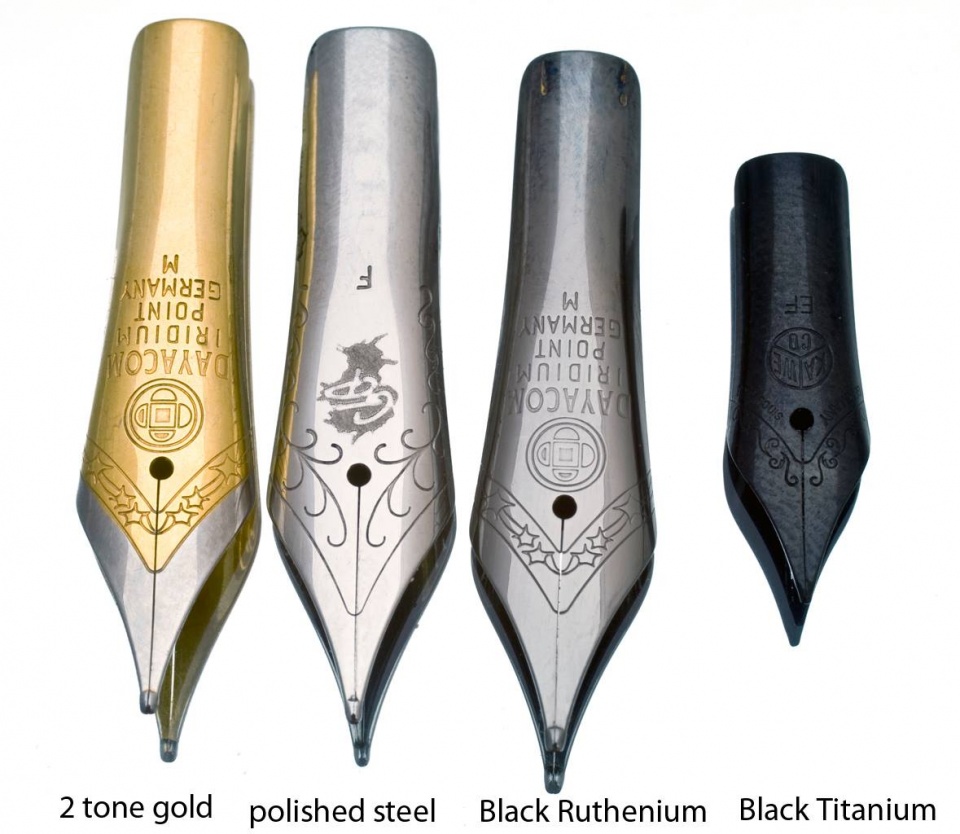

Having said that I have brought up a good number of times, on this forum, that Dayacom uses Jowo nibs. They have for a hefty number of years now. 'upgrades' for nibs could be done for a number of reasons. One of those reasons is plating color to match the blank or flow with something else, i.e. steel, 2 tone, black Ti, Ruthenium and the dozen other plating types you can get on nibs today. As for 'quality' goes some will have you believe that heritance nibs are 'higher quality' which is simply untrue. They are made in the same factory, same plant, same company as the rest of Jowo products, including the ones that ships with the Aarons from Classic Nib.
When someone orders custom nibs (i.e. heritance) from either Bock or Jowo they are incurred with a good hefty $20,000 minimum order. In order to sell the product many will list them as "high quality upgrades" and tend to down play the stock nib; disregarding the fact that both nibs are made by the same company, same labor force, same factory, same materials and same manufacturing methods..
One thing that is almost always overlooked when any discussion of 'quality' comes up here is the subject of 'quality' is highly subjective to the application. Meaning what may be quality for one task could very well not be quality for another task.

Ed brings up a very good point in his last paragraph...quality of a nib is very, very subjective. Spend some time on the fountain pen network, especially in the nibs & tines forum to see how folks differ on what is a quality nib. It's almost like reading what wine connoisseurs write about wines. If it writes smoothly, doesn't skip, and doesn't dry out, it's probably a quality nib. I think a number of kits come with nibs made by Jowo, and they are quality nibs.

So the question is can one turn a nib, like the ones pictured in Ed's post into a quality nib? would this be acceptable?

Now I agree With Ed about some nibs being made by the same people, but as with all manufacturers Building specs and tolerances will vary, depending on the order. While some may market the same product with another name, others will order different specifications for that product. Personally I've found the heritance nib to be smoother, this could be because of additional grinding when being finished.
After talking extensively with Linda Kennedy about nibs, nib quality, nib metal, bid design and nib grinding I can say that yes you can turn any ugly duckling into a graceful swan, the question remains is how much work are you willing to spend to make that happen. How much is your time worth. For most the answer is two fold. 1) not skilled enough to pull off the job and 2) to busy doing other things to do the full job when a nib swap out is easier.
I can tell you to that a Heritance nib grinds exactly like a Jowo nib, as does a dayacom branded nib. The only valid point that could be given is metal flow when stamped and yes the Heritance nibs were a custom run stamped order. As for ink flow the underside drag, tine width, how clean the tines are and he feed to nib fit ratio makes the difference.
