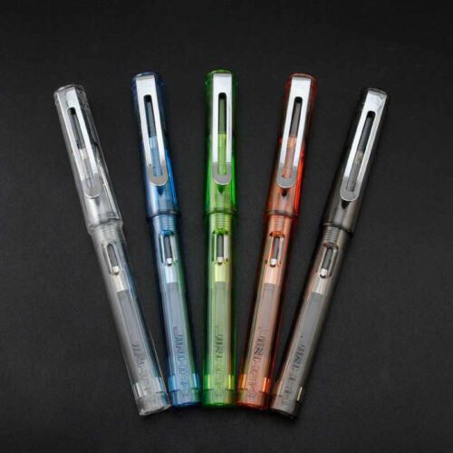

These are the ones that I use for practice - under $2 each ... LINK ... as Louie says, look at them sideways and the plastic will break, but they are great for mangling and repairing the nibs. I have at least one in regular daily use - alongside my $600 Parker Duofold and a pen I made myself that has a JoWo #6 medium nib.
The other thing you will find very helpful is a 10x jewellers' loupe. Richard Binder recommends the Belomo Triplet 10x
