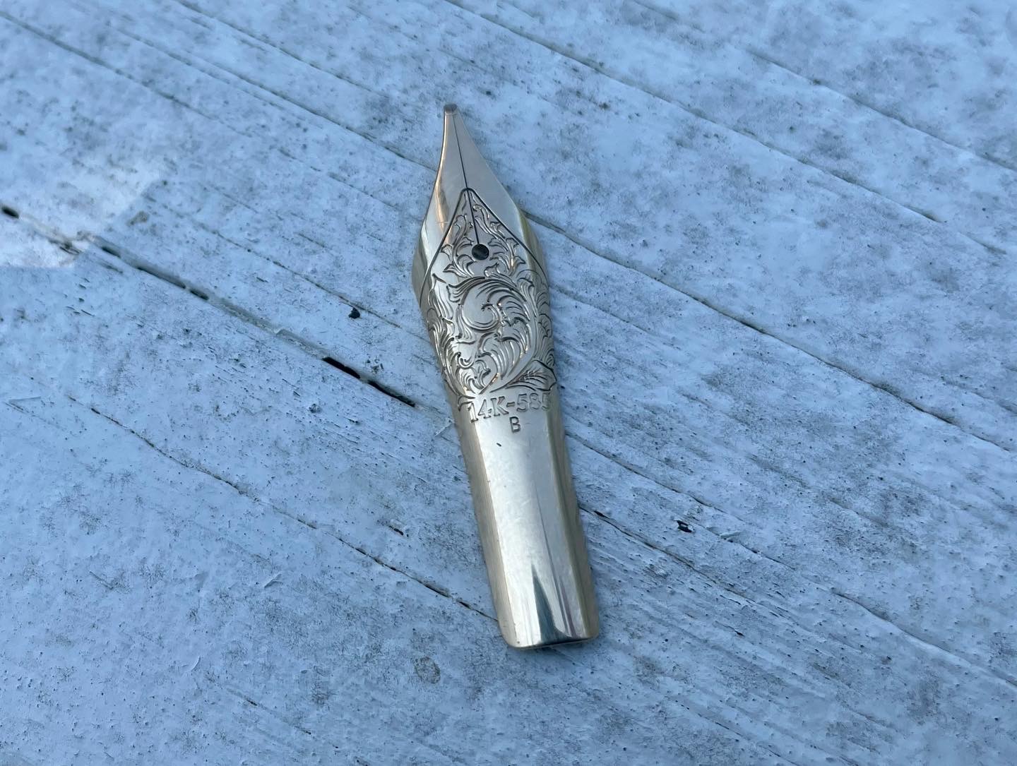

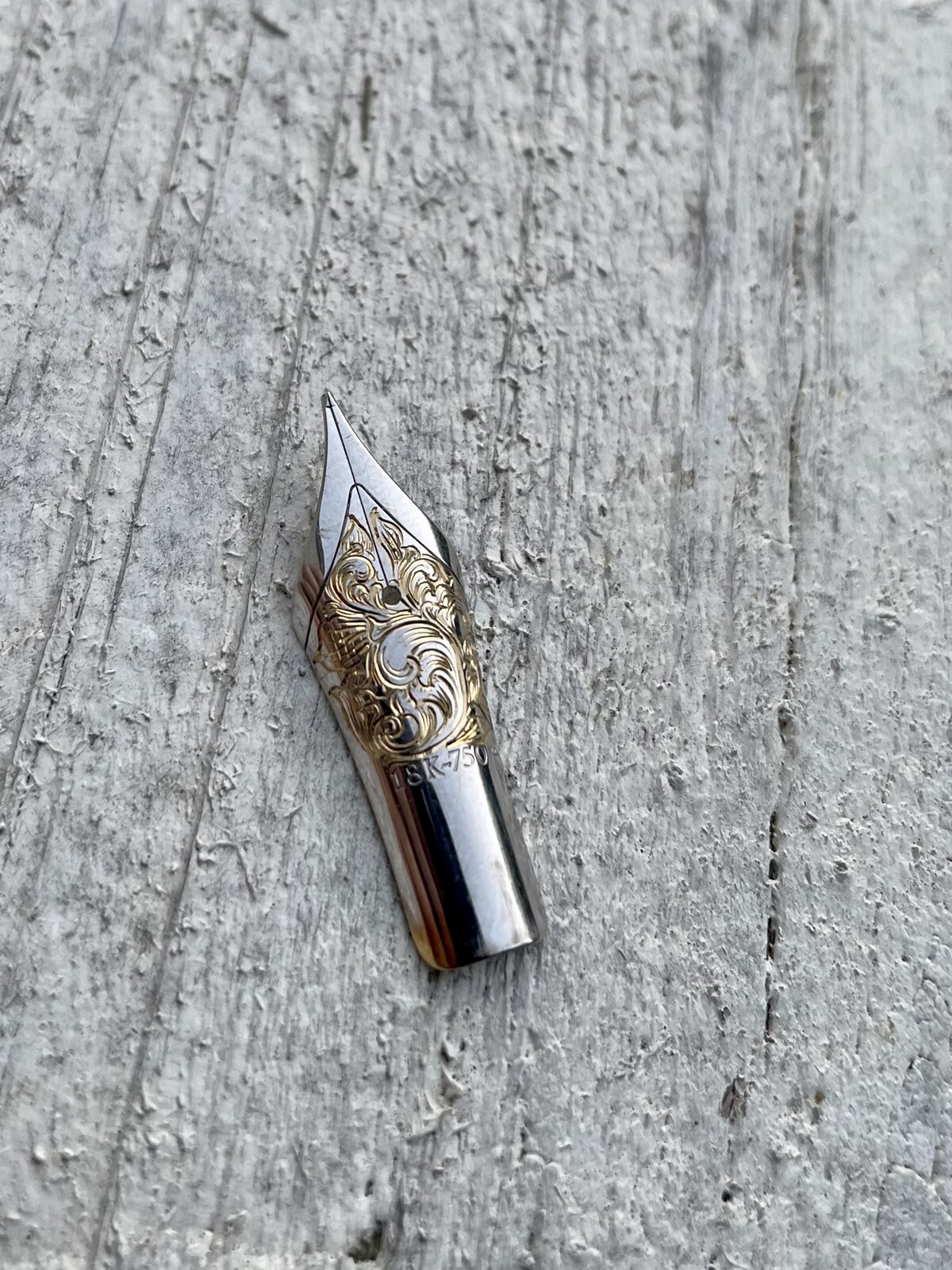

I wasn't really sure where to post this, but this was a little project I did this weekend for fun. I had a 14k gold Jowo #6 nib unit laying around, who was devoid of any markings. I thought it would be neat to hand engrave it and embellish it with a little decorative scroll work. The tricky part was working on a very tiny, curved surface. I thought this was a fun way to personalize my nib.

I like it. On my phone, before enlarging, it looked like a big gob of solder or something. Thought you may gouged a hole in it. LOL. But, then I enlarged and saw the wonderful detail.

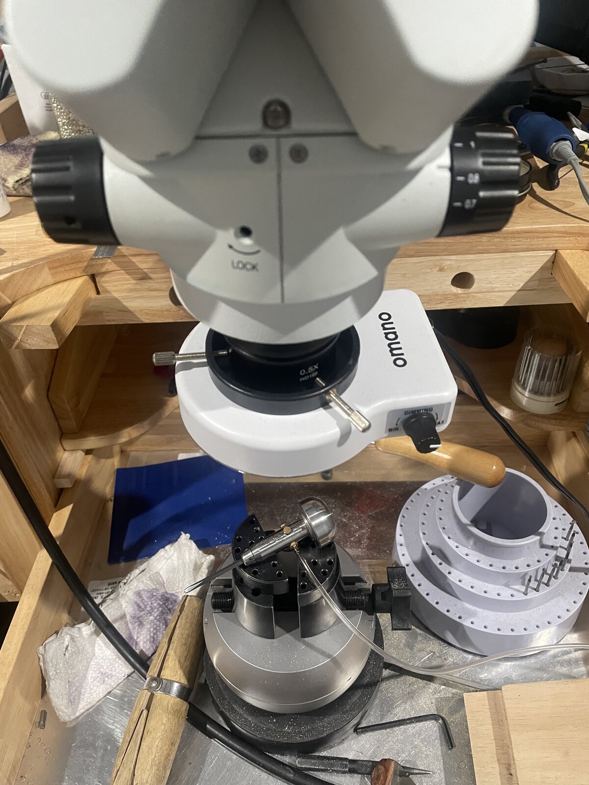

Something makes me think you used a micro grinding tip (carbide?) but I don't think you did that entirely by freehand. However, you may have. If done by machine, how did you get the machine to recognize the varying curvatures at different points?
I do remember a former post in which you mentioned you spent some time in metallurgy(?) classes. It sure has paid off for you! Thank you for posting your work!
jalbert
May 17, 2015
993
Louisville, KY
Nope, all freehand! Pictured is my pneumatic hand piece and graver, engravers vice, and stereo microscope that I use to see small details.

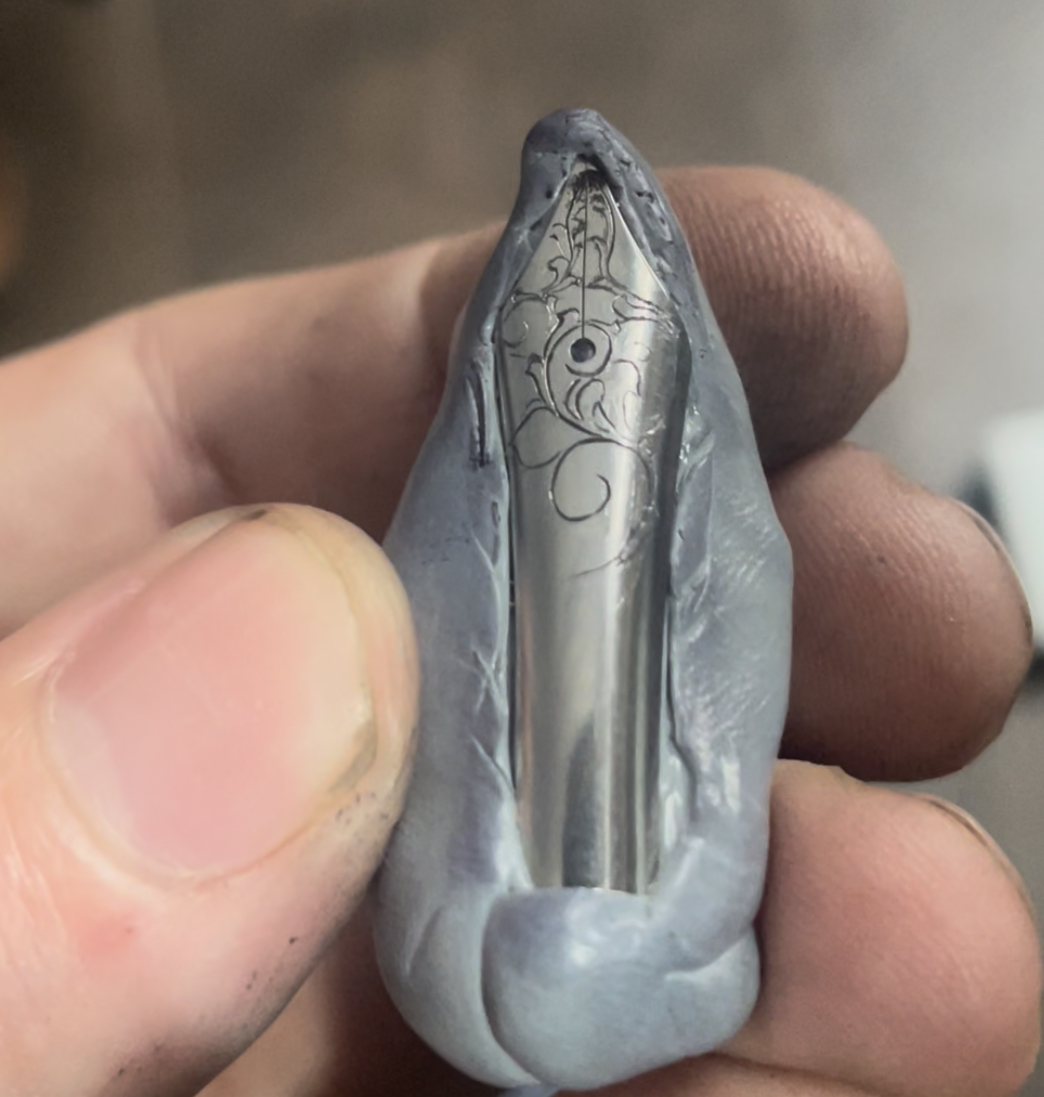

Does the engraving affect the feed at all? Do you have to make some adjustment on the feed where the engraving is so close to the feed wall?
The gold does look great as it comes through!
jalbert
May 17, 2015
993
Louisville, KY
As in the graver deforming the nib where it meets the feed under the nib? No, I use a thermoplastic that is molded underneath and around the nib, so it's supported and I can hold it in my vice .
