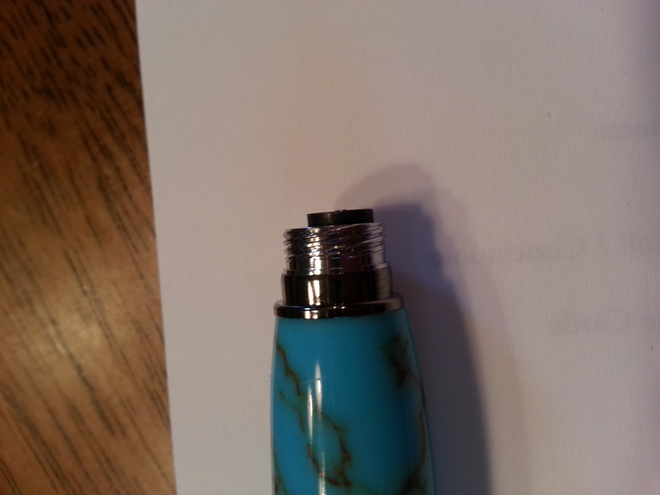

It will push against the spring to create a bit of give when writing, but it usually takes a heavy hand to push it very far. Could have the wrong spring. Let's see a picture of the spring, or remove the rear finial - the roller cartridge should extend about 1/16th inch past the threaded coupler if you have the right length tube and correct pen assembley.

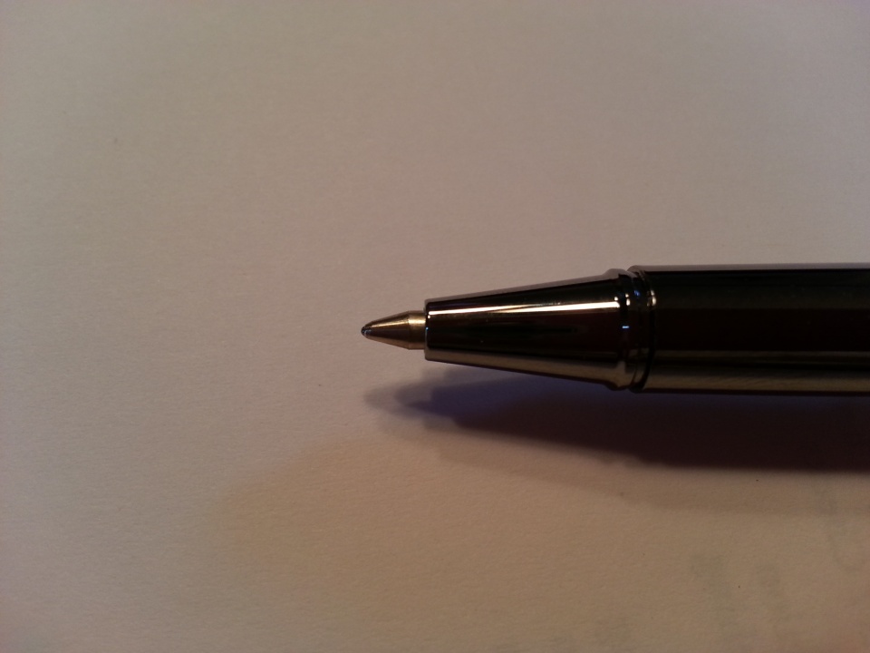

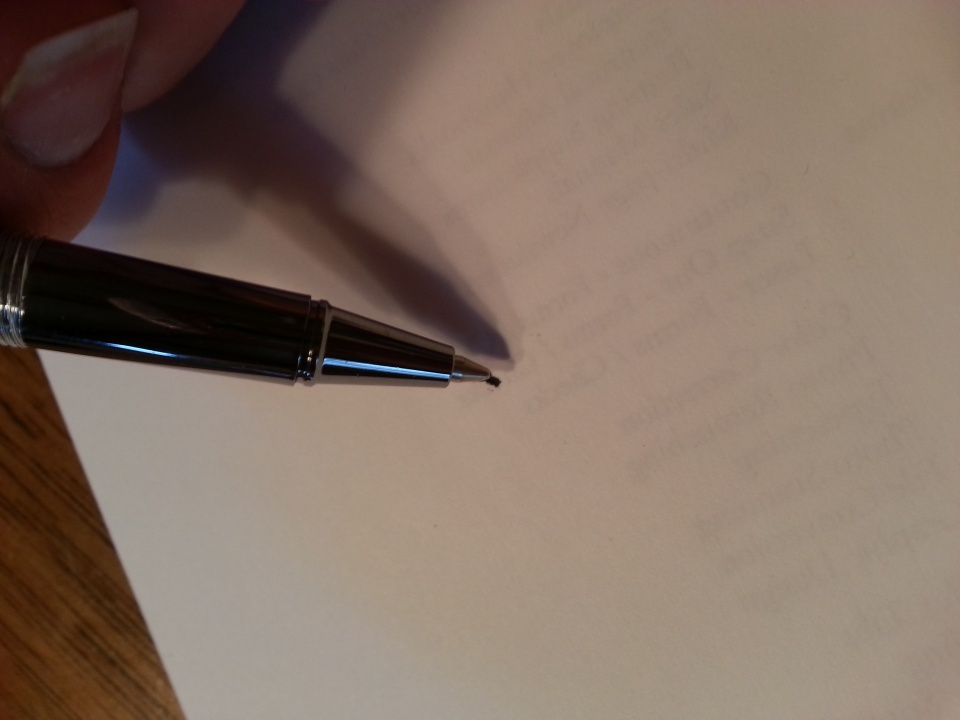

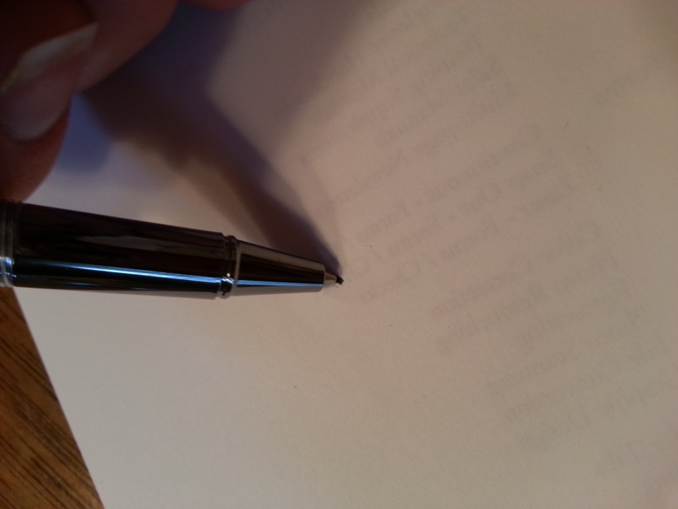

Here are some pics of the pen without the end cap. You can see that the cartridge sticks out of the tube just a tad as it is, apparently, supposed to. The other photos show how much the tip of the cartridge extends and then how much it pushes in when writing.
I guess I'm not a "true penmaker" as I had no idea all rollerballs did this. The guy I made the pen for feels like he needs to "write like a girl" to use it. I may have to fugure out something I can stick in there instead of the spring so that he is satisfied.

Looks correct for pic #1. It shouldn't compress that easily. If you have a second spring, put it in. Otherwise, turn a small plug about 1/8" thick to put in the finial above the spring. If you like the result, glue it in.
