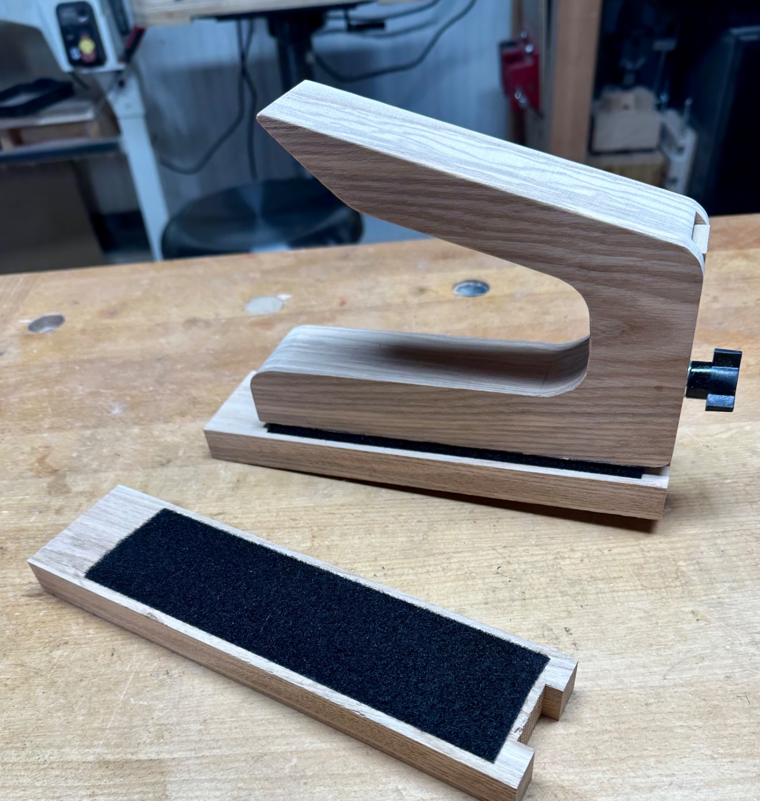

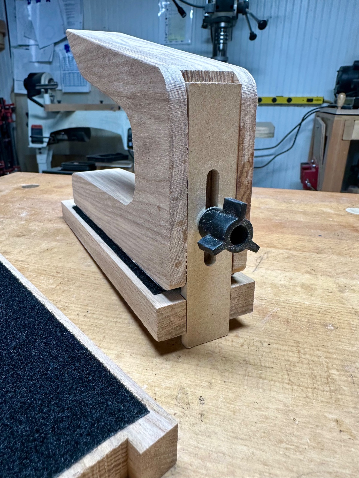

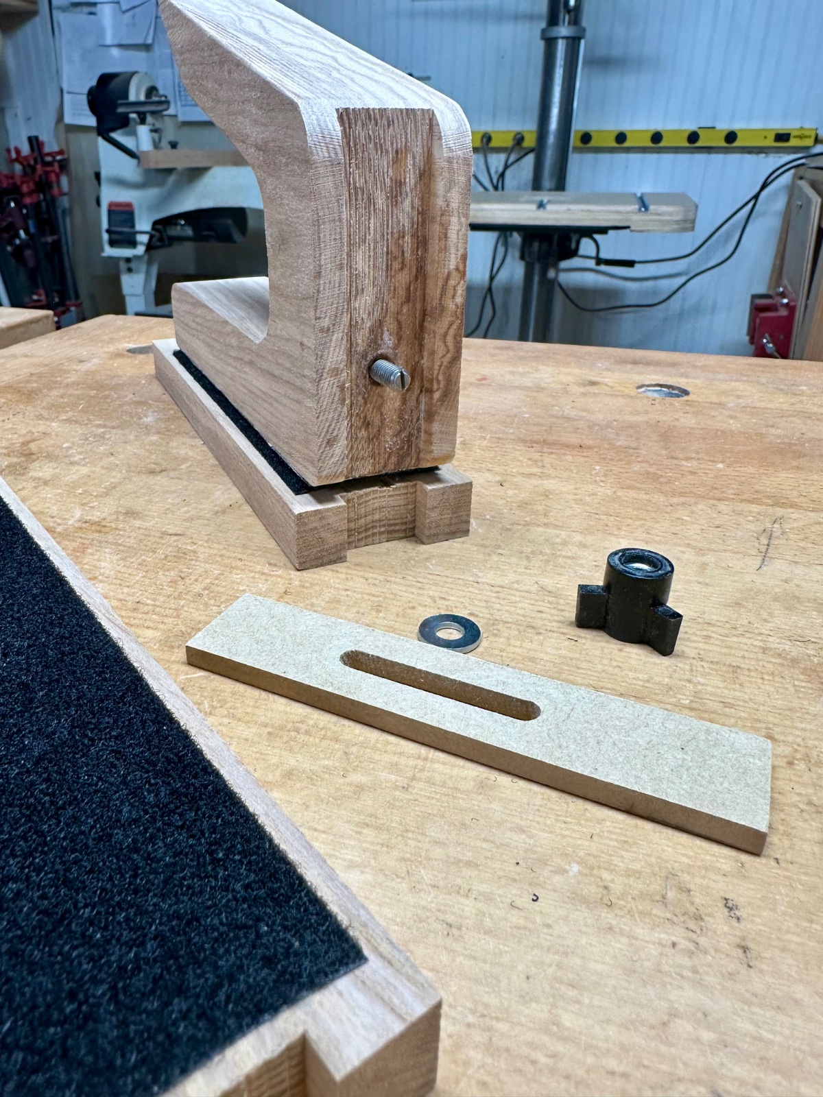

I made a similar looking push stick awhile back but it wasn't real easy replacing the bottom sacrificial piece. I seen a post on another site where they attached the sacrificial bottom with Velcro. I redesigned mine using the Velcro idea. I put a groove in the back for piece of mdf to slide through, fully adjustable for depth and it allows me to just cut it off until it's mostly used up. The mdf can be flipped so I can use both ends. When the bottom piece is in bad shape you just pull it off and attach a new piece. It also allows creating custom sacrificial bottoms, if needed.
