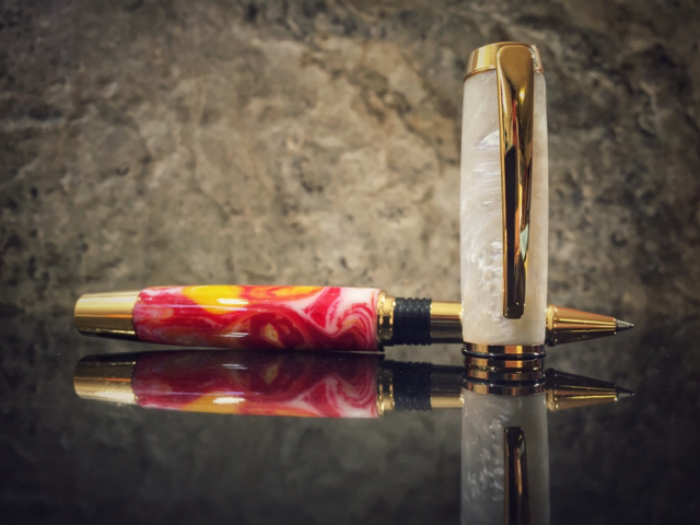

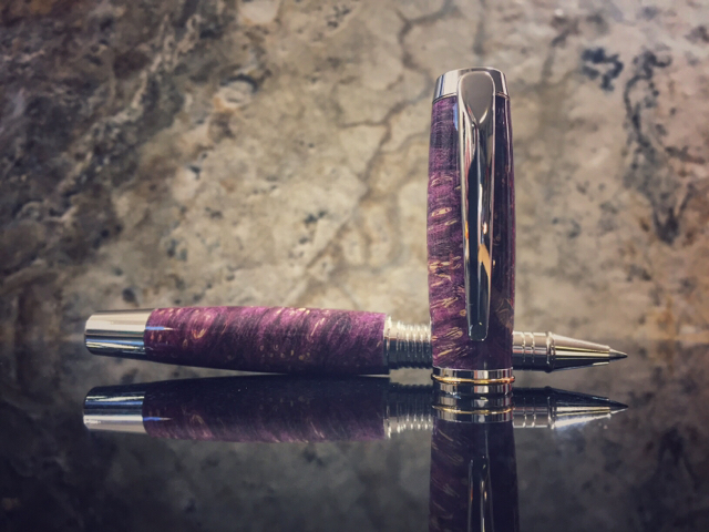

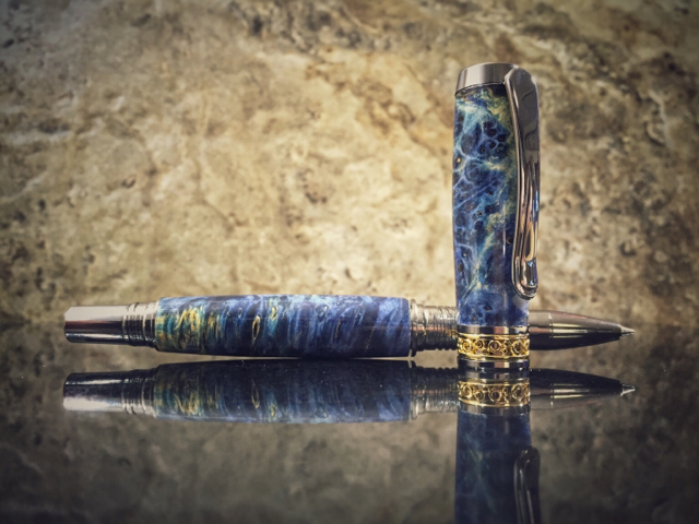

I have one and it works great for what you described. Lots of new features for drilling blanks, etc. I don't think you will be disappointed. Here are some pens I made with it.
