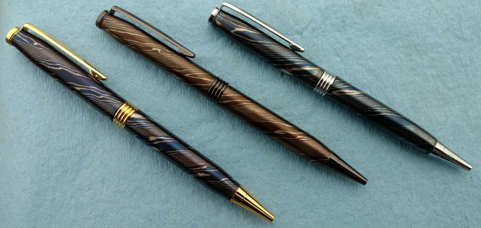

hi all,
here is 3 of my Damascus pens, they are made of 1095 high carbon and n201 nickel (95% pure) they are a 36 layer billet in a twist pattern. I performed a sub critical anneal on them which takes 11 hrs then sanded them to 1200 grit. lastly they are niter blued at different temp's to get the color.
Thank you for the compliment, yes I make my own Damascus. I built a (3) 1" burner forge and use a 125 ton press for the forge welding and a 80 kilo power hammer to draw out the steel

I absolutely LOVE the color on the far left one ... :)
They are all still quite stunning ... just wondering, though, if you could still pull off making them into pens if they are actually heat treated rather than annealed?

Absolutely, just machine first then go to 400grit finish then harden and oil quench. Finally sand to 1200 and temper then color feel free to pm me for more involved answer
Actually, I'm knowledgeable enough on this subject to know what you're talking about in detail already, thanks! :)
It does bring up the subject of durability, though .... the annealed damascus steel is softer, and thus easier to dent or scratch, though the pure nickle is quite a bit more durable... do you see considerable wear over time on these pens since they are in an unhardened state?

I would think it more durable than wood or acrylic in either state.
The blued finish will wear off in time and the carbon steel will rust. Are you planning to clear coat the finish? I use Renaissance Wax for my Damascus knives. I'm not sure how it will hold up to constant handling.

As for the annealed state the Damascus is still Rockwell 45+ way harder than acrylics and the bluing won't fade because I bake on a coating of satin clear gun kote at 350deg for 2hrs. It is a military grade coating

Sorry for the double post but forgot 2things first the nibs and butt caps will ding before the Damascus and second I perform all finish work and oven work before I assemble
Awesome ... I was also planning to ask about how durable the bluing on it is as well, but if it's under a good clearcoat, then that shouldn't be an issue.

Thank you please feel free to ask about the process the more questions I get and answer the better my book will be. It's going to be on turning a Damascus pen

Well, is it the same process as making as what I know of, the old Damascus steel in a layering process of layering steel, then iron, then steel? I know you mentioned other metals in there. Is is pretty much the same process? Is this kind of like folding metals? I hope those don't sound stupid, but, I'm pretty ignorant of the processes involved, so I hope they're not too stupid of questions.

Redbeer, the only stupid question is the one not asked. Yes the process is similar. Where you have steel and iron I use 1084 and n201. I stack the billet, forge weld, cut the new billet and restack. Then rewelded till the desired layer count is reached. Once that is done then I put the pattern in it in my pic's it is just a light twist.

So correct me if I'm wrong, you're layering them, forging them, cutting them, re-layering them, forging them again and then cutting the blank, drilling it, then turning it? There's also a twist in there someplace, I would presume at the end of the forging? Is that kind of the basic gist of it? They're extremely cool. Again, I'm pretty ignorant of it, but this sound like a whole lot of fun for you to be able to do.
Redbeer, it is fun and addicting to come up with different patterns. Your thought process is correct except for one. The twist is done before forging the billet to pen blank size. After forging comes the heat treat regiment then cutting and turning

You are right about nickel being hard to weld. I found if I clean off the mill scale. Soaking the right heat (2445) for an 20 min in an oxy free environment and pre flux with kerosene it welds to itself nicely
