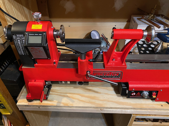

Phil, I have been using the Turncrafter 10" for about 2 years. I like the machine, even though I know it is made elsewhere. You will get alot of opinions on this site, from alot of professionals. For me to choose it had to do with features and financial. I did some research and found the Commander a better choice for me "as a beginning pen turner". In time , I may want to upgrade, but for now I am happy with my purchase. I too was not a beginning woodworker, just new to the Midi-Lathe thing. Enjoy your new hobby!
My wife presented me with a Turncrafter Commander 12" for Christmas. To date I have only turned pens and bottle stoppers. I can say that this lathe is EVERYTHING that I needed or wanted in a high quality precision machine. For the future, I'm sure that when I want to turn small bowls, etc. in the future that I will be pleased with this unit to give excellent results. As stated above.....VARIABLE SPEED should be the "must have" on your list.

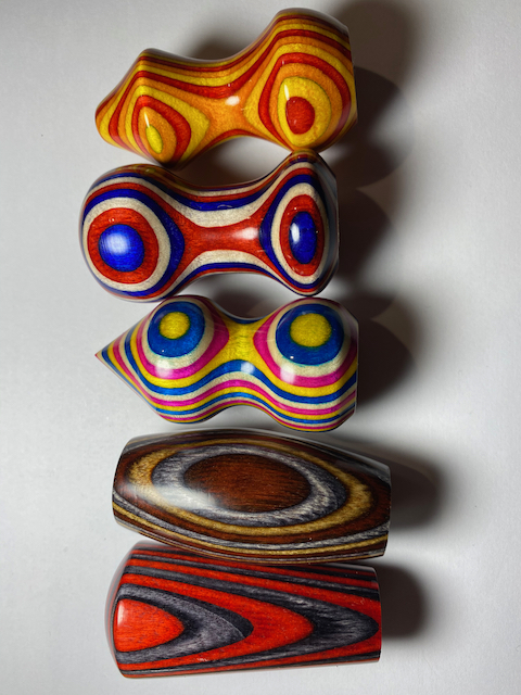

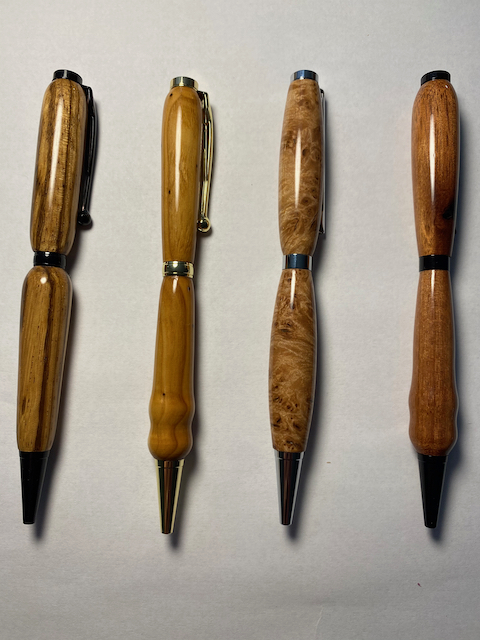

You're comparing two machines:
A. Variable speed, 3/4 Hp motor, that comes with a set of carbide tools and a Jacobs chuck
B. Fixed speed (adjustments by changing belt pulleys), 1/2 Hp motor
To me, the choice is clear: A. More horsepower means that it is easier to drill holes and you are less likely to stall the motor when turning larger diameters. That's a biggie. Most people would consider variable speed a real convenience and a significant differentiator, but in reality, after you gain experience, you will find that you change speeds less often, and the main advantage of variable speed will be to slow down for sanding. Even so, it's really nice to have.
I'm not personally familiar with the Rikon, but I own a Turncrafter (12", 1Hp) and like it very much. It has its quirks, and I suspect that the Rikon does also. You can't know what peculiarities a particular lathe has until you have worked with it for a while, and you either learn to live with them, or else you sell it and buy something else (and deal with a new set of quirks). Turning is often referred to as 'the vortex' because it pulls you in deeper, and most people outgrow their first lathe (and also the second, and perhaps the third - - -); I suspect that point would come sooner with the Rikon than it would with the Turncrafter because the larger horsepower and variable speed make it possible to do more.
Having a Jacobs chuck is convenient, and you likely will want one sooner rather than later. I don't know which chuck PSI is offering as part of the package, but my advice would be to skip the 3/8" version and get the 1/2" chuck. Be aware that personal safety is a major consideration whenever you are using a lathe. There is a choice between keyed and keyless chucks - a keyless chuck is theoretically safer because you can inadvertently leave the key in a keyed chuck, and when you start the lathe, it will be ejected, possibly into your face. So always wear a face mask. (And to be totally correct, a keyed chuck is a 'Jacobs chuck', while a keyless chuck has a different name that I don't remember.)
When I bought my first lathe (the 1/3 Hp machine) it came with three tools - a skew, a parting tool, and a spindle gouge. I'm still using them but have expanded my arsenal quite a bit over the years. All part of the vortex. I do have some carbide tools, but I find that I prefer conventional tools and don't use carbide all that often. That's purely a matter of personal choice. But obviously getting them as part of the package would help you get started.
