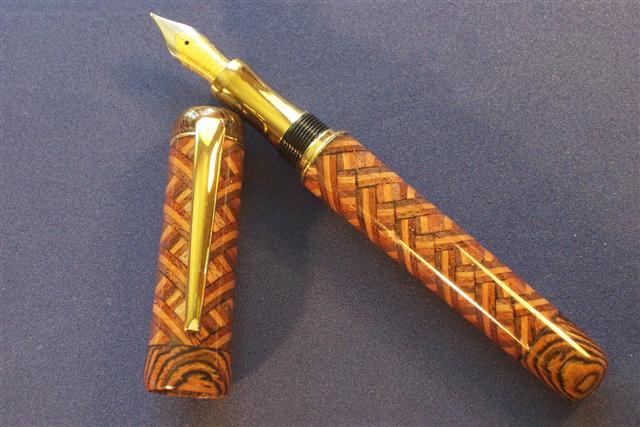

Let me add a comment or two.I believe most of the replies you have gotten are all good ones but no one has mentioned much about the gentlemens pen itself.
I have only turned one and to look at it you may not realize it is basically a Gentlements pen
<br />
The customer selected this style of kit because of the richness and simplicity in the nib holder.Like myself she thought the other high end kits gaudy looking.Since the pen was to be modified, I want what little of the original components that remained visible to have a quality plating .
That being said.
If you selected that particular kit based on its' tasteful appearance did you realize it is 3/4's of an inch in diameter at the center band?It is a VERY LARGE pen.Some prefer larger pens some don't.I just thought I would bring this to your attention because it was selected with a special recipient in mind.
As previously stated the Gent is pretty straight forward and not difficult to turn/assemble.
AS far as a finish is concerned I would opt for a lacquer rather than a CA finish.It is more forgiving if you mess up, multiple coats show the grain better than the topical shine/gloss of a CA finish.
If you haven't done so already take a look at Russ Fairfields site making a wooden pen.Russ explains the pros and con of most of the finishes and reading every word he has to say on pens from start to finish is time well spent.
CA is a great finish but I wish I had discovered lacquer when I first started making pens, my first pens were finished with CA and as I look back on them lacquer finish is far easier and is a better way to show of a spectacular piece of wood.
