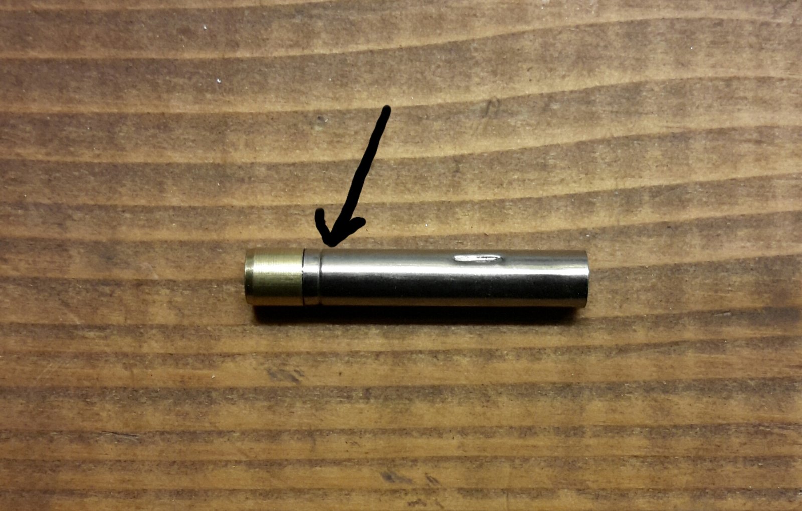

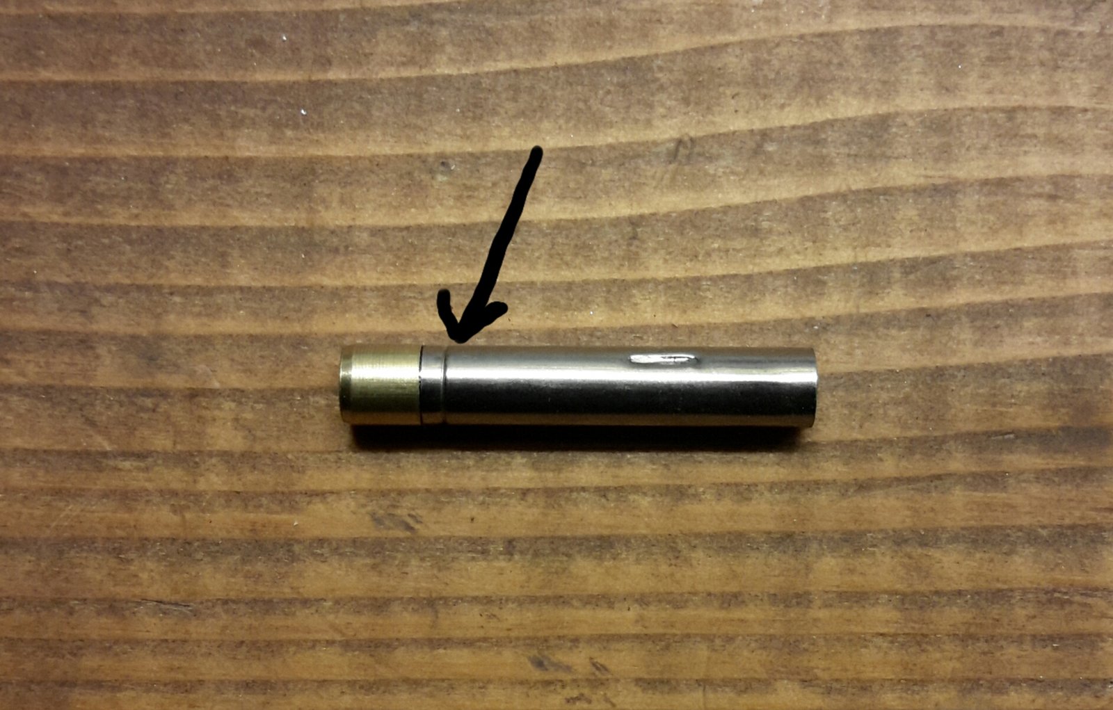

When I put my transmission barrel in, it usually winds up at the line where my arrow is pointing. I usually always press in to about the end of the brass, insert my refill, and twist to see where the tip ends up. Then press in to my desired length. If your blank might be a little too short, just press the transmission in a little at a time until you get the tip to come out at your desired length.
