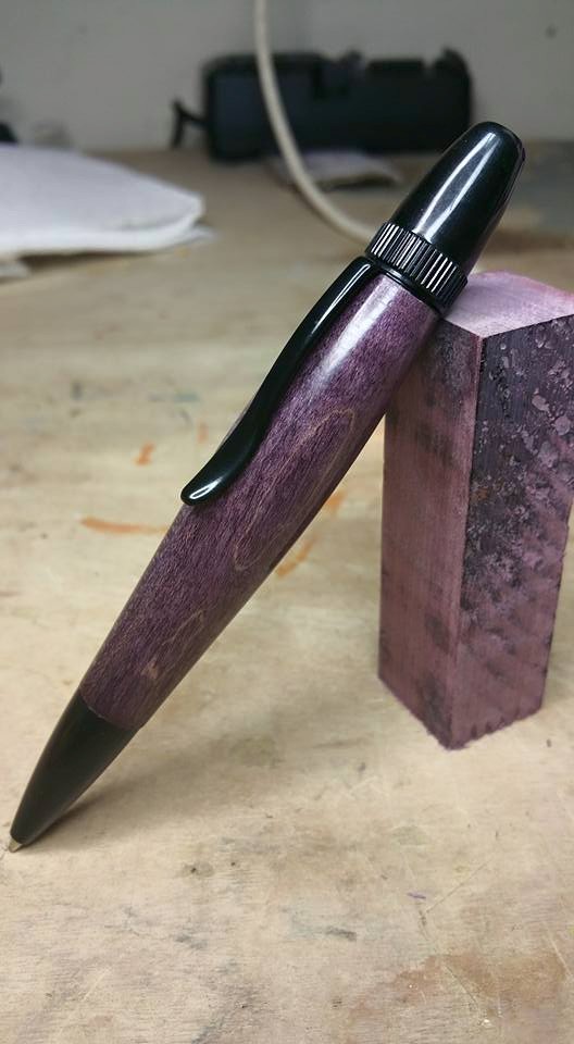

Just as a follow-up, and in case anyone is interested, I thought I'd share the finishing method I am using now that I like. Another user on the forums suggested it, and I added a bit to it. It seems to be going well.
I sand the blank from 220 to 400 grit. Then I apply a layer of thin CA glue and almost immediately rub it down with a paper towel. I wait a bit for that to dry. I think this helps fill in some of the low areas, maybe, but I don't know. Then I do five coats of medium CA glue each followed by two sprays of activator. I let each coat of medium CA dry for a couple of minutes before proceeding. After the fifth coat I wet sand with Micro Mesh pads, wiping the blank with a paper towel in between each pad. Finally I finish with a tad of Renaissance Wax that I buff out with a paper towel.
For now this seems to be giving me that glassy finish that also stands up to handling. I haven't let my boys try it yet. When I do, I will certainly supervise them. They've used CA previously wearing latex gloves, protective glasses and face masks.
I've attached a photo of a pen I made last night for my daughter using this finish method. I took the picture with my phone, so it's not the best.
