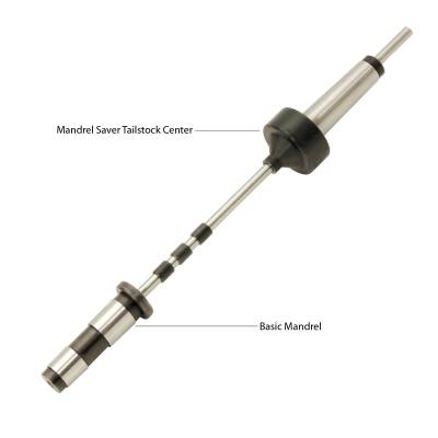

So I went to Exotic Blanks site and started reading about the Sierra pen. It mentioned 20A bushings, 27/64th drill bit and a "Mandrel shaft A". What is that? I have this one on order...will it work with 20A bushings?
#2 MT Pen Mandrel Saver Package
#PKMS2SET | In stock, Ready to ship!
Read 169 Reviews | 49 Questions, 248 Answers or Write a Review
QTY:
Add to Cart Add to Wishlist
Product Instructions Video Instructions View in Catalog
Product Description
Complete package includes a Dedicated Mandrel. This set includes a 7mm drill bit, 5 Slimline Bushings (#PKM-BUSH3), the Mandrel Saver Tailstock Center PLUS a basic mandrel (no threads or knurled nut) that works great with your Mandrel Saver. Here's a complete mandrel system for just a bit more than the cost of a new mandrel.
Are you tired of bending your Mandrel and ruining the point on your live center? If so, then this fail-safe live center accessory is for you. Mandrels usually bend when you tighten the tailstock center point into the end indentation of your mandrel. This system solves that problem because your mandrel shaft goes through the hollow live center. Your bushings press against the center with zero pressure on the mandrel shaft. The tube and bushing assembly tightens up by turning your tailstock quill adjustment wheel.
Other features:
  • No need for extra spacer bushing as the system adapts to the length of your project
  • No need for the knurled nut that sometimes gets lost, misplaced or stripped.
  • Adapts to nearly every mandrel on the market with a shaft diameter of .245" or smaller.
Yes. that mandrel will work. Pretty much all standard bushings are made to slide on to that size mandrel.
FYI: The Penn State equivalent of the Sierra is the Gatsby.

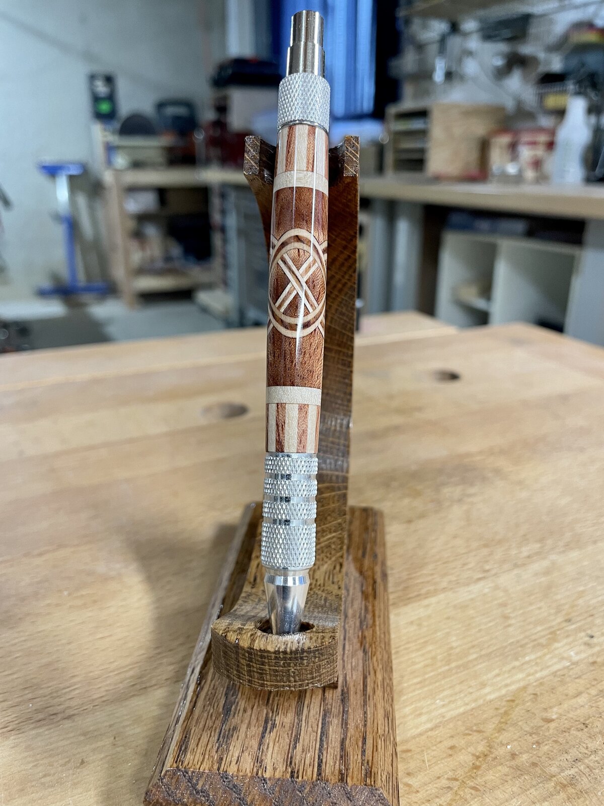

Good plan. I cut most of my own pen blanks , buying very few. I focus mainly on segmenting and just getting into stabilizing.

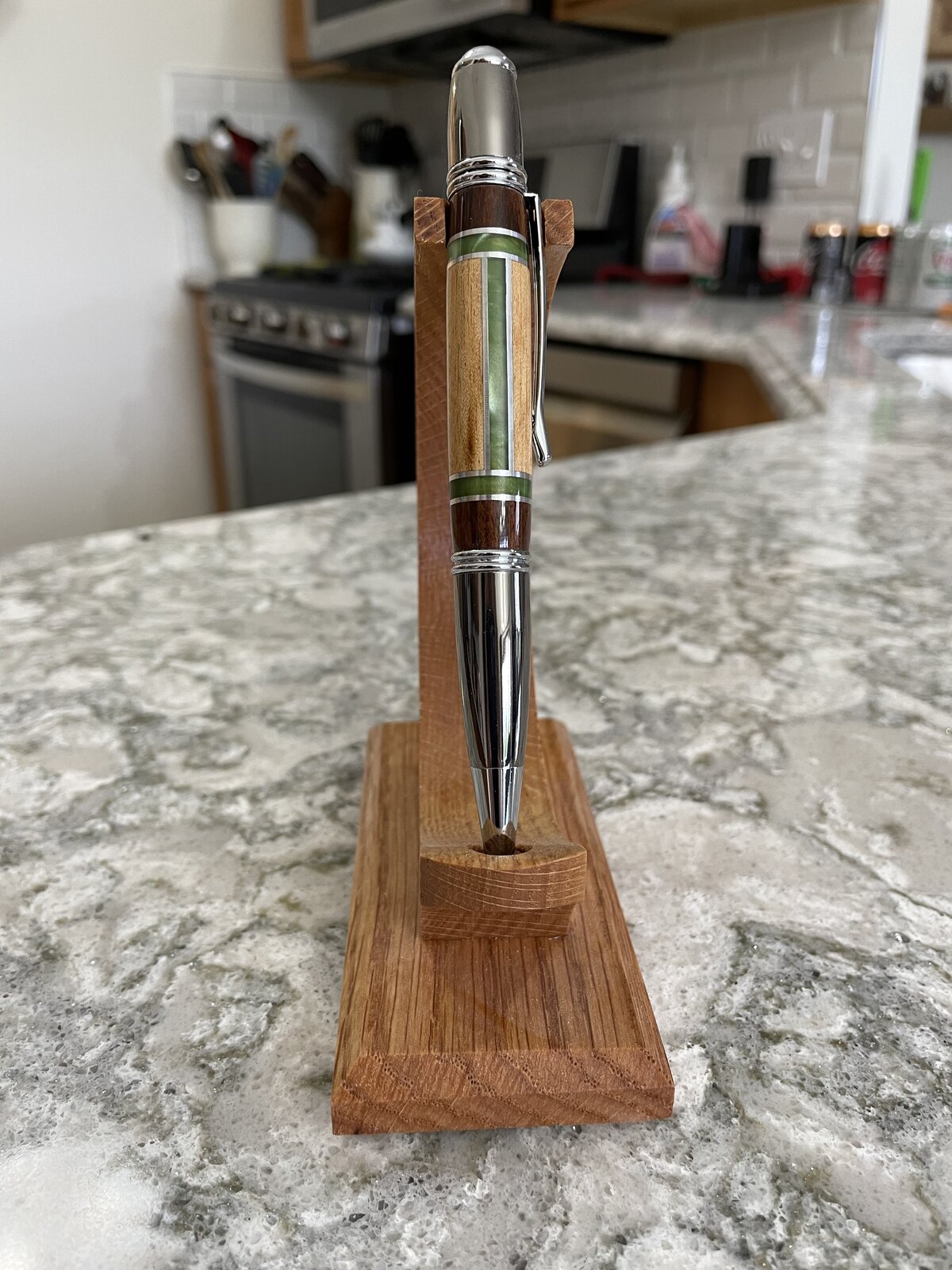

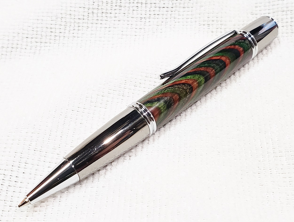

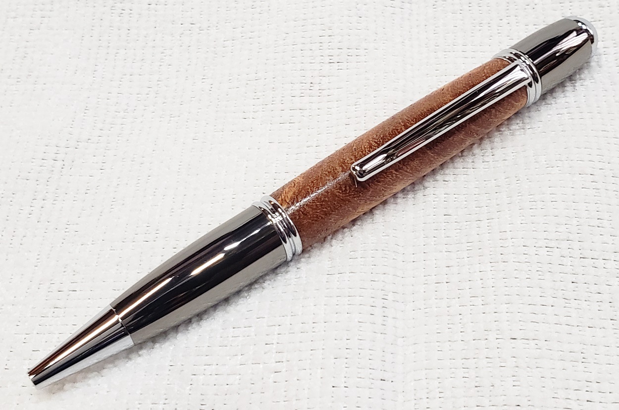

Hi,
I started out years ago on the slimline...If you take your time and use a caliper you will do fine...The Slimline is cheap and they will be good practice for you...JMHO...Thank you for your service...

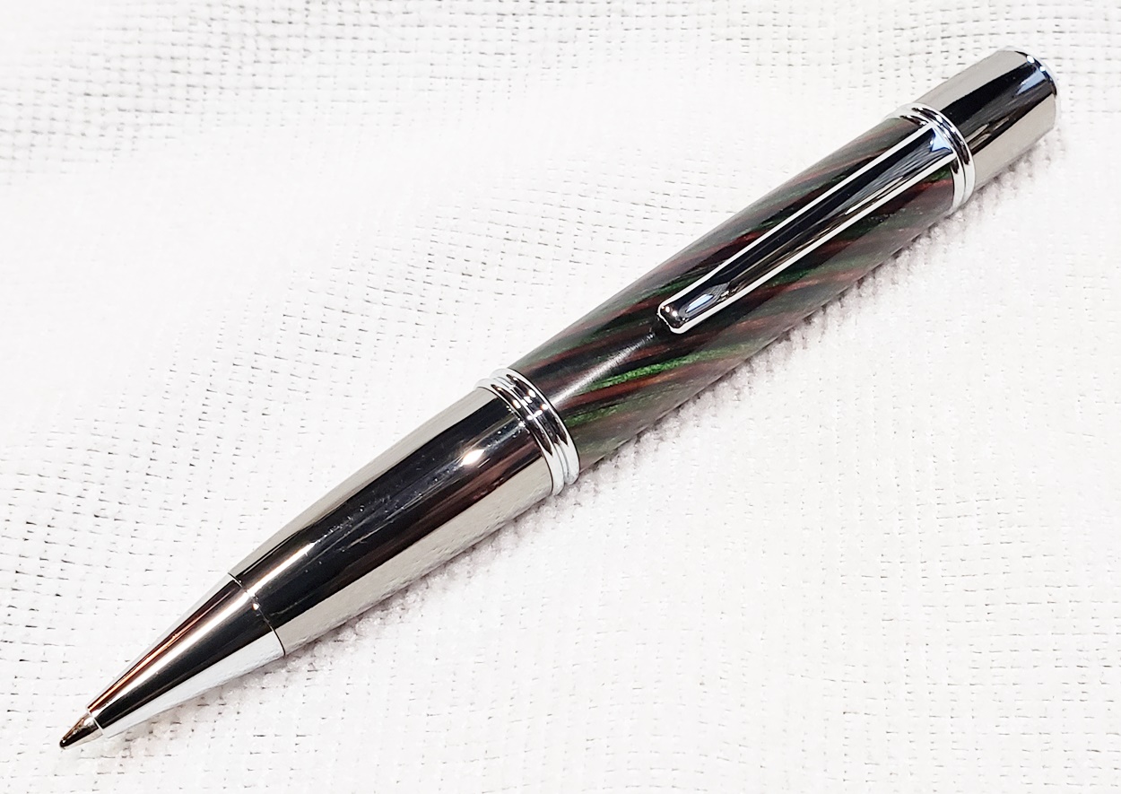

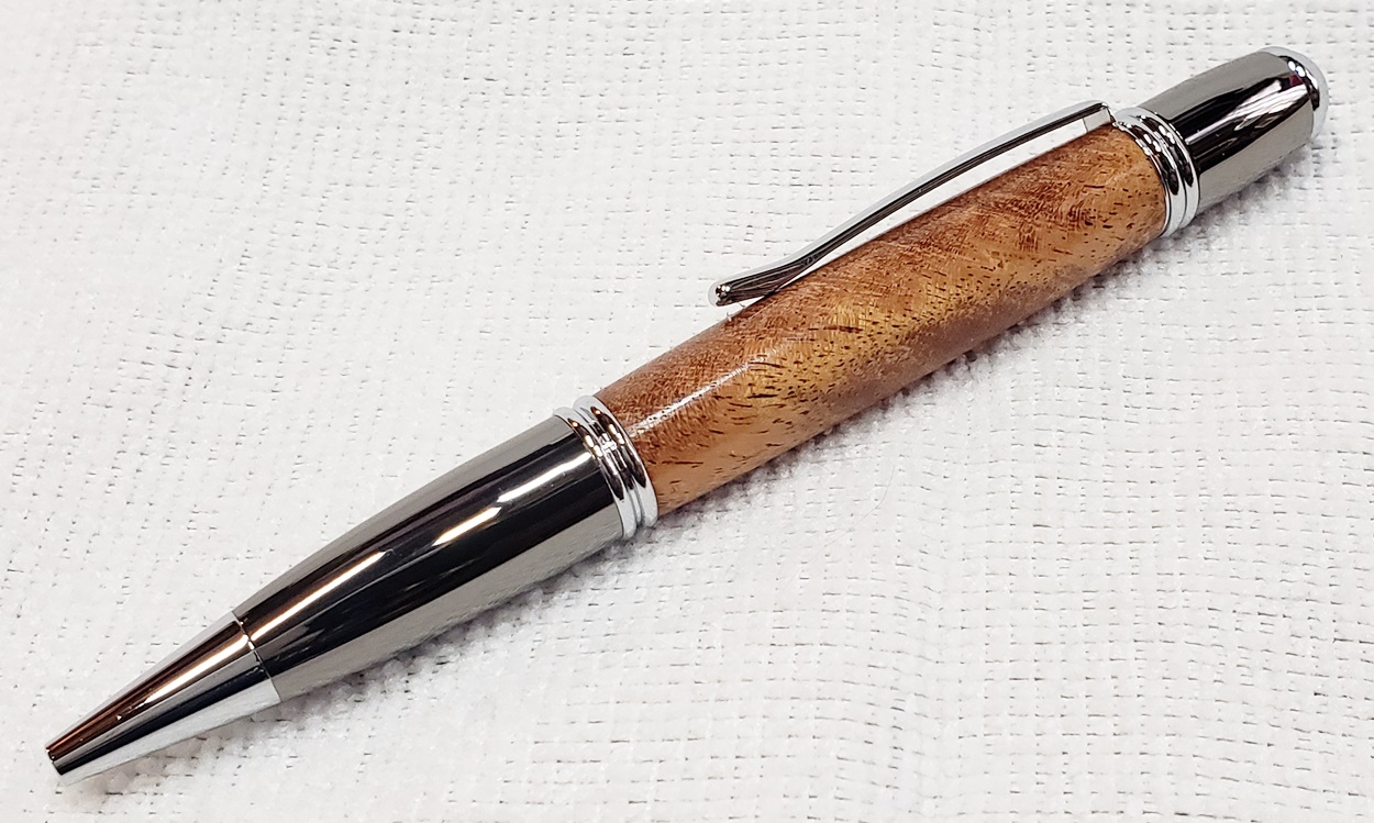

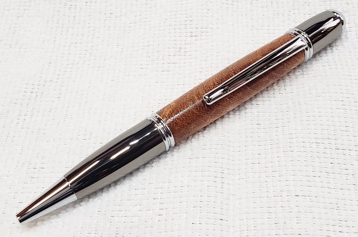

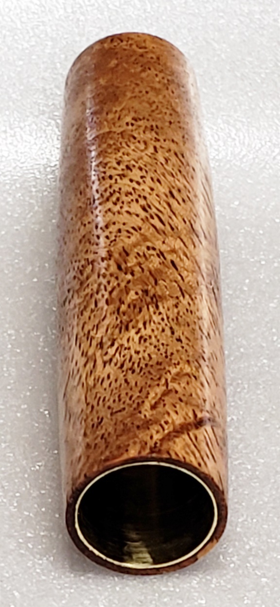

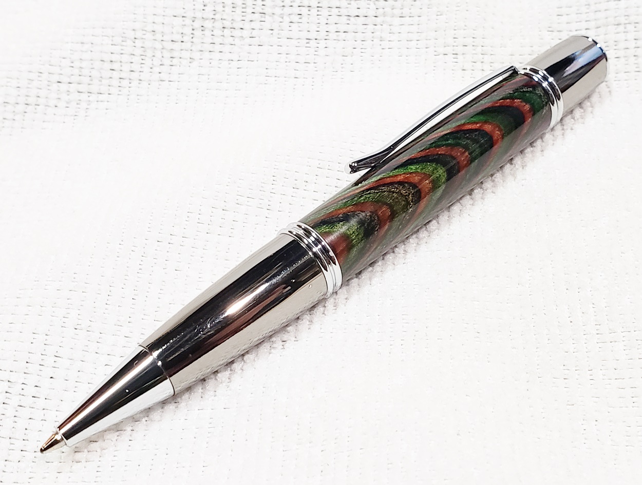

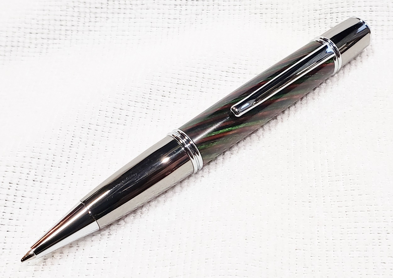

I recommend the PSI Gatsby for a first pen, over the Sierra style. Simply because of the "beads". They make the pen more forgiving for the final diameters of the ends of the body. There is also the Gatsby Grande. Similar pen, but larger body with a smaller hole. The Grande takes a 3/8" drill bit, while the regular Gatsby takes a 27/64". Leaves the material a little thicker. Just make sure you get the proper bushings. And I also recommend wood over acrylic at first.
The first three photos are of a Gatsby, the second three are of a Gatsby Grande.

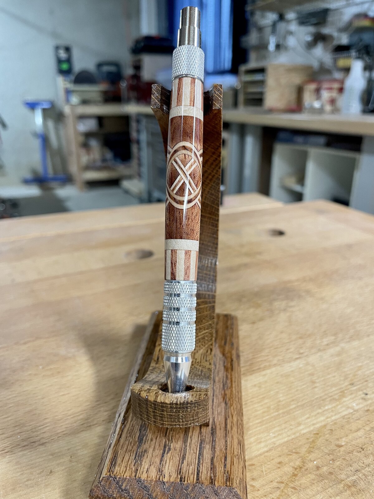

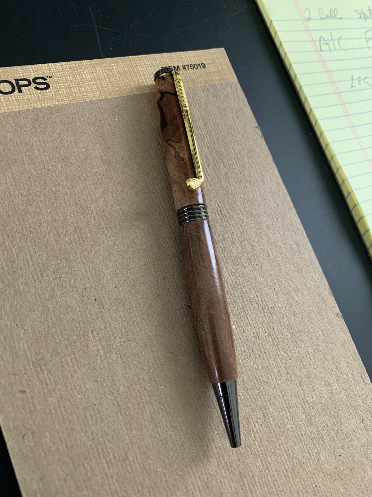

I am pretty new myself (few weeks) and I started with Slimline. I soon got bored with the standard slimline and went to slimline with no central band. That might sound complicated for you but it is actually easier than the standard slimline because you have flexibility about the thickness of the middle. It is simple to replace the center ring with a piece of contrasting wood typically fastened to the lower pen body before turning. Having said that I can see why people suggest Sierra under it's various names and I now turn both types. Haven't yet progressed to the bigger pens and in no hurry. I have too many ideas for for pen blanks to worry about that. Segmented turning appeals to me and I have done some but nothing like some here which are amazing. Not sure I will ever be that good! Good luck with the "journey" that you are about to embark on. The people here are great and always willing to help.
I did not read all of the posts. Use good quality sharp tools and keep them sharp. That is a separate subject.

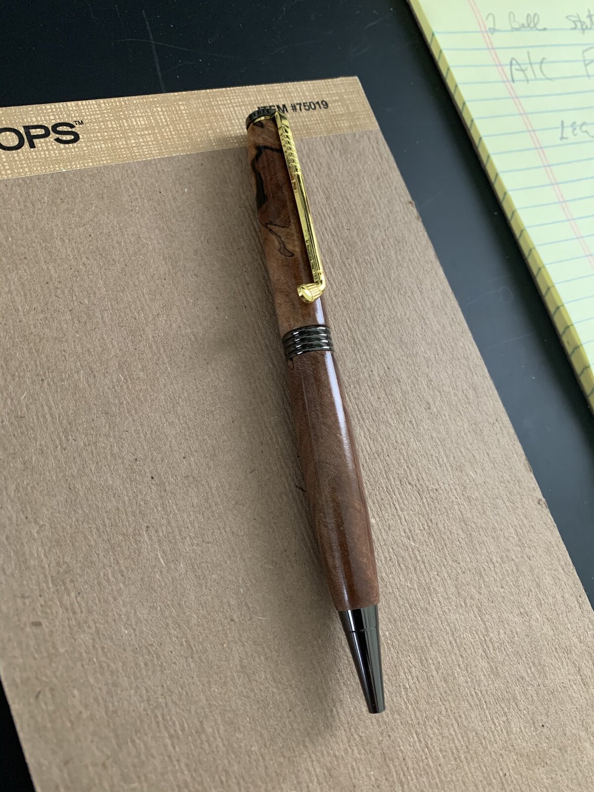

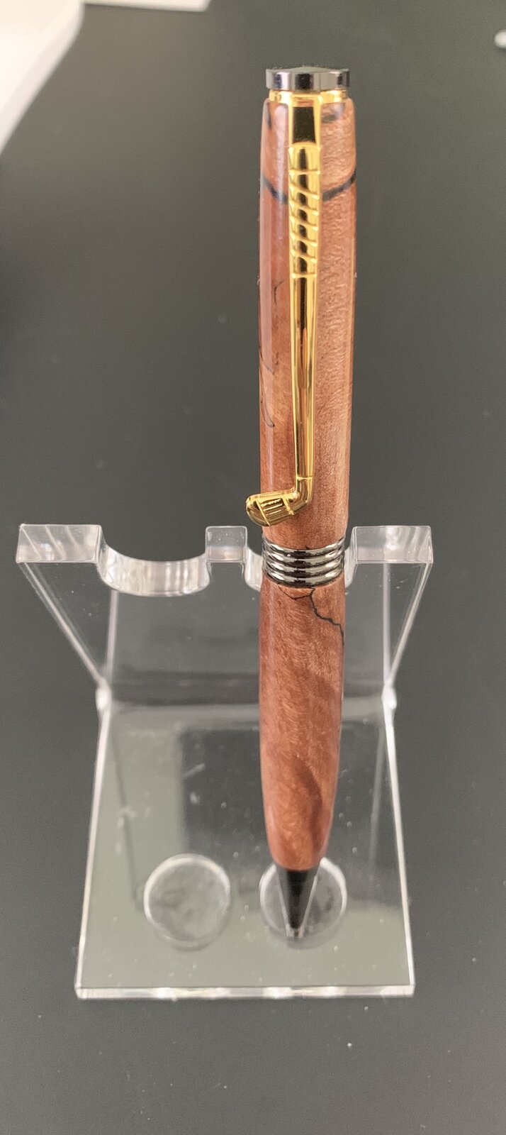

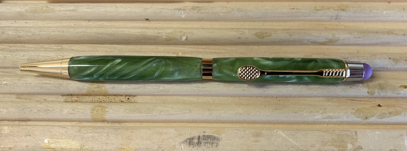

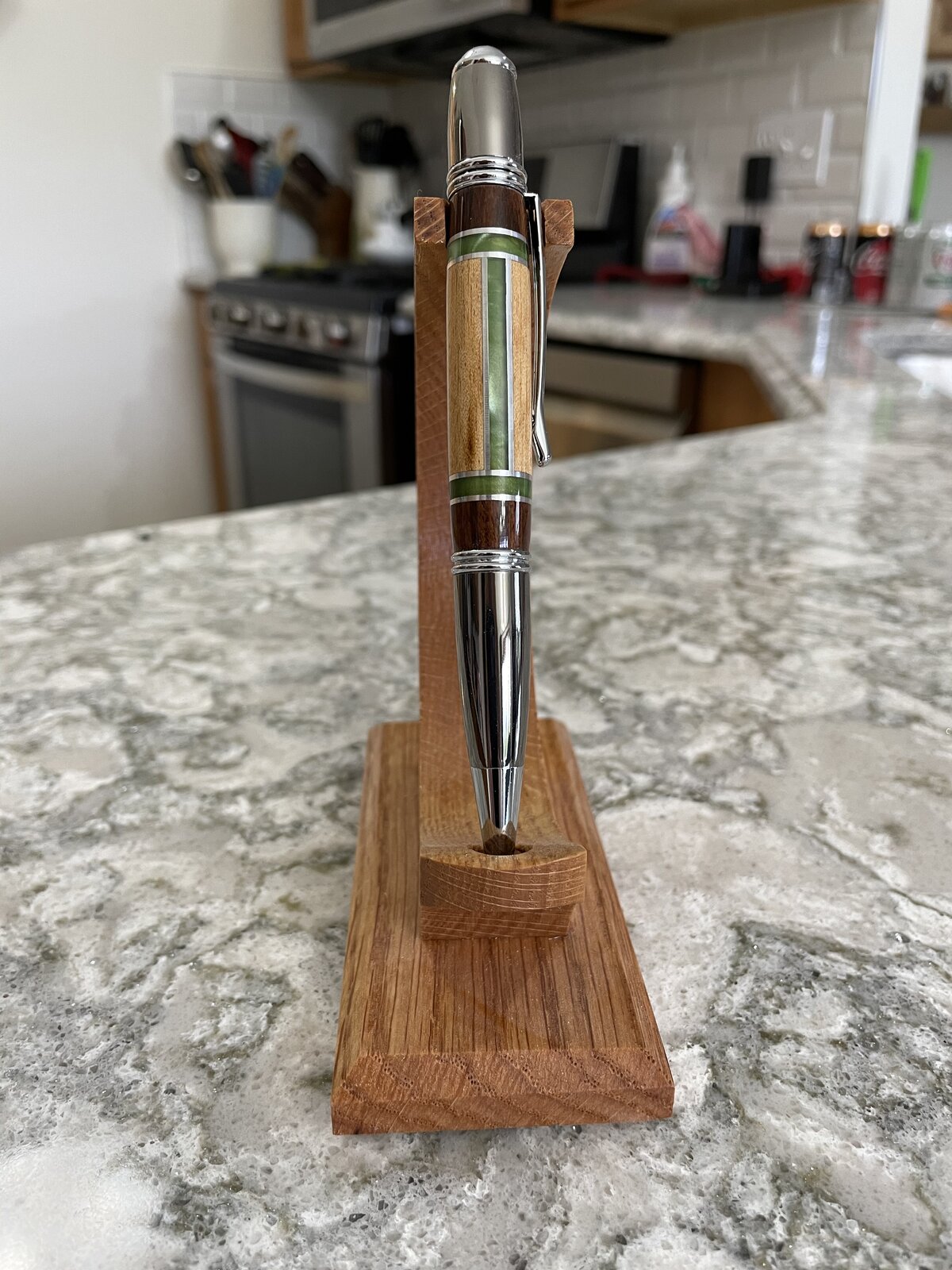

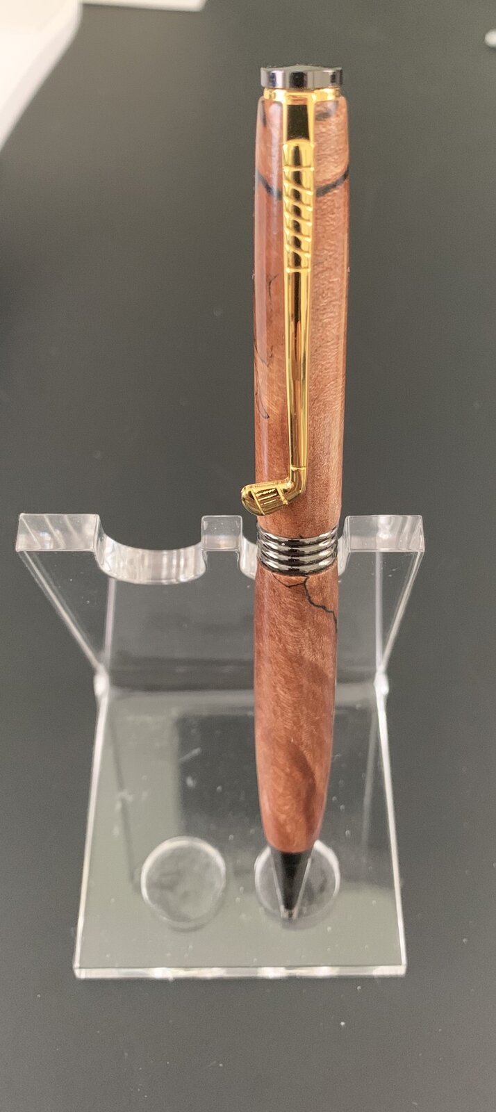

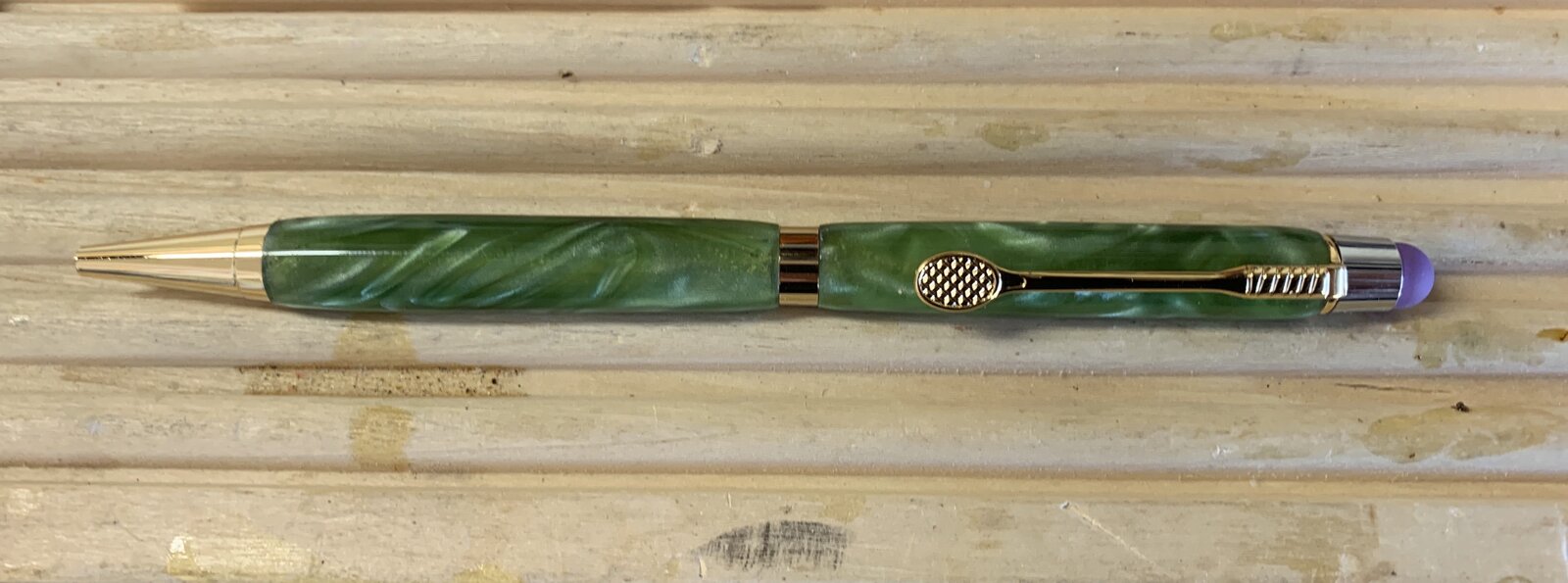

SLIMLINES…. Once I got the hang of inserting the twist to the proper position the fun began. Comfort pens are great with or without the grip.
Those look awesome! I'm going with Benjamin's Best carbide tools from the start. I can move an insert to the next position a heck of a lot easier/better than I can sharpen a standard tool.
