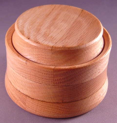

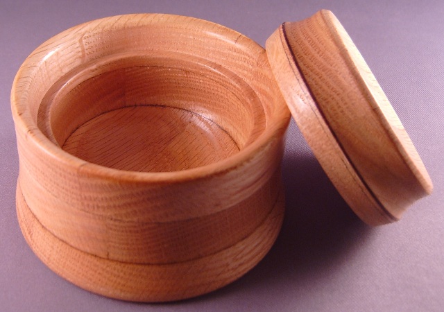

As I understand it, the term New Yakee has to with repurposing things. The material in this box was and Oak headboard that someone was throwing away. Well, I don't let wood get thrown away. It makes LOML crazy, but after I used free recycled wood to make our night stands she no longer complains. So I took a 4" wide stretcher form the headboard and cut 4" squares. Glued three pieces together for the box and 2 for the lid. I sanded most of the stain off first, but left a bit for contrast. The lid blew up on me once, I forgot how unforgiving Oak was when turning end grain. Anyway, I made this for a friends daughter for her birthday today.

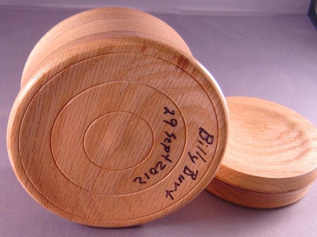

Looks good Billy. Did you go with a suction fit or a loose fit? Seems like I can't make up my mind which type of lid fit I like better for my boxes. How come you didn't include the type of wood with your signature on the bottom?

The side of the lid is angled, but it will actually suction if she closes it enough. I make some of each type. It just depends on the vision of the box I have in my mind. I also switch up having the tenon on the box vs the lid. As for why I didn't include the wood type, I just didn't think of it.
