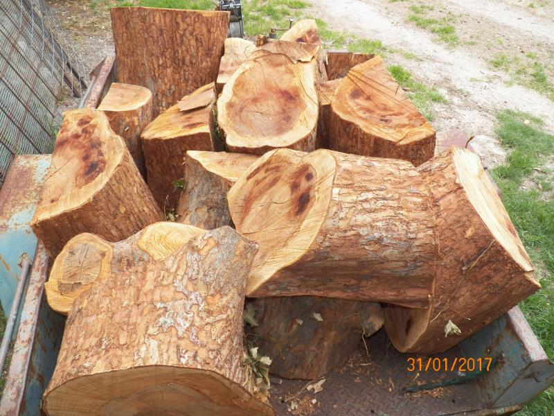

We considered a couple of options and it was decided that was better for me to take the trailer as it was back to my place, and after some rest, I could download what was for me and clean up some of the bigger logs that I cut that way so that Stuart could have 20"+ blanks to turn as soon as he buys a bigger lathe, at the moment he can only do 12" however, they needed to be cut round and take the bottom round part and make it flat like in a slab that way, it would be a lot lighter to handle so that when he come over this next Sunday, he can put them in the car and take them back to his place.
I didn't touch the trailer on Monday and today Tuesday, the weather was cool so I went down and started to take some of the logs out of the trailer and clean any of the big pieces for Stuart large bowl turning, one day. Done a couple of hours late afternoon and was enough for me, I still have a few days before next Sunday so, I will clean a few logs each day and as I can...!
I forgot to take any pics last Sunday when we went to cut that trunk and get all the wood out of there, Stuart has taken a few pics of that tree while the tree guys were working on it and some pics from some of the logs piles in the yard so, I'm waiting for him to send me some of those pics so that I can show you guys, in the meantime, I can show you a couple of pics I took off my trailer today, before I started taking any wood out, I will have a few more pics of what I'm doing to the logs that I brought home and some pics of some pen blanks I cut from a few off-cuts from the first trip to Stuart's place, I slice them up about 1" or more and put them in the oven that night (Saturday night) they were there until this morning (Tuesday) they were dry, reading about 6 % MC on one of my moisture meters that reads 50% as green/wet wood so, that is very dry, so much so that it seems this wood doesn't like to be dried that fast, it turned out as hard as rock and many "sticks" shrunk well bellow the 20mm and most of them were 25 to 28mm before they went to the oven...!:eek:

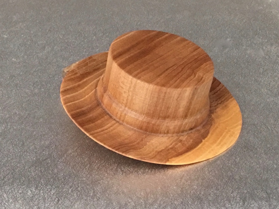

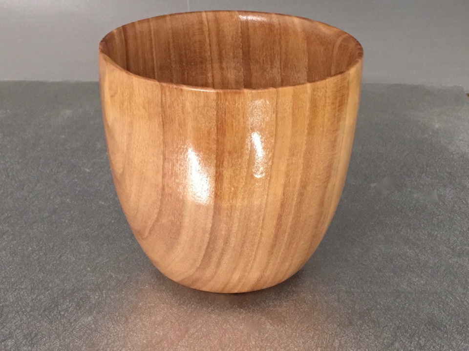

George, a woodworker friend of mine gave me what he called "Japanese Elm" several years ago. I made a cup (approximately 5" high) and a miniature cowboy hat (about 4 1/2" diameter). Even using very sharp tools, I found it to be a little brittle to work with, but it did turn nicely and finish well.
Again, I'm going by what he told me it was. Hope this helps. Would love to see some of your woodworking using that wood.

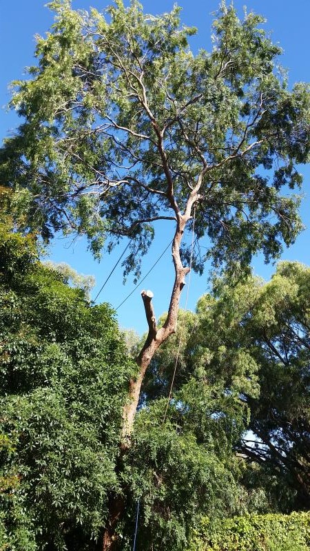

Hi,

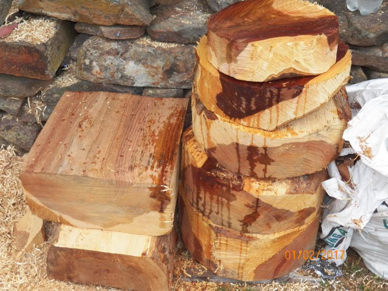

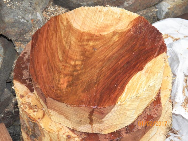

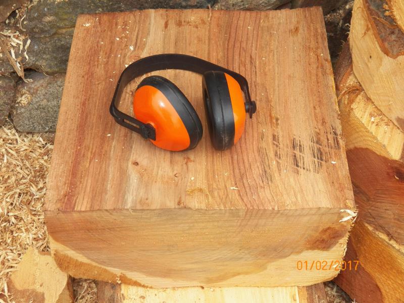

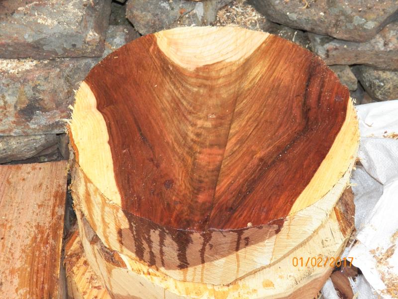

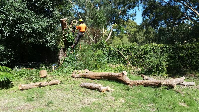

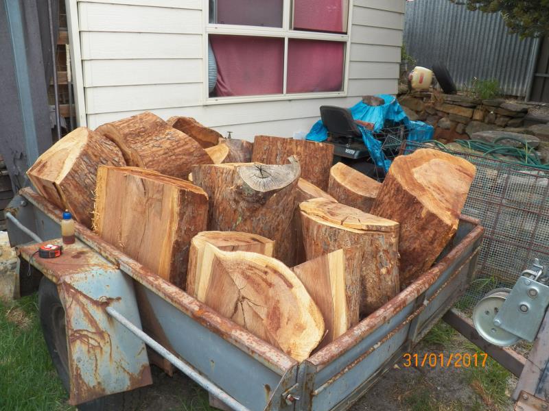

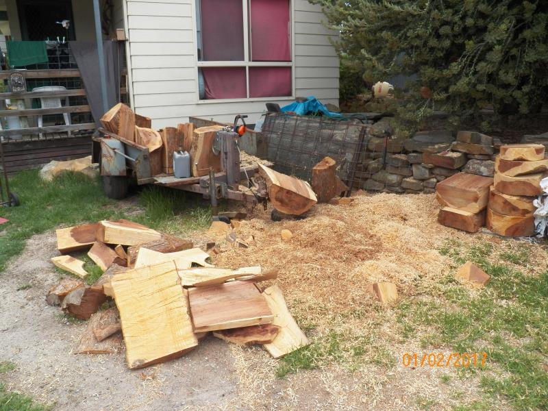

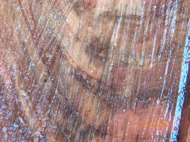

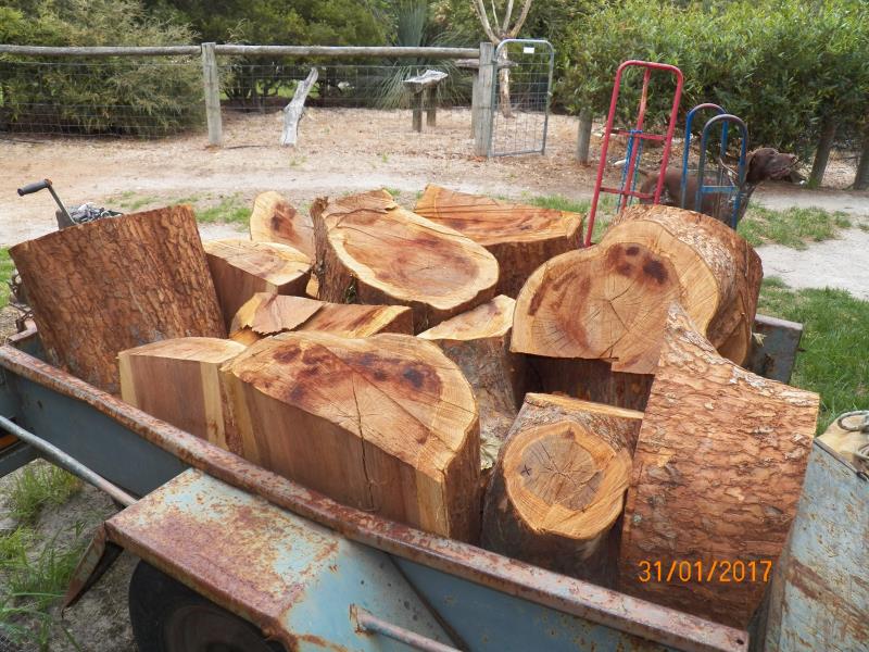

A few more pics, some from the tree as the tree company was working on it and some of the wood I brought home in my trailer, cleaned/processed for Stuart to take, the rest I will clean for myself...!
There were some nice crotch pieces unfortunately the pith was not at the centre and the thinner half had a big deep crack through the middle so, I got one good blank out of each log and the other halves were cut for me to process later.
I'm sure Stuart will enjoy working on these blanks...!:biggrin:

They look beautiful!
You wrote that Stuart is new to turning -- please remind him that it's important to orient that blank correctly to avoid all that feather ending up as shavings underneath the lathe.
The rim of the bowl must be on the "bark side" of the blank, as if you're turning a natural-edge bowl. The opposite way (which is more normal for bowls that aren't natural-edge) will be disappointing.
It results in a shallower bowl, but far more of the figure remains in the bowl that way round. Don't ask me how I know ... :crying:
