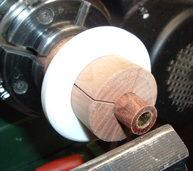

Looks like I don't need to sharpen my pen mill or get a new one after all. :biggrin:
I had been messing around with these wooded chuck adapters and it turns out to be a great way to trim the ends. It just takes some time to set up but it works good. I checked all 4 ends by running the pen mill against them by hand and they are all good to go. :smile: The ultimate test will be when I get this pen finished and check. You know how you can hold it up to the light and look for a gap between the hardware and wood? Then I'll know.
I have several sizes made and I have been turning the blanks round prior to any cutting. What it does do is adds time to the whole process. However, I think I'm done trying to make a pen fast. I have dozens of those. Besides, it is the process that is fun and the result that is satisfying. And, I just cannot seem to stop so if they take longer now then so be it.
If more details are needed, just ask.

Joe. Do you check the end in any way other then by sight?
I used a small machinist square and held the blade to the end. Looking at it through my lighted 4x magnifier, it seemed to be straight across. I'm thinking that is a good test.

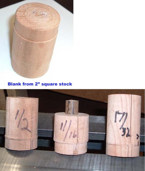

Flint. I attached another image that shows one of the blanks that I turned from a long piece of 2" x 2". Not sure what kind of wood it is.
Anyway, I cut a tennon to fit the jaws of my scroll chuck. I then mount it in the scroll chuck and mark where all 4 of the jaws go and mark #4 so I can position it exactly the same each time. I also mark the 4 places for cutting on the band saw.
Then, depending on the size needed, I drill the center hole. On the 1/2", I can go just a little each way from that size but not much. I have more wood so I can make more sizes. You can see I have 3 other ones.
The one in the chuck that I pictured at the beginning of this thread is the only one that I made a collar for. When I saw the videos mentioned, I wanted to do the same thing with a ring to tighten the chuck. I was using a worm drive clamp. I found that it put more pressure on the tangs where the drive mechanism was so I needed a more even and consistent method. What I did was sacrificed an old plastic cutting board. Marked a 3" circle and cut that out on the bandsaw. Then put that in the scroll chuck wuth a backing board the same size and cut out the center to fit the wood chuck. Oh yea, I also tapered the wood chuck about 1/8" from the end toward the scroll chuck. This way the ring tightens as I tap it toward the opening and gives a good tight consistant fit.
